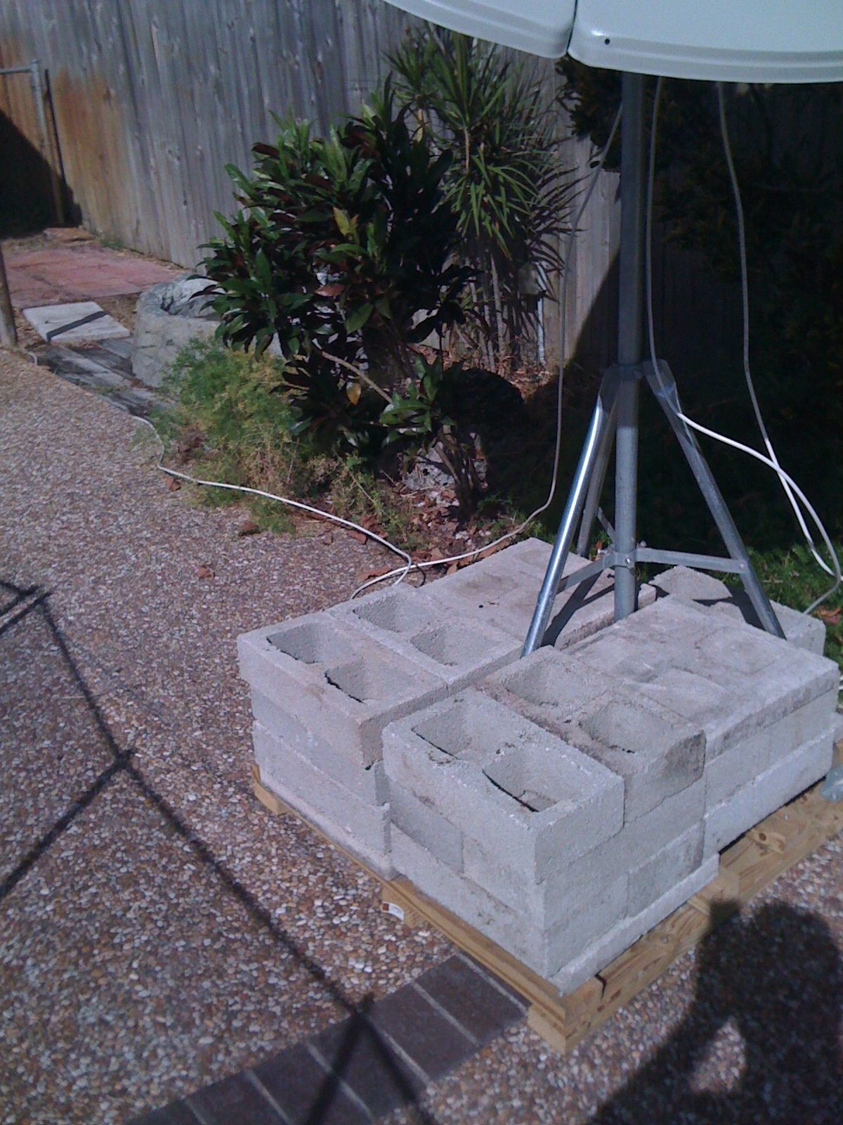

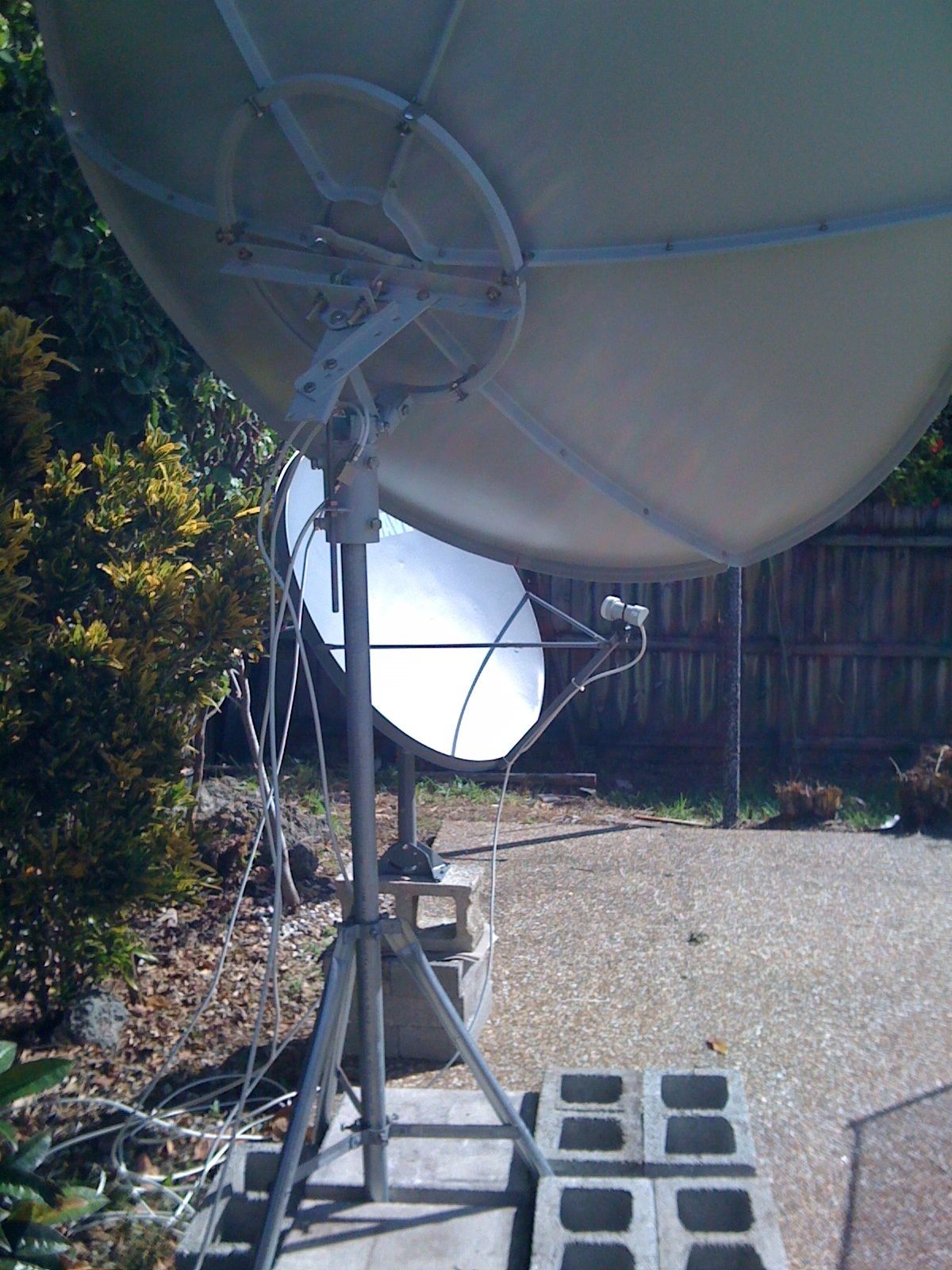

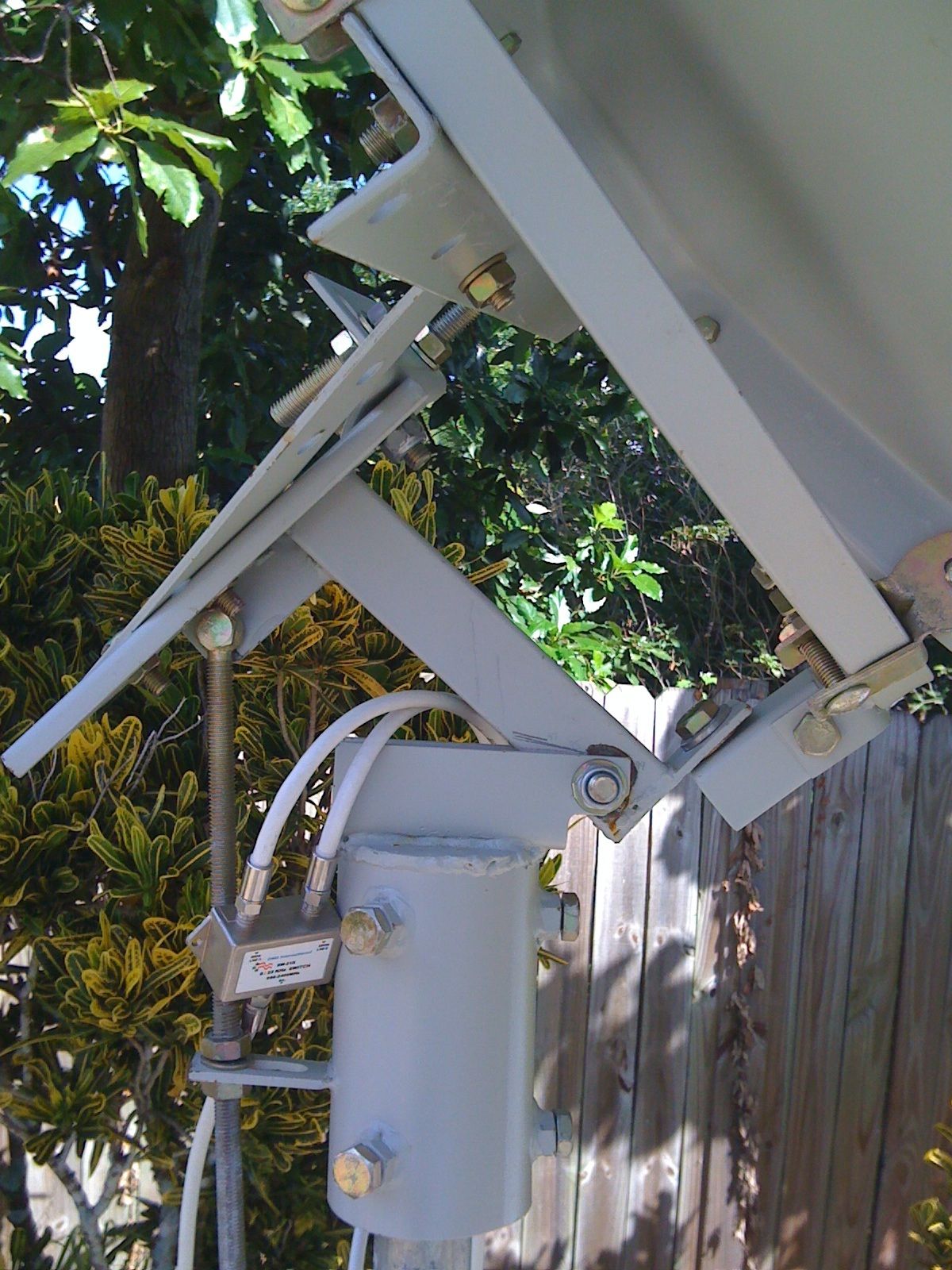

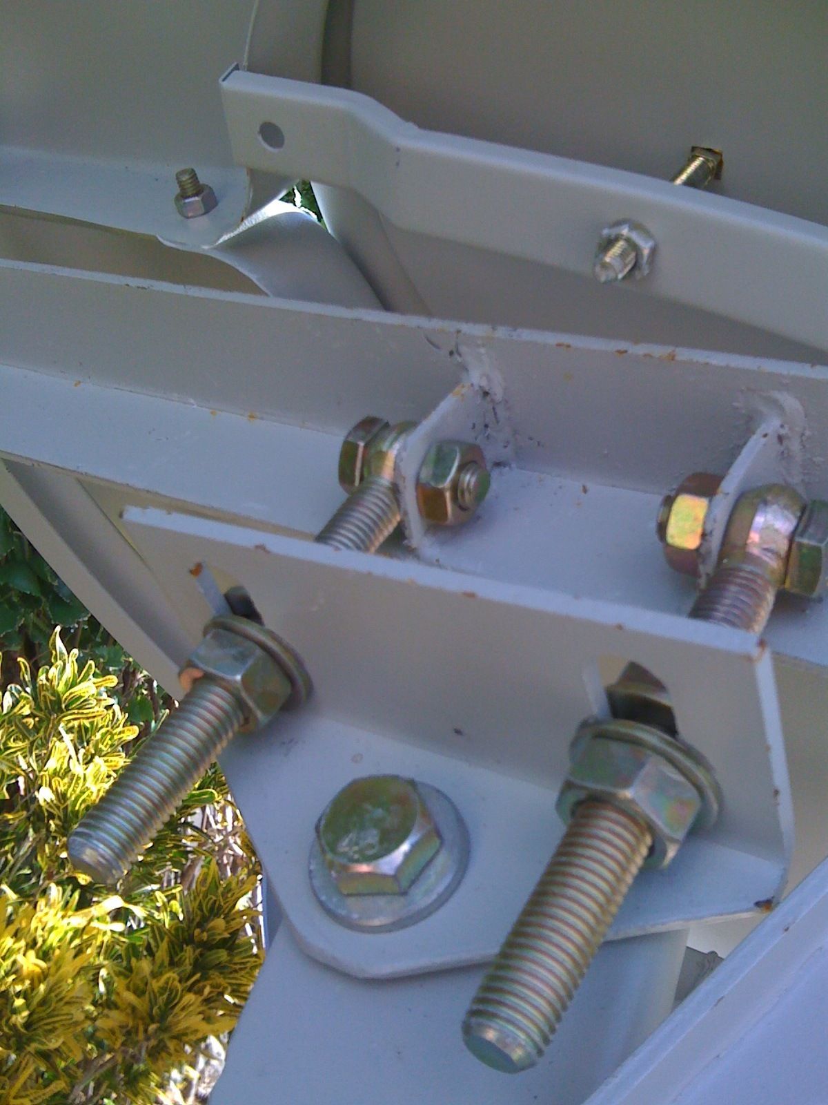

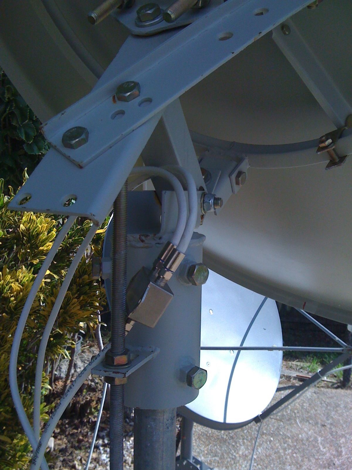

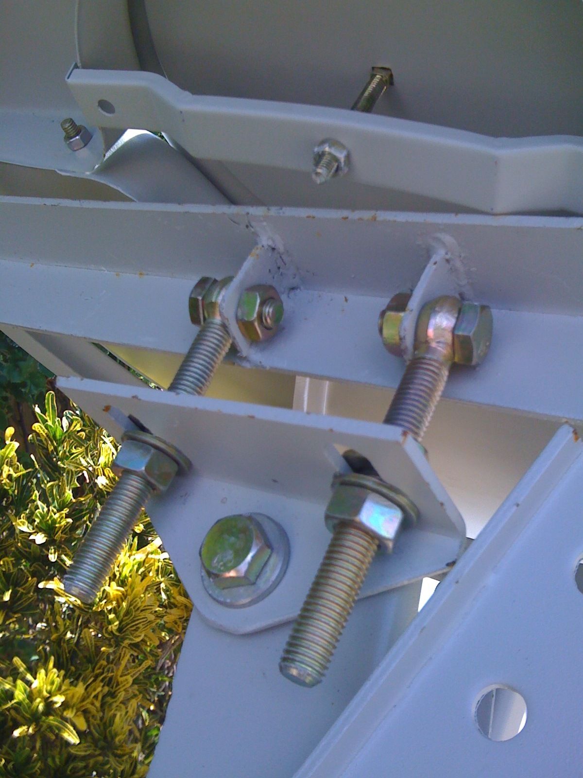

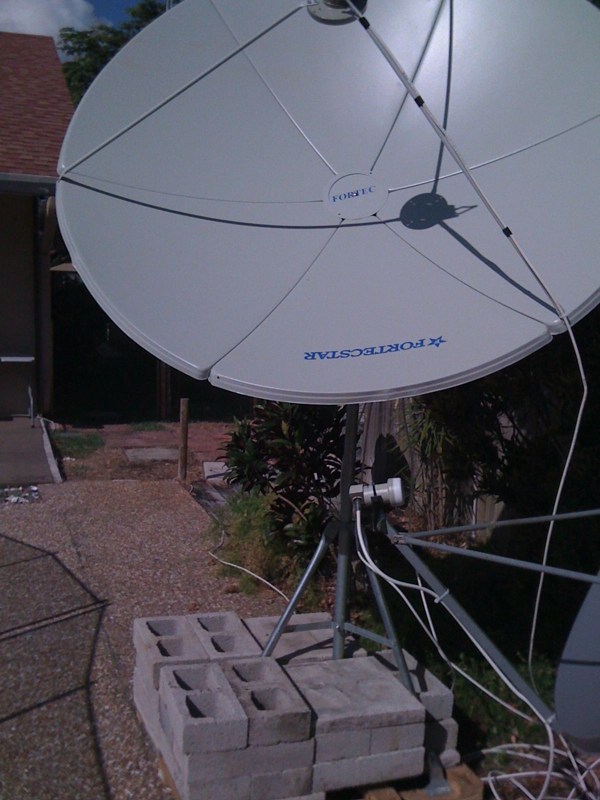

Pics of my Fortec FC06-P Kit from Sadoun. I used a DMX741U with insert for reception of NSS806 55.5W Temporary installed on a temporary stand made by using 4 pieces of 2x4 ($16 @ Home Depot). I used a regular tripod and mast. Screws had to be centered on the mast because of smaller pipe size(Radio Shack mast.)

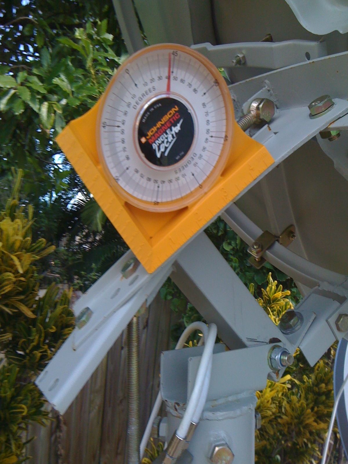

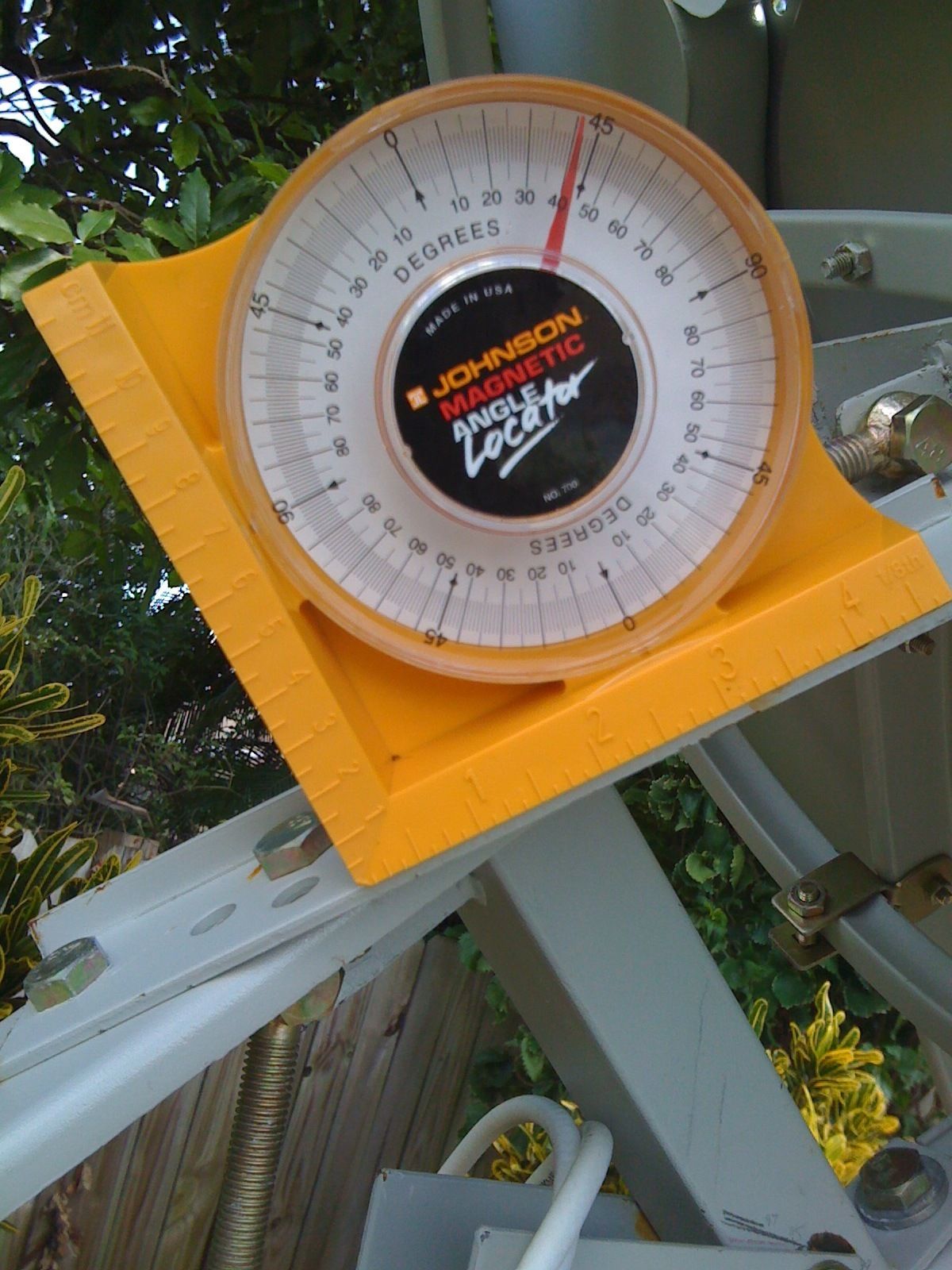

I bought the angle device at Home depot ($8) Very useful for ALL dishes without elevation markings. Makes finding the sats easy. I am using a tone switch for C band on the 6 footer and Ku (97w) dish shown on the pic (DMX741U has a built in Desecq switch and I had to use a tone switch).
Setting the declination made a big difference getting weak sats. I can receive everything( except scrambled) on NSS806 with the exception of three other transponders.

Good effort, there. ;)
Glad to hear you got your bird.
If you were motorized, the small mast would have made it hard to twist the mount to align accurately to your true south bird.
If you should revisit that in the future, consider shimming with several pipes or tubing to get a good fit.

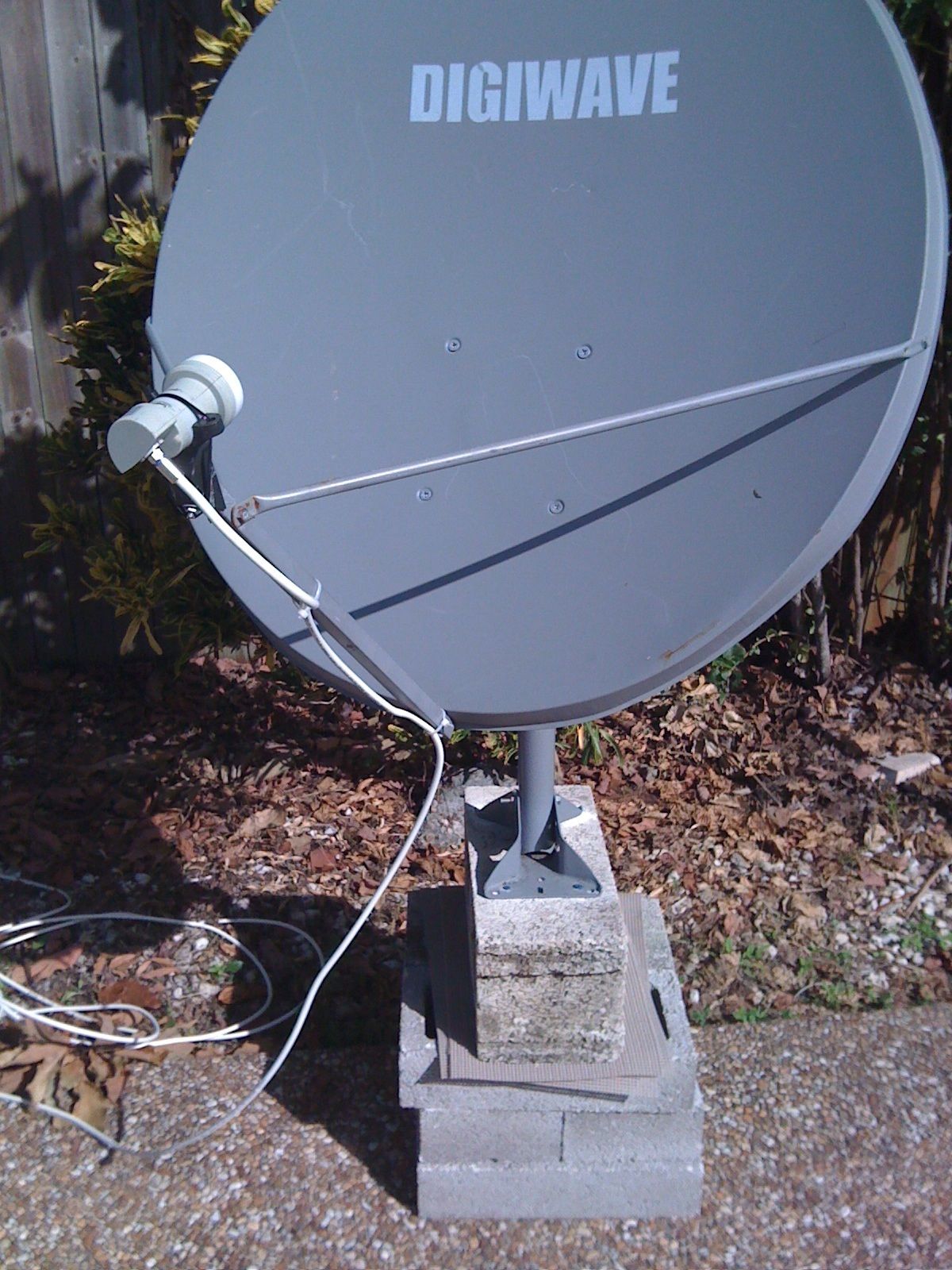

I am in the process of changing the setup and using my GBOX3000 and 24in actuator(Sadoun Kit) and putting everything in a ground mount. I just got the pipe at Lowes today. They sell a 5ft $14 & 8ft $20 (2 3/8). They also have a 6ft smaller diameter (1 .75 in)that is good for KU dishes.($11)It is in the Garden Section. I am going to have both my C band & KU band dish motorized.
I found a neat application for the Iphone that shows me my satellite arc as I hold up the phone to the sky with the sat names/location. I was really happy to have a 7W to 139W view after checking with the program.
However I am going to stick with maybe 30W to 129W for permanent setup. I have been moving my dish on the blocks to confirm reception on the sats. Everthing has been confirmed as the Iphone showed. I am going to use separate dishes for C & KU. I'm originally from up North (NY) so I have been avoiding going outside to dig the hole (We had +90 degrees for 85% of the month), I got to get use to those +110 degrees outside in direct sun.
20$ for the pole!. I paid over 60! and not even home depot had it!. the 6 footer is a big dish therefore make sure you use a thick wall pipe as a permanent pole. 6 ft , 3" Schedule 40 the recommended. that pipe is acctually 3.5 " OD. 2 ft underground and 4 feet above is perfect even for a short guy like me, lol. the poles at the garden section on those stores I beleive are not thick enough specially in the Floridan Hurricane madness. I have no much experience with C band so I am sure somebody else will chime in for more info.
