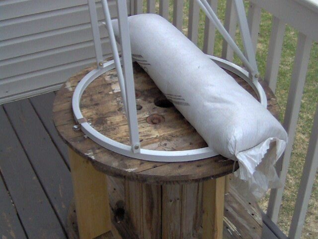

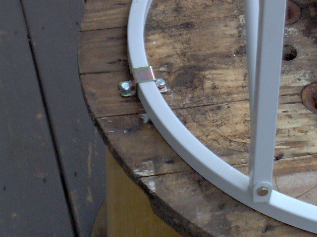

Is the dish going to be fixed at a satellite or ghetto moved like mine is?
If its fixed, there are 3 brackets that come with the dish that can be bolted to something (like the pallet)...see attached pic. This is when I had mine on an old cable spool...had the sandbag just for added weight ;)

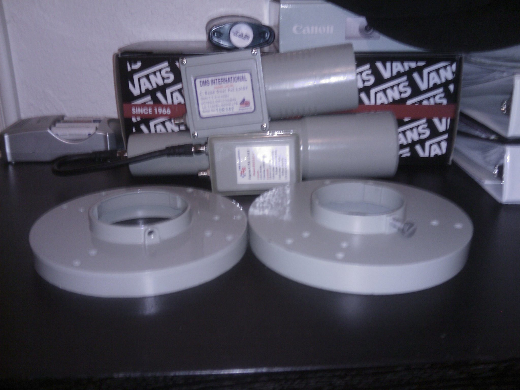

actually I do that came with a hole made for DBS LNB.. Let me see if I can find it and I can post a pic of it
well I did find 2 scalar rings.. brand new ones too that I forgot I even had.. :D
Now I do want to do the mod for dual feeds.. I do have a metal shop next door to my business that can prob make a nice and clean cut on that scalar.
The 2 Cband LNBs I got are the DMS ASC421 and DMS BSC621-2
