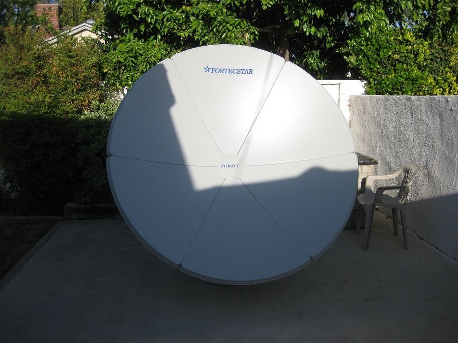

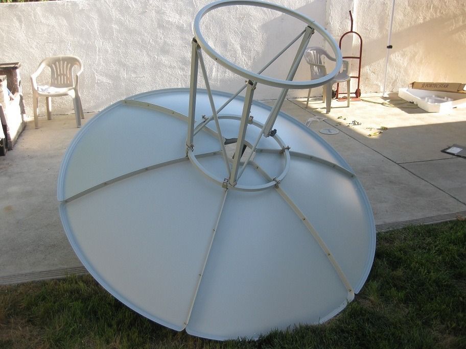

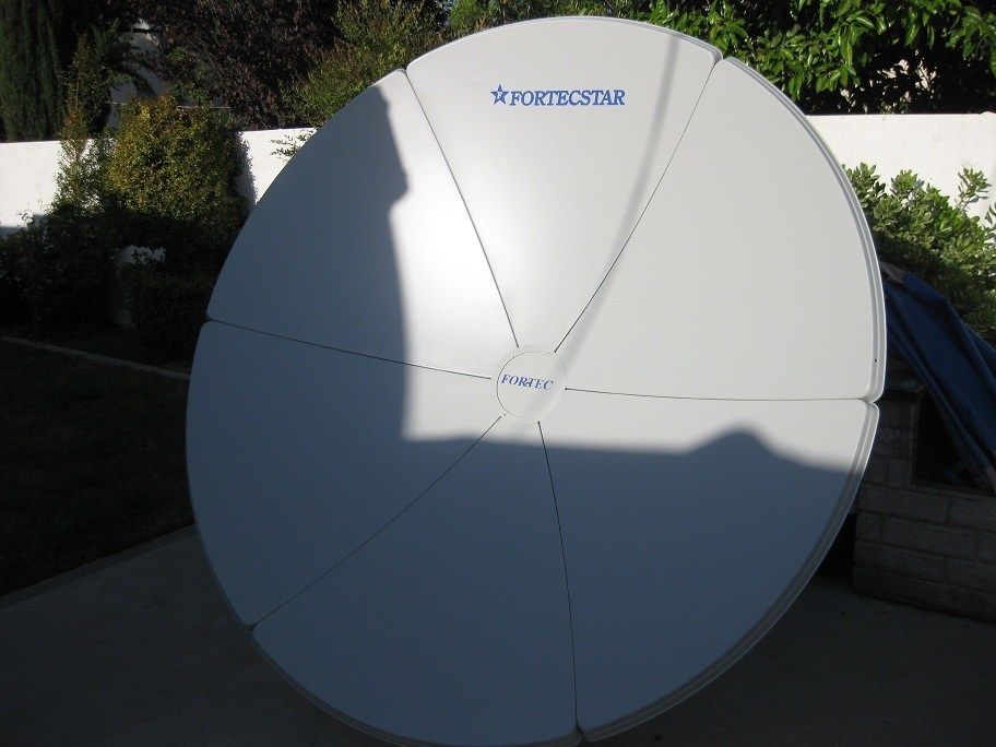

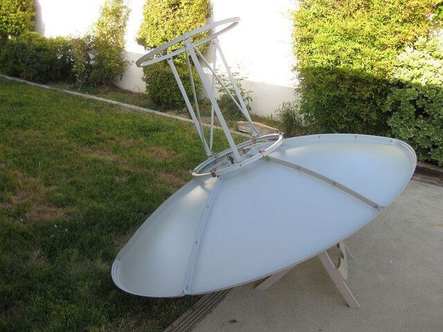

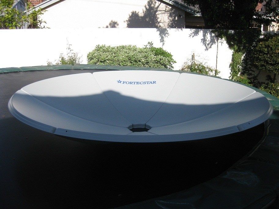

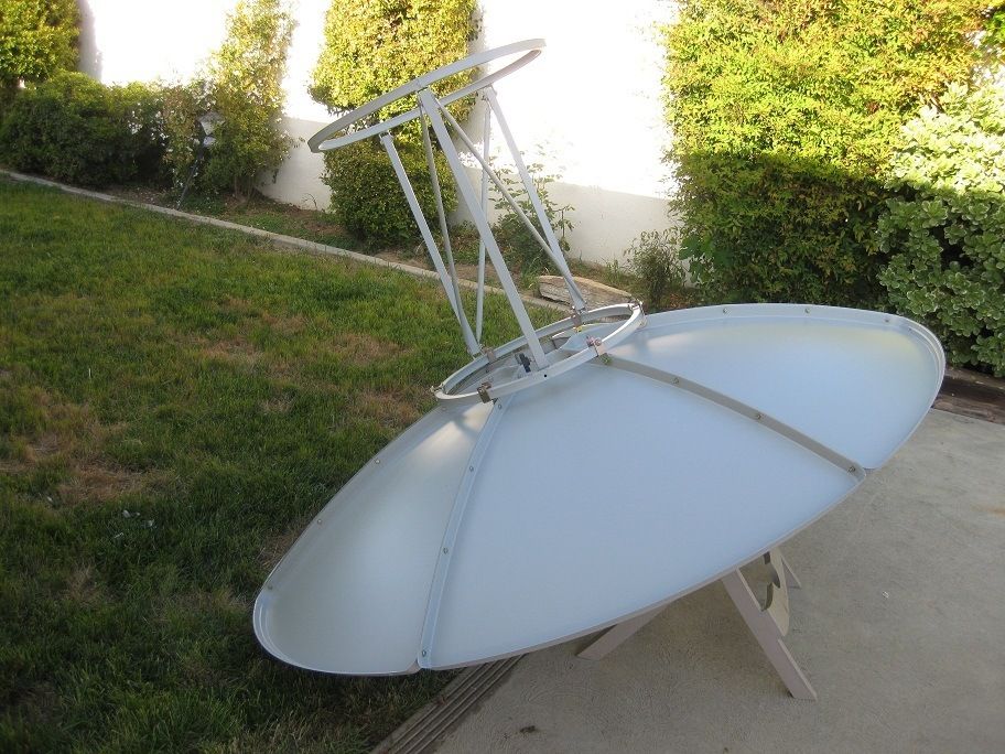

Today I built the 6ft fortec and it took less time that I estimated. Started around 4pm and finished at 545pm.
I did not do any sat aiming cause the Laker game started at 6pm local .. hehe.
Here are some pics as I was building . Man I love this dish, glad I got it. :D

VERY NICE :)

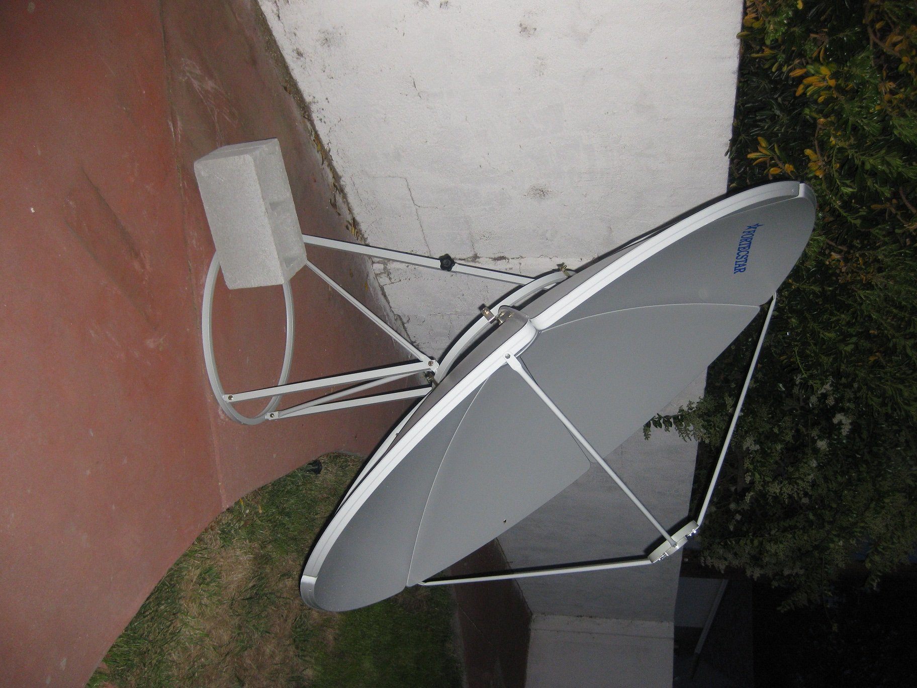

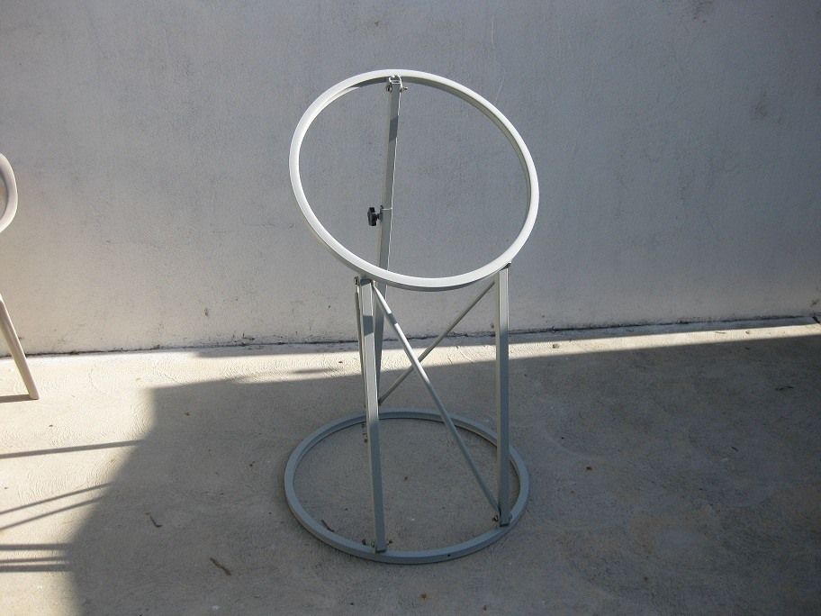

I noticed in the 3rd picture you had the O ring mounted to the frame and then mounted the dish to that (I did it the other way)
I like how you attached it in pic 4 ;)

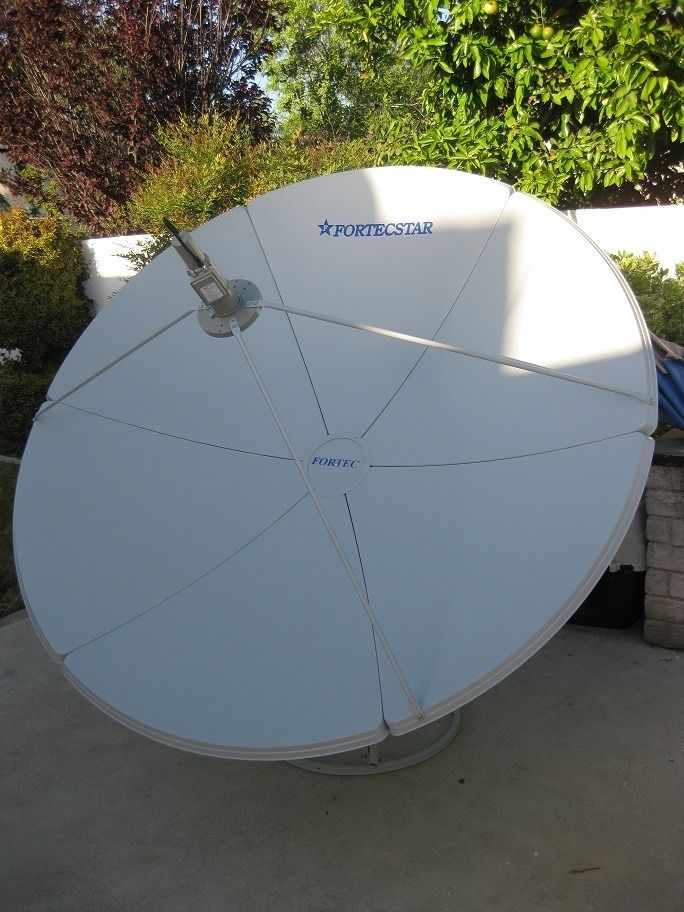

The only other thing I would recommend is to space out the arms a little more. I have mine on every other panel. It looks like there is nothing stopping the scaler ring from dropping (nothing at the top)
VERY NICE :)
link me to a pic of yours to see how u have the scalar arms positioned please.

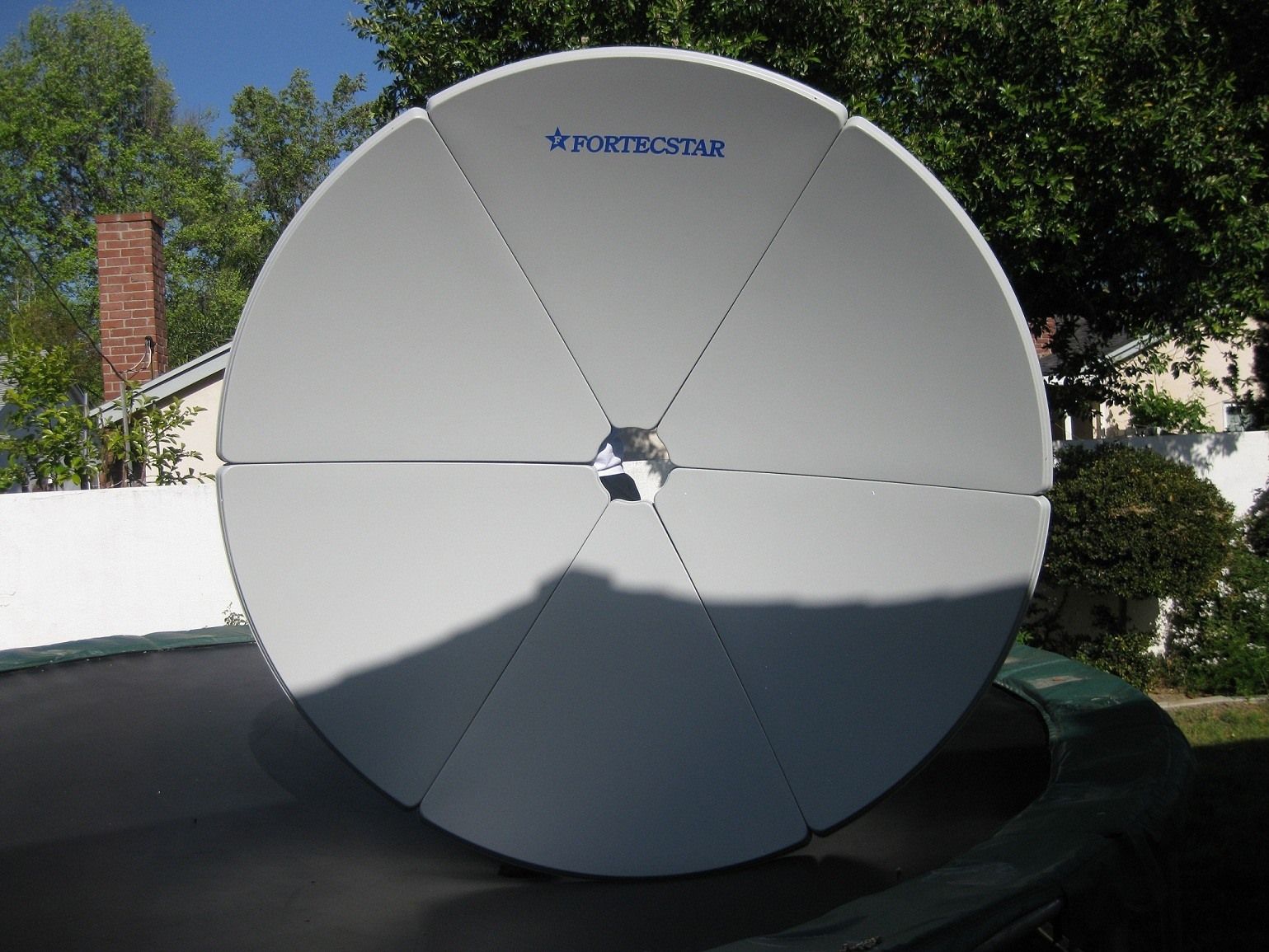

Yes it seems easier this way, and it was very simple to load it on the dish since my son ended up no been home, so I was on my own. I also used my 15ft trampoline to put the dish pieces together.

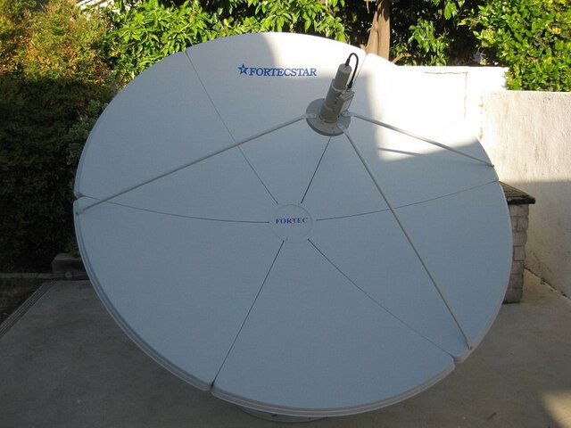

The scalar arm facing up now, but sux that its already night time.

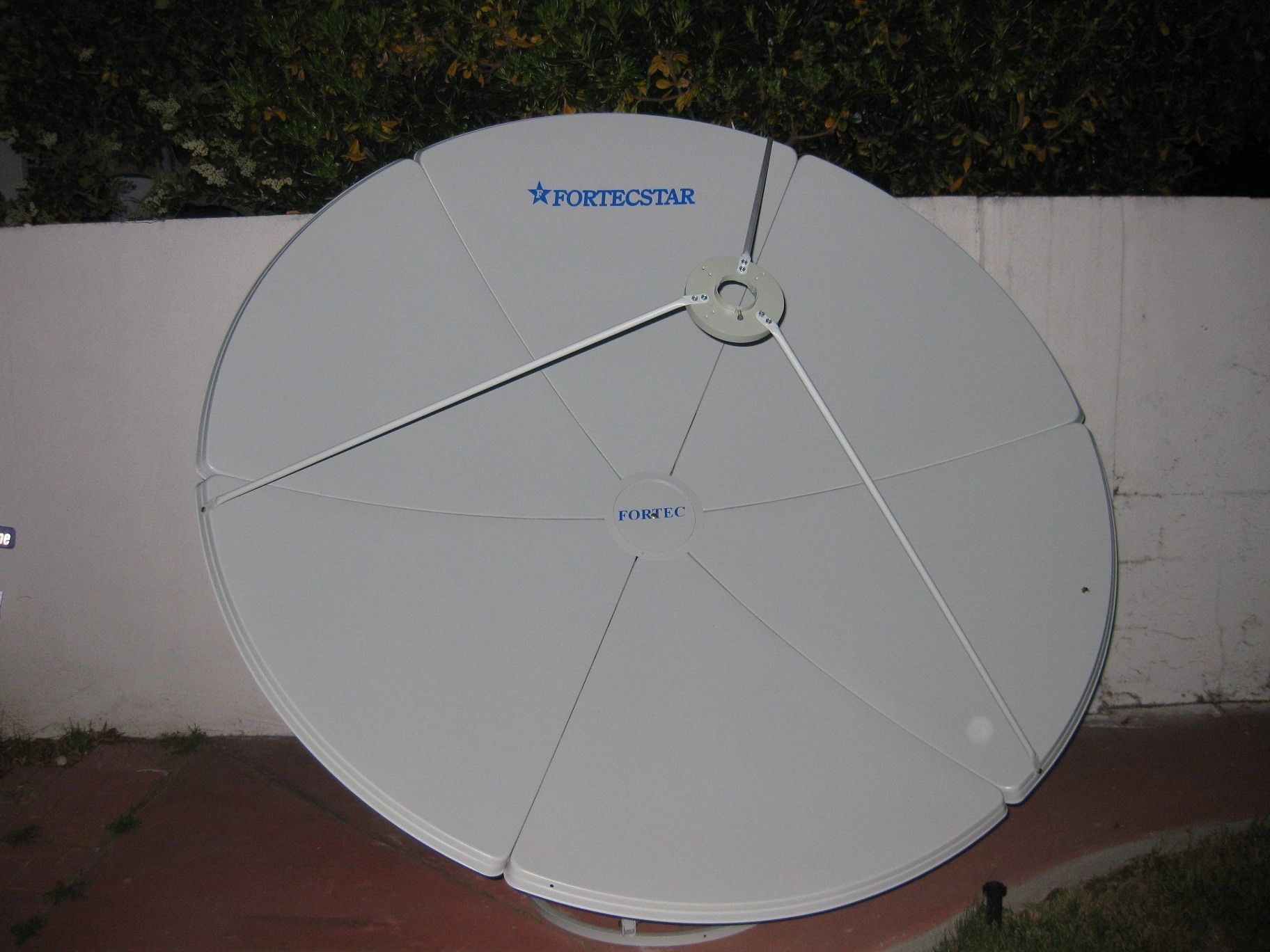

Here are the pictures just taken now and how the upper arm is holding the scalar now.. :D

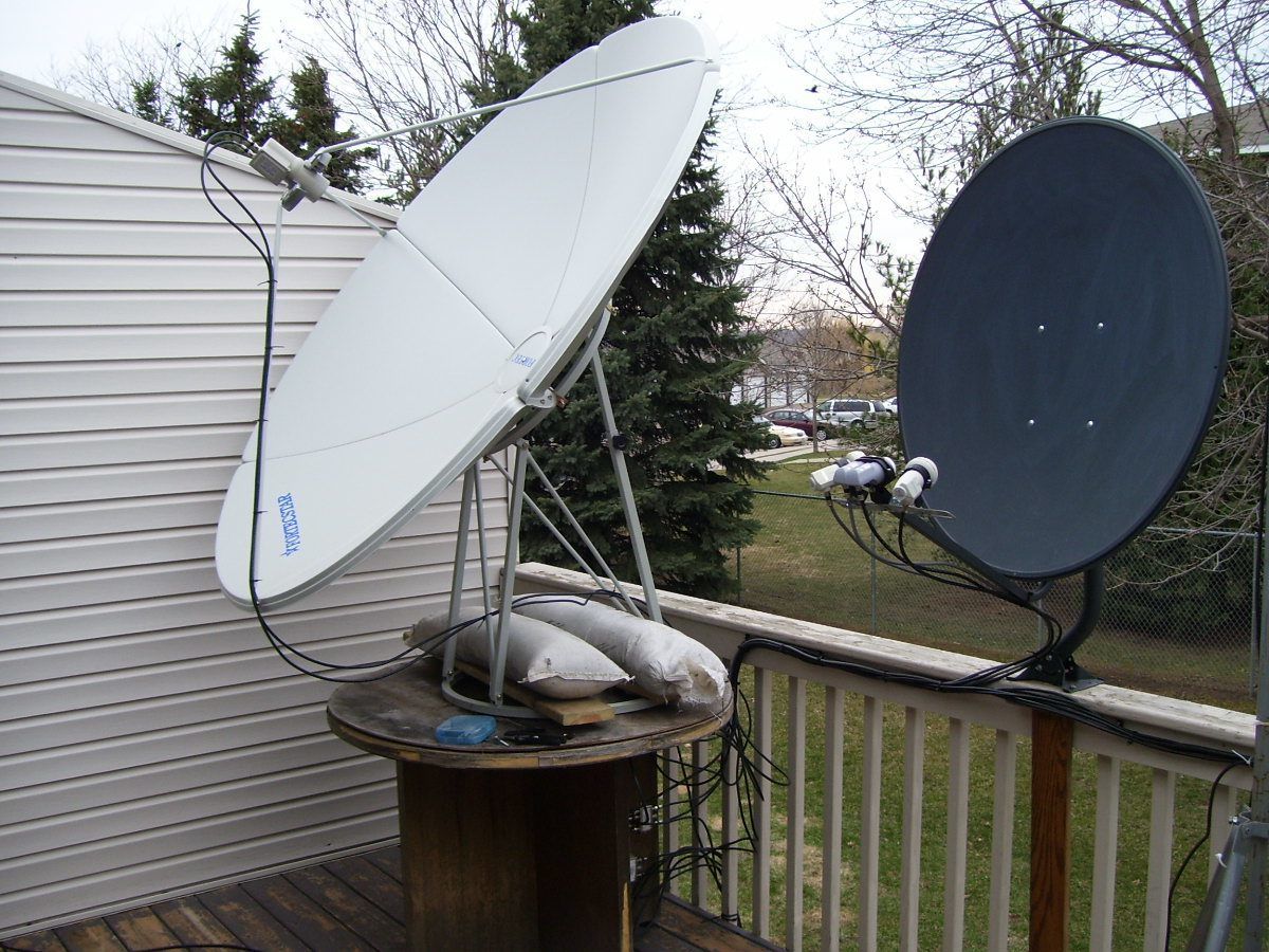

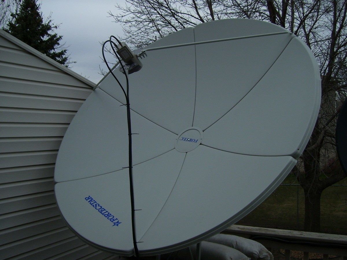

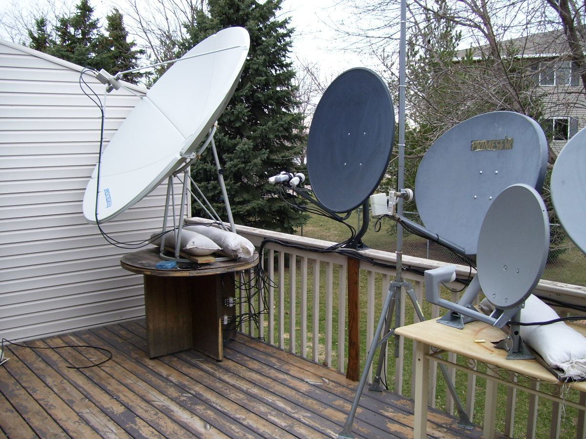

C-Band aims different than KU. C-Band being prime focus aimed "legit" as in a 45 degree angle the dish looks like its at 45 degrees and not facing up and down. See below pics. The C-Band dish and the dark grey dish are aimed at the same elevation. Notice the difference of how the dishes look? (elevation on both was 38ish)
I went and measured the elevation arm for mine. The dish is aimed at 99W which for me in Minnesota is at 38.4 elevation. From the center of the top bolt of the elevation "slider arm" down to where the 2 pieces of elevation slider arm come together is 14 1/2". So you know it needs to be less than that.
LA is about a 50 elevation for 113 & 116 so you need to raise the dish. Azimuth is around 160 for both satellites (give or take a smidge). Being 12 degree difference I would subtract a good 2 inches off that 14 1/2" and start from there
