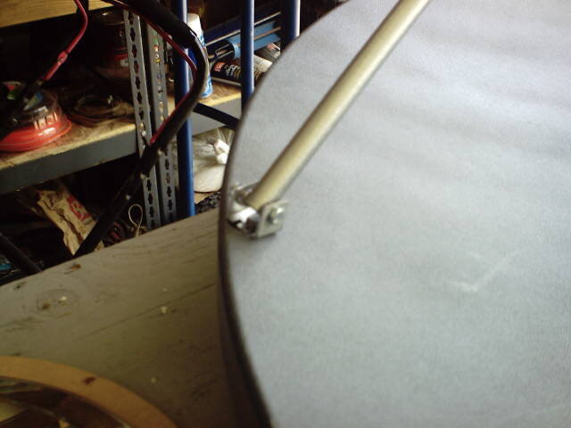

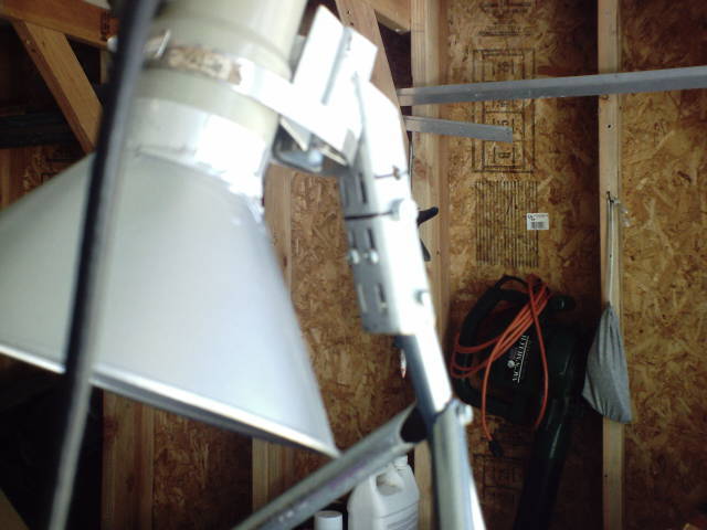

Yes there are worth keeping and with some handy work you can get them to a usable state. I used 1/2 in electrical conduit and some 1 in wide channel 3/4 will work better if you can find some, and a few nuts bolts and washers and made the lnb arms and a lnb mount. I used a program called Parabola Calculator @ hXXp://mscir.tripod.com/parabola/ use the MSI version if using Windows also found on some solar websites to get my focal point and the whole process took about 2 hours. Just bolt 3 small channels over the holes for the arms and then bolt the conduit to the channels allowing the channels to rotate some until you get the focal point the tighten everything up.
