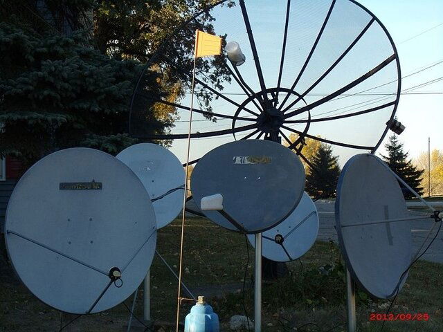

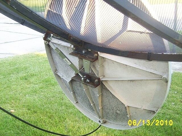

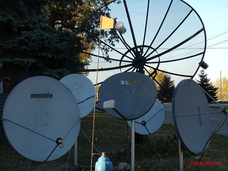

**I went with mounting a 30 inch on the lower lip of the BUD to scan the skies. Fixed dishes on my more popular satellites. Yeah, I know it's small, but being a commercial model, it does all right.

Now that is cool mounting it to the lower lip of the BUD!!! Does it keep in line with the birds when the BUD moves? Never thought of that! that could simplify things for me! If I do mount them seperatly and do evens and odds I can command them seperatly to move to the same position?
YES and YES. Tracks as good as the dish it's on, perfectly. A Ku dish motor IS a polar mount.
http://www.satelliteguys.us/free-ai...-i-made-c-only-bud.html?highlight=Bud+play+Ku
One possible problem is the weight of the dish(es). My BUD is 100% HD steel construction. Lightweight aluminum may need some reinforcement.
If I had an aluminum dish, think I'd use a 36 inch stamped steel dish, as they are a lot lighter than even my 30 inch 'glass Channel Master. I wouldn't even consider putting my 84e on it. 1.2m? NO WAY.
