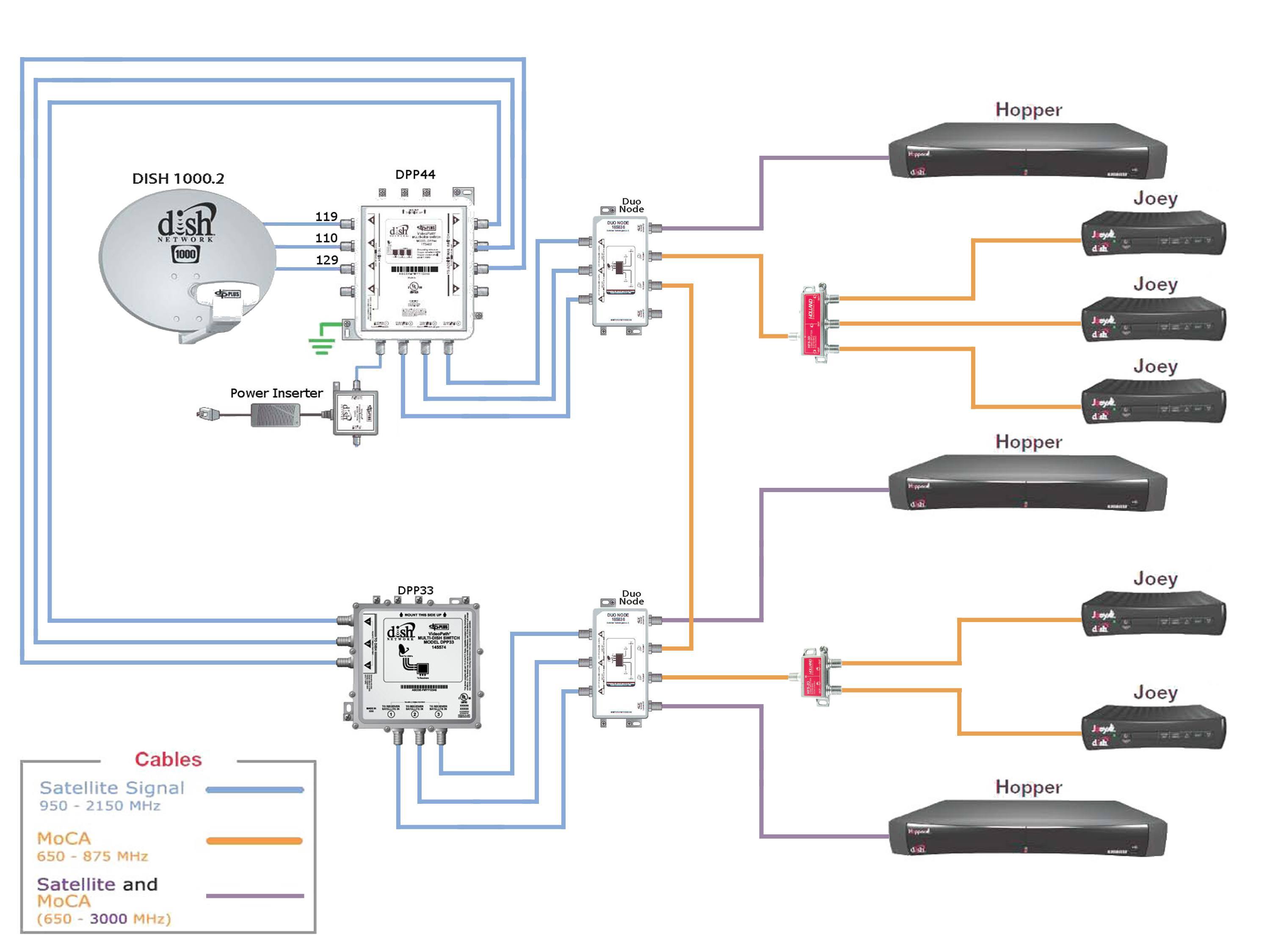

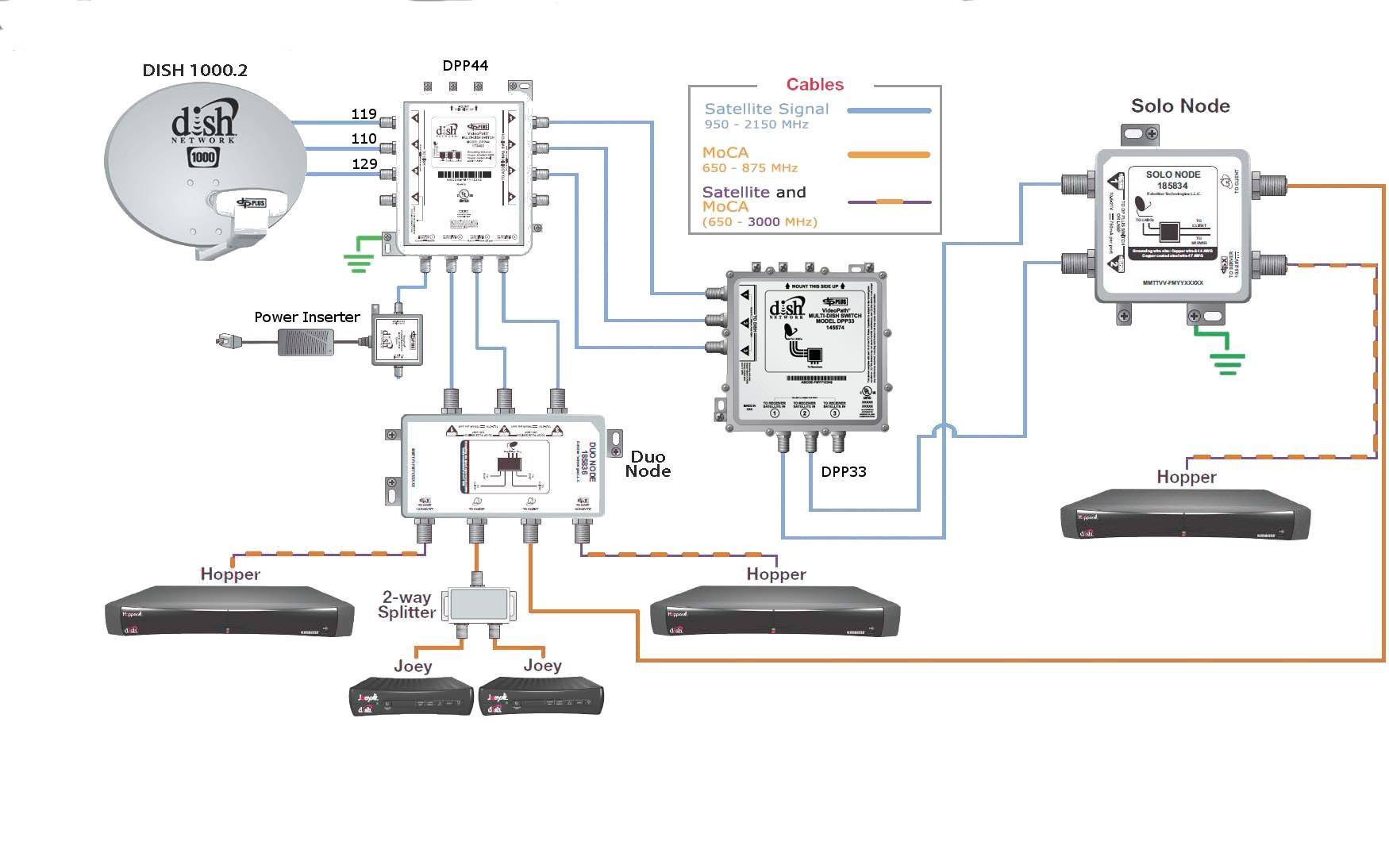

Are you using 75-ohm terminators on all unused MoCA ports? Using any RG59? I also have 3 Hoppers, however instead of 2 Duo Nodes I just used a Duo and a Solo Node. All receivers are four green bars. Here's my setup :-
I would think so, but one might get by with placing 75-ohm terminators on the extra unused CLIENT and HOST ports on the second Duo Node. Not sure if that's ideal though.
3HaloODST thanks for the input. I, in fact, used your diagram and only substitued the Duo Node for the Solo Node.
I've only used RG6 since I first installed Dish in my house 13 years ago and all open ports are termininated with 75-ohm teminators.
I used the Duo Node so I could split the Joeys across the open client ports on both Duo Nodes without having to use taps. Other than the yellow MOCA strength bars, all is working fine. All Joeys can see and link to all Hoppers; all Hoppers can see all other Hoppers and Joeys. DVR recordings from all Hoppers play everywhere.
I'm assuming that I have another bad component or wire somehwhere in the MOCA network.
