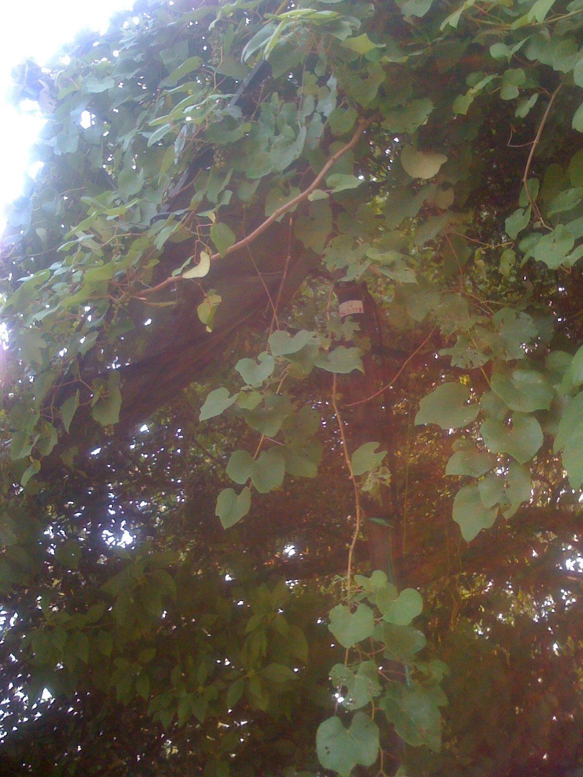

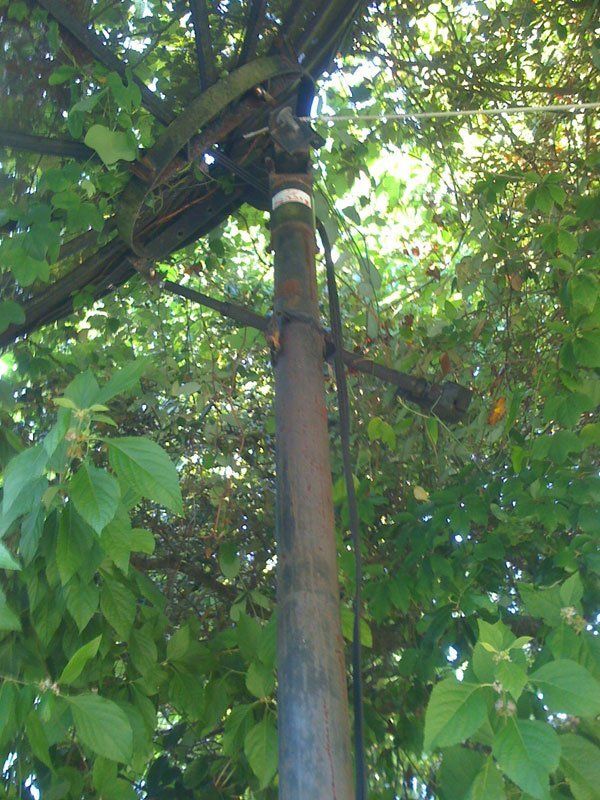

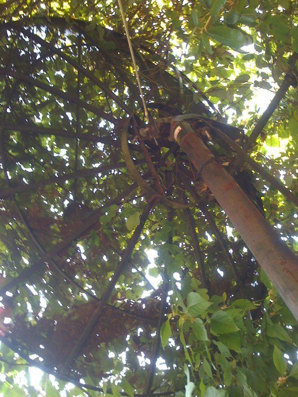

Here she is. :) Looks like it to be a heck of a job, its pretty tall above the ground if i had to guess i would say 10 to 11 ft up, can the panels come off and just be brought down slowly?

If you can use the tree, remove the 4 or 8 bolts that hold the Dish to the Mount, and with a roap over a limb, lower the Dish down as a whole. Then remove the Mount from the pole.
Hope you have a few friends. :)

Take a look at the last picture does the mount look bent there? i just noticed that. it has been through 30 years of FL hurricanes, ivan, katrina, and dennis to be the worst i can remember.
be careful with the vines they will hang in the mesh and weave back and forth through the mesh. use a pruner or something to trim them clear.
depending on the owner of the dish if they have no problem with it. use a reciprocating saw and cut the pole close to the ground leaving a bit attached and bend it over slowly. it should ease to the ground

Just like George stated, "Remove the vines". I too live in Florida like you, only I live further down state of you, on the "Nature Coast".
Getting back to the point. Remove the vines by cutting them away from the dish. There're too deep in the ground to pull out and too many of them come from the same root that are all over the dish. So if you pull them you might cause damage to the feedhorn. Take your time. You can now see the condidtion of the feedhorn.
Once you are all clear from these vines you can see what you are doing. Then put some WD-40 around the bolts. Put them on the bolts for the actuator and the mount that connects to the support pole. Disconnect the actuator from the dish. Have some help with you on this step by having someone hold onto the bottom of the dish. Once the bolt is disconnecter from the actuator and the dish , the dish will want to swing. It will swing fast too. Thats why to have some help holding it. The dish should be situated perfectly virtical now. losen the bolts on the mount that tighten to the pole. Too bad you are so far up north from me or I would let you use my Dish Crane to get off the dish. Then once it is clear from the support pole you c an take down the dish in two ways. Like Lak7 said, "with a robe over a imb, lower the Dish down as a whole. Then remove the Mount from the pole." Just tie a peice of robe on the mount and have the robe being held to raise it off a couple of inches to clear the support pole then safly lower it to the ground.
Or if you have extra help with you you and raise it yourself off the top of the support pole while your help holds onto each side of the dish to sopport it has it comes down.
Once that is done and it is safely on the ground you can remove the part of the mound that connects to the support pole and the other main part of the mount.
I don't think you will have far to go from that place to a place you are gong to store it at? Leave the dish whole. Thats what I did. You will find that most or all of the bolts are rusted. Replace one section at a time with "Stainless Steel bolts". Count how many bolts, washers, and nuts and then replace with new all around the dish. You will be supprised at how many bolts you thought were still good that turn out to be paper thin in the middle!
Then has George said, "use a reciprocating saw and cut the pole close to the ground". Only now you can use it to cut down the complete pole without bendinf it. You can use that part of the pole to have welded onto another pole. If you have a lot of Pine trees like me you will need a tall pole. You will also have to have it burried deep in the ground too, We're in a "Sandy Soil" State that gets huricanes so you will want it safe by digging deep and having rebarb attached to the pole so it won't turn in the cement in strong winds.

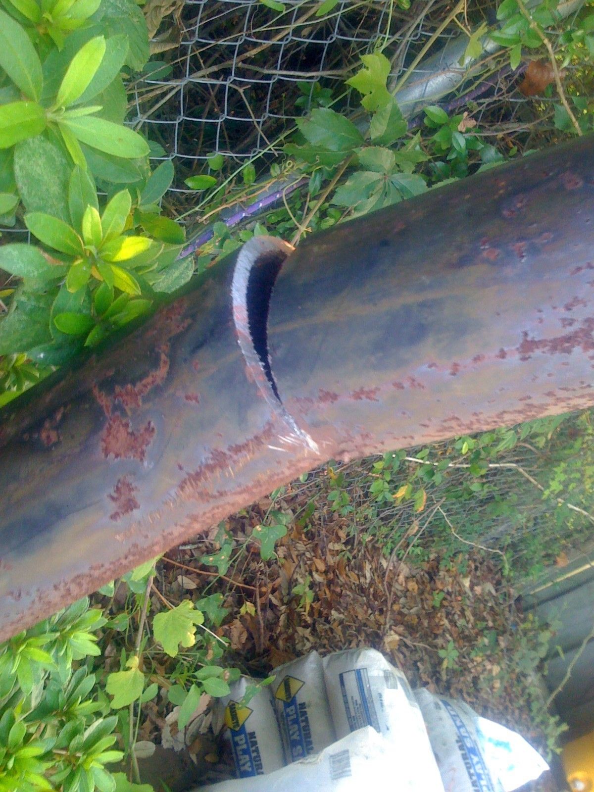

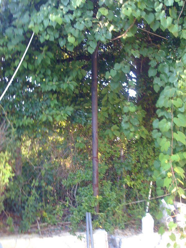

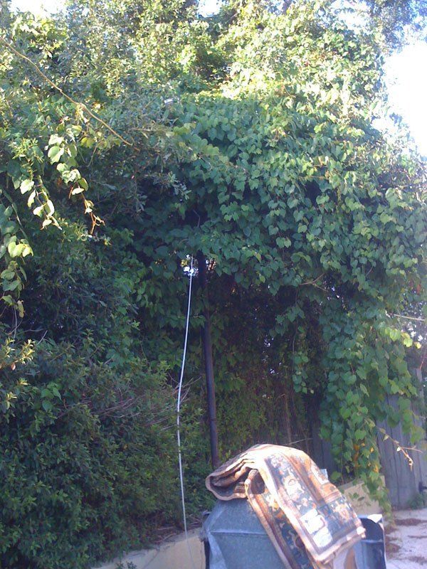

Ok finally got some progress made. Although i couldn't get the vines cut like you all suggested but this is what i got so far. (see attachments) Now everything looks good although i cant get it down because the vines are holding on to the LNB mount. I rocked it back and forth for a while but had to go get in the pool cause anyone from FL knows how hot it was yesterday. So now 2 issues...
1) I got to get it down out of the vines (they are not growing through the mesh
2) There is a hot 120v power cable strung through it going under the lnb and over to a light that comes on at night so basically im going to have to take it apart to get the power cable out.

From looking at your first picture I can see all the over growth that has taken place and is taking over the dish! Did you cut the pole (Middle Image) and then try to pull it down with a garden (last picture) hose?
I hope you are having some help with this to take it down.
The first thing would be is to cut the power to the hot 120v power cable.
Look on the ground and cut the vines at ground level.
Pull each vine one at a time and pull away from dish and feedhord. Wear gloves for this as these vines that grow in Florida have pickers on them, and they will often grow and attached themselves to other vines. Pull all of them out one at a time till all is clear.
Now looking at your middle photo it shows that you cut the pole, so have some help (maybe two besides yourself) there before all thew vines are ripped out to support the dish from falling in a way it could get damaged.

After looking at the last pictures you posted I sure hope your being careful because I could see how having the pole cut more than half for this project could turn really ugly.. real fast. Once you start cutting the vines, that hose is not going to hold the weight of the dish because being top heavy its going to start leaning and will break the remaining metal... by cutting the pole more than half way you've created yourself a danger to you and anyone helping you.
And having the 120 volt power line makes matters worse...you need to disable that circuit at the breaker box before the dish falls and takes it down, you don't want the circuit to short out.
In my opinion the only safe thing to do is to remove the feedhorn unit, unbolt the dish from the mount and let the pipe and mount drop to the ground. Take some c-clamps and rope and secure the dish from coming down, then cut the other vines dropping the dish, lot easier to handle dish by itself.
