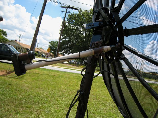

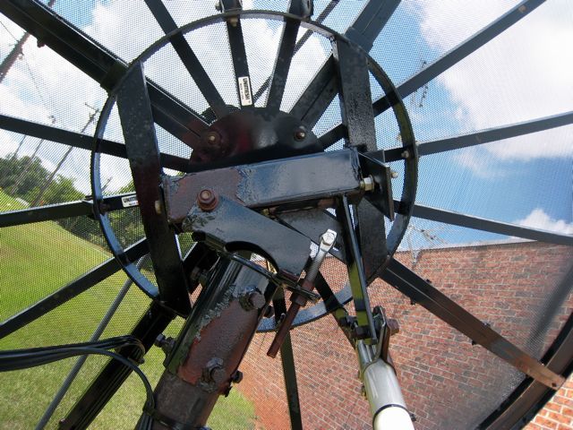

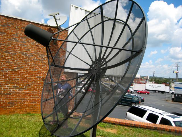

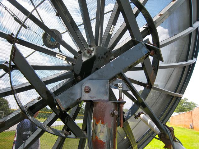

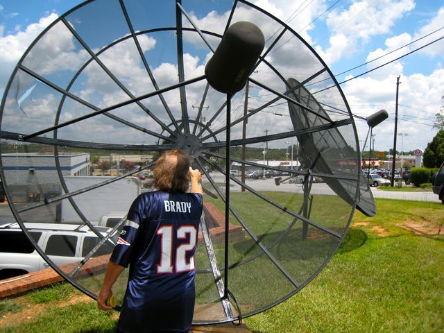

Hey guys! Just thought I'd update things. I went by this afternoon and PB Blasted the dishes down. I'm still undecided whether I want the 10 or 12 footer. Obviously, I'd like to have the 12 footer for more gain but I think this being my first BUD, the 10 might be easier to setup and manage. I've heard here in SC the 12's have so much gain that it starts pulling signals from nearby sats and they're harder to align. But, we'll see. Attatched are photos. What makes me sick is the owner of the electronics store that is giving them to me and Comptech actually had about 12 other dishes new in boxes ranging from 6 to 12 foot stored in the backroom, and in January he filled an entire dumpster full of stock, including the dishes and related parts (LNBs, actuators, etc...). :( Can anyone tell me what kind of dishes and mounts these are?

I'm not really sure what it's "rated" for to be honest. What kind of mount do these have on them? Polar?

Yeah those are Polar Mounts, with actuators. I am not familiar with Unimesh dishes, which is why I didnt pipe up, but they do look like Unimesh brand, which have a good rep in the sat world, some cable companies use them I am told.

I went buy and looked at them today.They are Unimesh's and in really good shape. I will be more than happy to take the twelve if you have a space problem. I will call you today and see if I can start getting them down tomorrow so that on wensday it will be easier to get them off the poles.

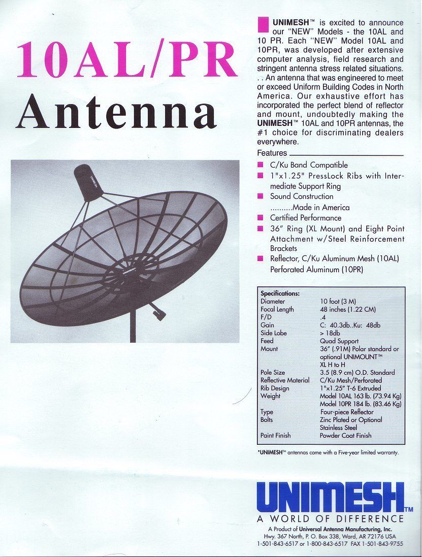

12 foot Unimesh's Rock :D Proud owner of a 12XL since 1989. :)
