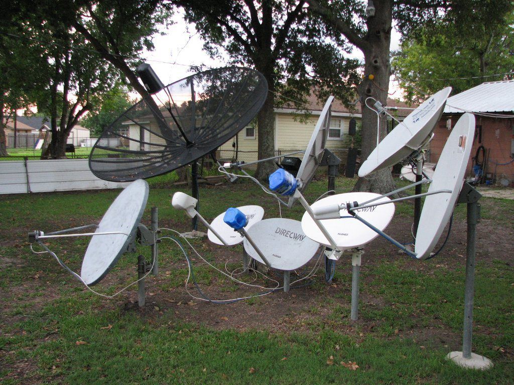

In the meantime, I have begun to build a dish from scratch. Well, sort of..
Previously my dad gave me a large collections of assorted tools. I am making use of them now.

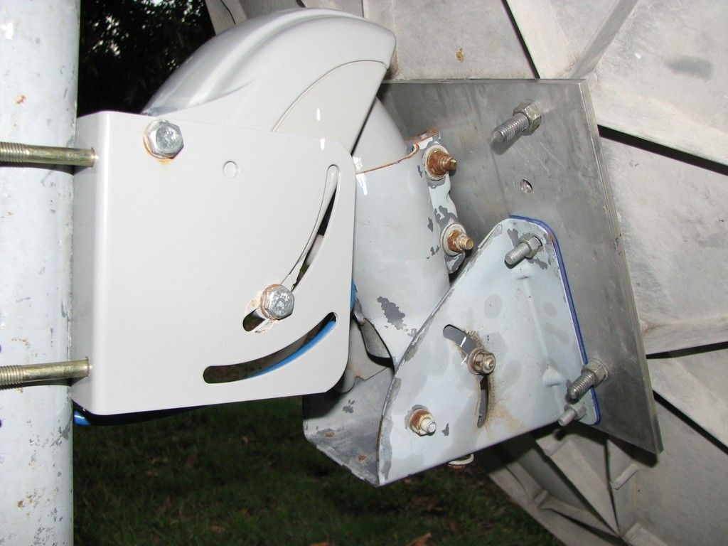

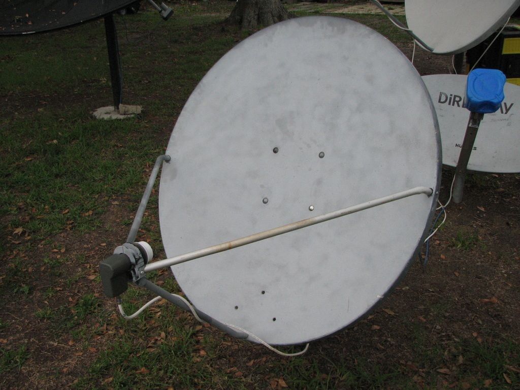

I have taken my old "Lawn Chair Dish" and I am adapting it to my motor.
The dish is a 1 meter primestar that I found on the side of the garage. It was missing parts so I put it together using some tubing from a lawn chair and made it usable once again.

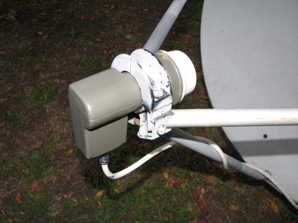

I put a fonky old LNB on it I found in a junk box though I still don't know yet if it works or not.

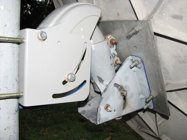

My dad had given me a large aluminum metal plate last year when I was trying to put a much smaller primestar dish on the motor. Neither one of us had any idea how to do it and that plan eventually was abandoned. Yesterday I dug out that plate and figured out how to use it to adapt a smaller dish mount to the large dish. I'll post pictures of what I'm trying to do later on.
I measured and drilled holes in the plate so that the dish mount is offset downwards from center to compensate for flipping the mount upside down. This probably doesn't make much sense but after you see what I've done I think you'll see what I'm attempting to do.
So this dish is pretty much made up of a little bit of any and everything I could find laying around. Fortunately for me hoarding is a family tradition and there's a lot of junk around here to dig through..
So I'll end up having a 1 meter dish on a motor, a 1.2 meter dish fixed on 123w and a minibud C-band on there too. That is, these three dishes on my new Openbox S10.
The WSI 6' C-band dish is rusting away and not being used. I have a very nice 1.2 meter dish that is missing 100% of it's parts, all I have is the plastic dish. I'll have to make all the tubes and arms and what-nots for it. So what I plan to do is remove the WSI from it's mount, dissemble it and store it away. I'll adapt the 1.2m dish to fit the WSI motor mount (I hope) and then I'll have myself a high quality minibub. I guess I can plan on working on that when it starts to cool down and the mosquitoes go away...
Oooooo! I'm really happy! I took that weird LNB and put it on the 1m dish, connected my little meter and I was able to find Galaxy 19 with little trouble just by propping the dish up against my leg. :D
I had tried to use that LNB about 2 years ago or so and I couldn't make it work back then so I thought it was junk and threw it back in the junk box where I found it.
At the time I had no clue on earth what I was doing..
So now know it works and it solves a problem I had of being short an LNB. :)
So I've got all the things I need now to set up a decent motorized ku dish. It's going to be a real ghetto job but I'm pretty sure it's going to work..
This isn't my first choice in how I would like things done but in the end I think it will work out pretty well and tide me over until I can save up for something much better.

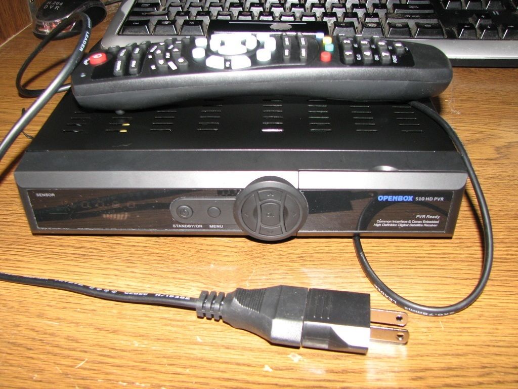

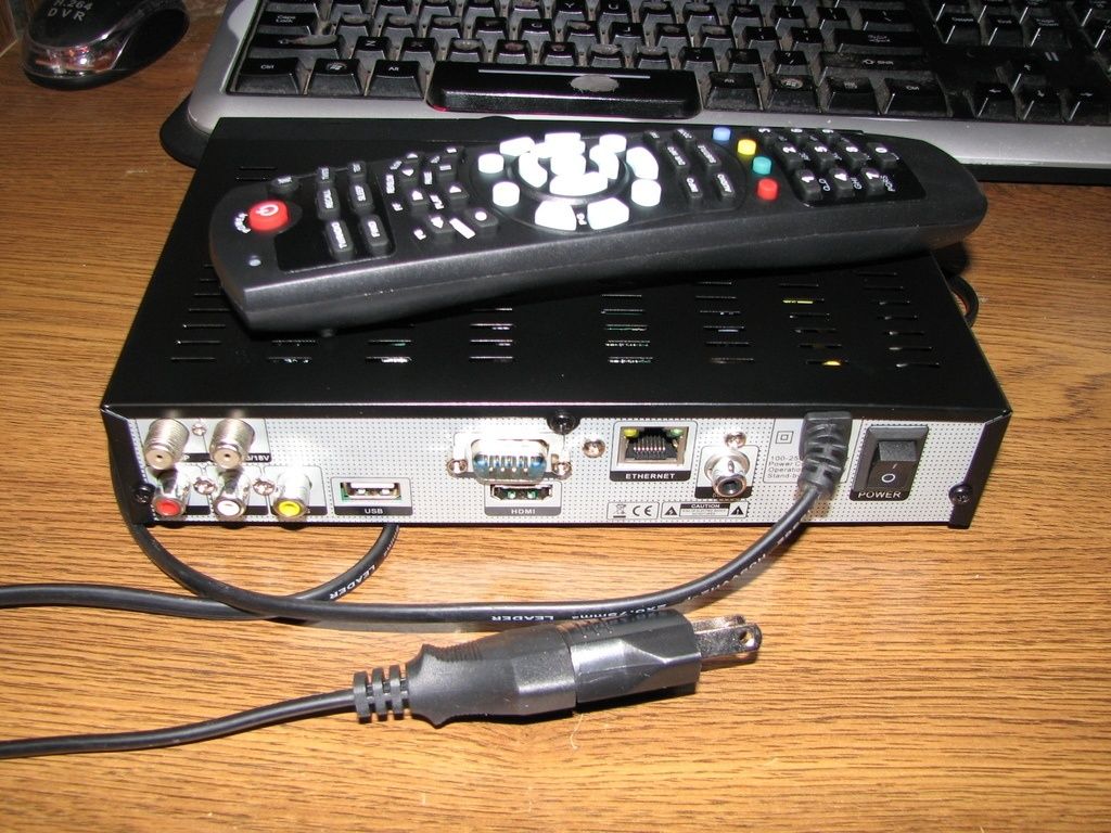

Well my Openbox S10 came in but there's a problem.. :(
It came with that stupid European plug and an adapter. I do NOT like that. Plus, the power cord is very, very "dainty"... It doesn't seem proper or safe to me.
It came with that BAD remote control that is unreadable. White letters printed on white buttons! :mad:
When I go into the setup it's all EASTERN satellites, ONLY. When I try to input my location into the USALS page, it doesn't allow me to set western locations, only east. :(
Did I get "took" ???

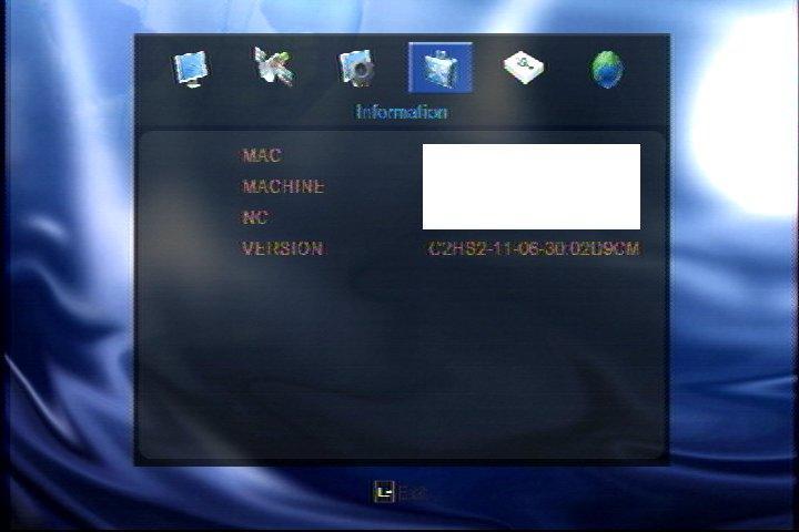

Edit: I figured out how to set the location to west. Now I need to figure out how to load the right satellites in. I have files left over from my folks S9, maybe I can use them.
dee_ann just load the new firmware from here.... its easy to load from a usb stick... i will have the north american sat list too
I found what I needed. I had the files left over from my folks S9 and I was trying to load them by the wrong file name. It took me an hour to realize what I was doing wrong. DOH.... :o

I managed to put together a 1m dish out of left over and unclaimed parts (and one lawn chair!) and got my new Openbox S10 upgraded to the newest firmware and got it all working and scanning satellites!
I ran a wire from the S10 to the motor then a wire from the motor to a 1x4 switch. Then I put the LNB of the motorized 1m dish into port 1 and I put the LNB on the 1.2m fixed dish (aimed at 123w) onto port 2.
The S10 moves the motor and the dish goes to all the satellites as it is supposed to. I set it so that for 123w the motor is ignored and it just goes to port two of the switch.
I also put that USB disk on the S10 so I can record. I guess I'll have to record stuff then remove it and put it on my pc to copy things over. Pretty much a pain in the backside but I guess I have no choice for now.
So, so far so good!

Well I mostly have it working.
The clock is a joke. Every time I change channels the system time changes, radically. There is NOWHERE in the menus an option to allow you to manually set the clock.
In the menus it asks what region you live in. ALL of the options are for the other side of the planet. There are zero locations in there that relate to the western hemisphere. I told it I'm in the United Kingdom because that's the only region they have that is English speaking. :mad:
There is an option to set your UTC time zone. I poked around through it and found that if I set it to UTC -06:00 it shows "HOUSTON" as one of the cities covered. OK fine. Whatever..
Still, no matter what you set what to, every time you change channels, so does the time. And not just the hour, the minutes will change too. One minute it might say 11:08 and the next minute it might say 06:23 !! :mad:
This means that scheduled recordings are out of the question. I would like to be able to schedule recordings. This thing, doesn't facilitate that, at all. There is provision in there for timed recordings but with the wonky clock, it's utterly useless!
I poked around on google and misc. forums and I found a firmware to load it with. I was scared to death to try it, I see you guys talking about "bricking" your machines. I read that some jerk put out "clone killer" firmware that will fry your machine unless it was made by THAT company. Anyone else that tries to use it, loses... Not having any clue as to what I had, I was taking a huge risk with a brand spanking new machine. :eek:
But I had to try it because it was all set up for Europe/Asia and zero US anything in it. I was hoping that this new firmware would fix that.
It didn't. It installed ok but nothing changed. It shows that it's the newest version and it shows the date of 09/11/2011.
I don't see any provision for the type of file it records, IE .dvr or .ts
It does see the USB disk as 500gigabytes and it uses it. I can pause, rewind, record and playback channels. It doesn't tell me what file type they are in though. :(
Another extreme annoyance :rant: is that it's remote control messes with my PC tuner. I have no choice, I have to put them next to each other, they are in a cabinet and a pyramid controller sends the remote signals to them from outside. So when I mess with the S10, it messes with the PC too. The PC doesn't mess with it though. Like when I press the exit button on the S10, the PC changes channels. :mad: :rant: I don't see there's any way around this. My Coolsat did the same exact thing... :mad:
For some reason it isn't seeing 125w with the PBS but it sees everything east of that. I am assuming that my ghetto dish needs some fine tuning.

Well this thing is a HUGE disappointment after all the hype.. The clock does not work. When you turn it off via the power button on the remote control then turn it back on again, it "boots" and resets the clock to Jan 1, 2010. EVERY TIME.
Doesn't matter what you set the clock settings to. Manual, UTC or region. They all give the wrong time constantly and turning it off/on resets it to a useless time.
This means this machine can not be used to do timed recordings. :mad:
Somehow I must separate this machine from the PC. I have them both in the same cabinet and use a pyramid for the remote control to operate them. The S10 remote totally screws up the PC. Just trying to operate the MENU of the S10 or use the up/down buttons or the escape button causes the PC tuner to abort recordings, change channels and lose the buffer!
Sometime I will pause a show on the PC and go wash dishes and cook for an hour then come back and unpause it. At this point I can fast forward through commercials. BUT, if I change channels, that buffered show is GONE. The S10 remote caused me to lose an hour and a half worth of paused shows in the buffer! :mad:
There is no way, NO WAY, these two machines can be near one another. I have to be very careful to put it where it's impossible for me to accidentally point the S10 remote towards the PC pyramids. This makes me very unhappy that these two machines can't share the same hidey-hole. :(
I'm really very p***ed off about the clock on this thing. This is so useless. Are those people STUPID to make such a SHABBY product? And not just once, but two times! The S9 is like this, so I read, and now this one does the same exact thing? IDIOTS!!!!!!!! :rant:
This machine was not bought to be my primary source of TV. It was intended to be a secondary machine that would sit in the back of the class recording shows for me on a SCHEDULE. Well, that's a great big FAIL......... :mad:
Oh, and I made a few test recordings on the USB disk. When I powered it off and back on the disk made a nasty clunking noise a few times and now it shows up that it's blank... The recordings that WERE there, are now gone. It erased them itself.
Now I have an almost useless Coolsat and an almost as useless Openbox.
I swear, I so want to take a hammer to this thing right now........ :mad:
What a POS.....
