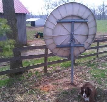

The dish is just outside of the barnyard and because of the location of the barn it will not go much east of 119W.
This picture tell the story pretty well.

Larobpra said:
Being an offset dish, line of sight over the barn may not be an issue.
How is the line of sight different for an offset -vs- prime focus? Both would require the entire surface of the reflector to "see" the satellite.

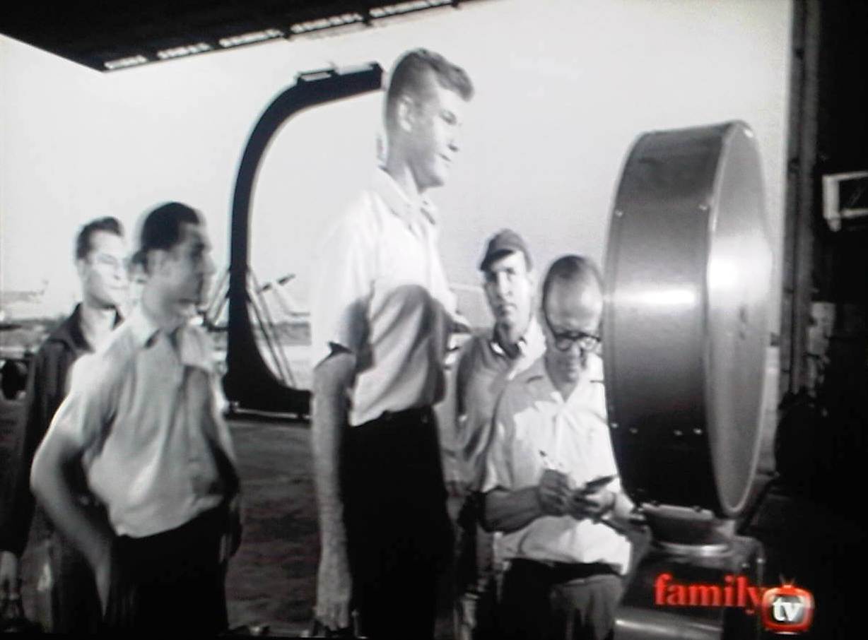

Well, it took a while to repoint this dish but I finally got it pointed to 137W - - - it is not quite zero'ed in yet but I got about 9 channels right now.
The dish elevation now reads 15.2 degrees above the horizon - - looks even more like its looking into the ground.
I think this was a really good choice, thanks for the suggestions! I like this MyFamilyTV,

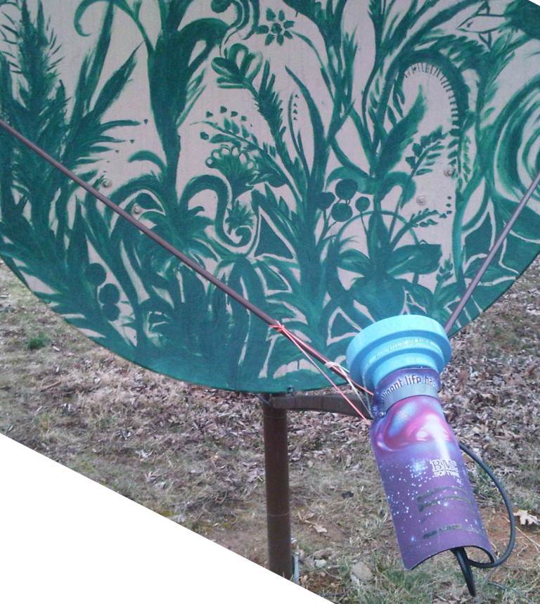

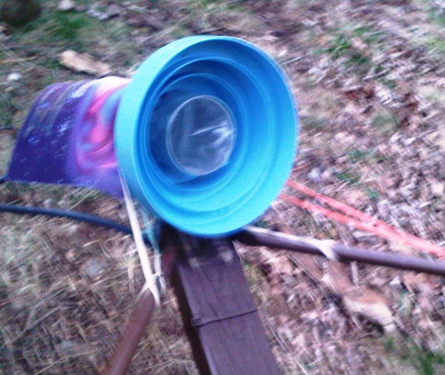

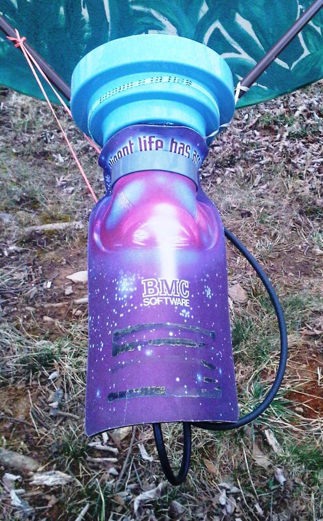

Conical Scalar really helps
I never had purchased a Conical Scalar for this 6 foot dish - - - but Corrado had suggested I try one for better signal.
I found one online for about $13 so I got it and tried it - - - WOW - - - these make a big difference (at least with a 6 foot Prodelin)
Took a while to find the sweet spot but my signal for 137W went from about 55 to 70 on my S-9 Openbox. It now scans in 12 channels, including the Alaska channels Ice was talking about.
The rubber-bands were just to hold everything in place until I got it strapped down.

so is the conical scalar somehow better than the generic flat ones?
I don't know why it works but I had a flat scalar on this offset dish before and could never get this high a signal than with the conical scalar.
From what I've read it helps more with an offset dish but I'm not positive of this.
Somehow the conical is able to reflect more signal into the feedhorn.
