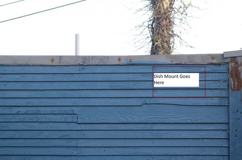

I am getting ready to install a FTA-KU Dish. I had a few questions and was wondering if perhaps someone could give me some tips and make sure i'm not buying the wrong type of dish/mount etc for what I hope to accomplish :)
My goal is to successfully install a motorized KU-Band dish on the side of our garage. Right now im in the getting it mounted in the correct orientation and properly to the garage phase :)
We are planning to mount it to the side of our garage (photo is below links) I;m concerned about the mounting brackets and whether or not its possible to mount a motorized dish mount vertically on the side of a building. Does it pose any significant challenges?
After googling till my eyes bled and reading reviews, I settled on the motorized kit #6 from galaxy marketing (I tried to post the link but I kept getting an error from the website :(
It looks like it might have a tripod mount (Can you mount that vertically?, Is there any issues with flexing( I hear dishes are pretty tempermental). Generally am i looking in the right direction?
I have attached a picture of the garage and a little diagram of where I am thinking of mounting it.

The mount provided with the dish is suitable for mounting a motorized dish as long as the mount and the support legs are properly mounted and secured to the wall studs.
Is the face of the wall facing South?
It is, I have just purchased the dish and LNB on ebay :) Thank you for the suggestion. Im also glad I found out they were out of businesss before I tried to give them money LOL. I will keep everyone updated once I have everything setup :)

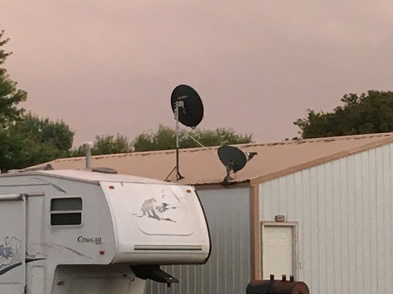

you will like that dish, I have the same one i installed just about 3 weeks ago. Wished id have asked questions and looked around more before i made my first purchase. Glad if my advise helped sway you a little bit it helped you from making the same mistake i did. Now you have your next big decision, what receiver to buy.
Also here is what i did to mount my dish to the roof of my shop, I used the mount that comes with the geosat pro, a galvanized fence rail coupler and a spare piece of heavy wall galvanized fence post which was exactly the same diameter as the mount. I bolted it all together then used the stabilizing bracket that came with the dish and made 2 more longer stabilizers out of 1/2 metal conduit.

with a motorized dish it is absolutely imperative/100% nessessary that your mounting post be 100% level in all directions, spending a lot of extra time ensuring this will prevent many possible head aches later, so take your time to make sure the post is mounted LEVEL and also very securely, as a motorized dish/assembly can be very heavy,
in the location that you have pictured i would recommend mounting a 3/4 to 1 inch thick piece of plywood onto the wall first, then paint the board using a good outdoor paint/protection, this will give you a nice firm and FLAT mounting surface for your dish pole, make sure the board is big enough to cover the entire mounting area of the pole,
