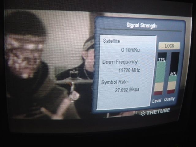

So i kicked it about 1/8 CCW looking at the lnbf from the front..ended up with this...
Goes from 42-49..

If that is an 80cm dish, thats about as good as you are going to get. I get a bit over 50 with my 90cm dish myself.

Getting about 60% on KUTF (11950)...about in line for the 80cm dish?
Is there a 2nd tube feed? Im getting it on 11950 v 26657 with like 63% Q...nice and solid. Channel comes up WPXS...sorry for the tons of dumb Q's. This is a big learning curve comming from just doing e* stuff :eek:
The Tube is also broadcast on a few other channels "Part Time" on the G10R satellite. You are now officially HOOKED :yes
The only two full time Tube feeds on satellite are the 11720 feed on G10R, and the 4040 feed on G3C.. anything else is gravy.
