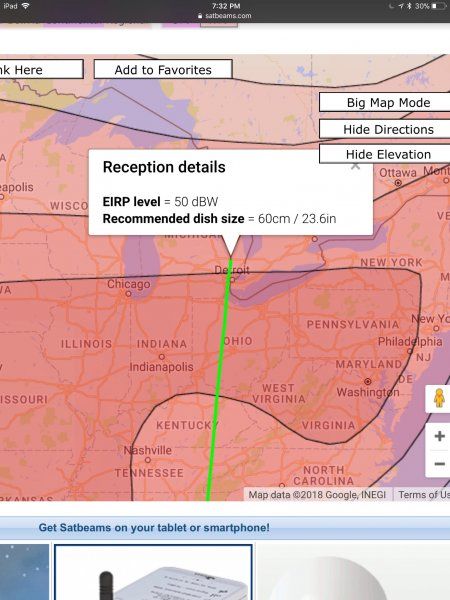

According to satbeams , I only need a 60cm dish to get 87w. Is sat beams even accurate? The cnn feeds would interest me. I have a 76cm.
According to satbeams , I only need a 60cm dish to get 87w. Is sat beams even accurate? The cnn feeds would interest me. I have a 76cm.View attachment 132093
I have seen posts from people who have had trouble getting 87w with a 90cm dish. I get it ok on my 90cm but there is no room for error. Always worth a try though. Titanium has been in the business a long time and he explained it best.
Satbeams site displays the estimated reflector size to receive a signal of a transponder operated at full power and a forgiving FEC. Usually an uplink is not operated at full power or with a low FEC ratio. Satbeams calculation for most satellites is over optimistic at best and doesn't show the reflector size required for reliable reception.

I get 87W good on a fixed 76 cm with a Avenger pll lnbf on it here in Ct. As Fta4pa said though, there's no margin for error. It's a touchy sat to get, you have to be spot on.

on 87W, with a 60cm I think you would get the MTA transponder as well as, probably, the CNN feeds. Louisiana PBS would be very difficult though - that one is much weaker.
