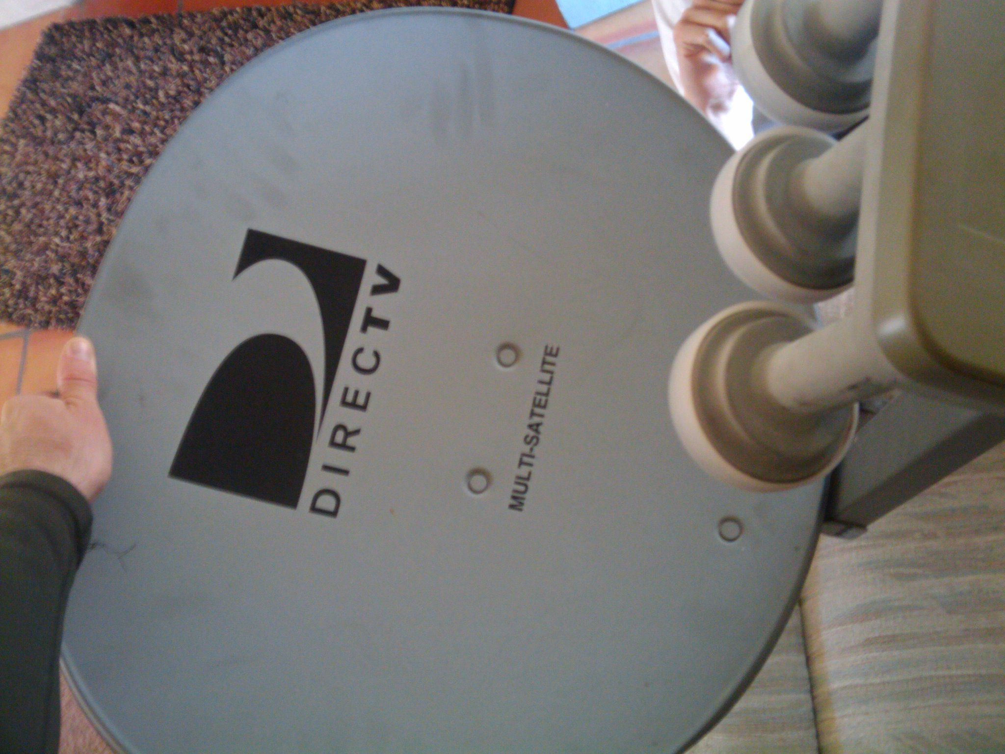

hello I was given a direct tv dish can I use this to get fta channels? if so what do I need to do? I have reciever no motor or pole attached is a photo of my smaller dish a sighted person took the photo fore me

hello attached is a photo of the small dish my sighted friend took

Yes, I know that dish well. It's a DirecTV Phase III.
Here is an old thread where I outfitted it with a linear LNB to receive Whitesprings (which is no longer on the air).
I know I'll get some flack on this but I consider it way too small for general FTA use.
As I mentioned earlier, if you had some single satellite feed in mind, one that was very strong, it would certainly work.
However, my conscience would nag me if I were to recommend using it to anyone just starting out.
. . . Somewhat akin to taking a bicycle on the freeway. :rolleyes:
