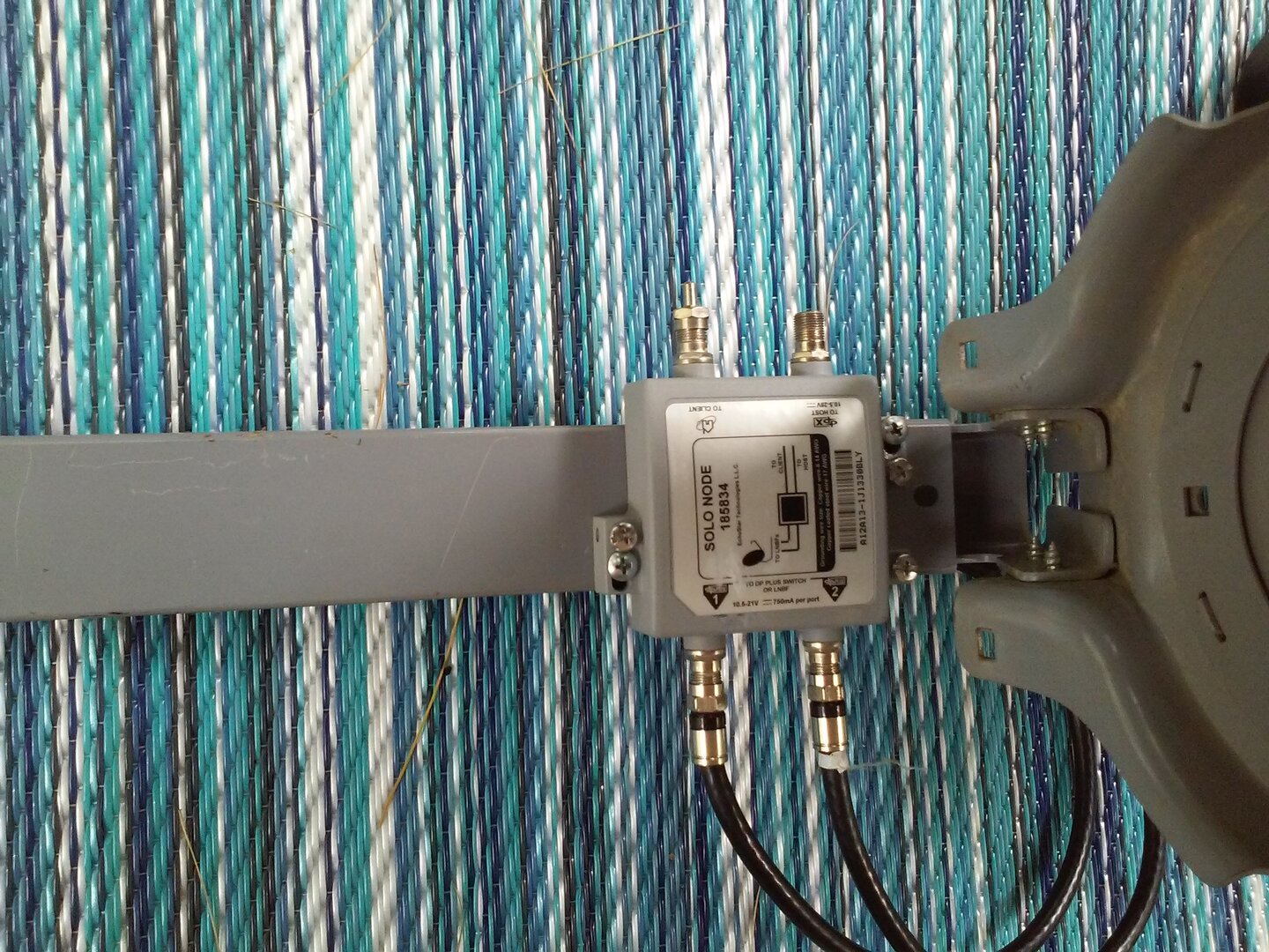

Of course they get all three tuners. The DPP ports are connected to a Solo or Duo Node mounted right at the dish, so only one coax is needed for the long run to each receiver.
Sounds good but those aren't Dish Authorized installs. They want connections on or in the house near a ground point
Dish hasn't authorized any of my installations. Dish probably doesn't like that I take one of my 1K4's apart and move it from campground to campground either. :)
Here's how the Solo Node is attached to my portable 1K4:

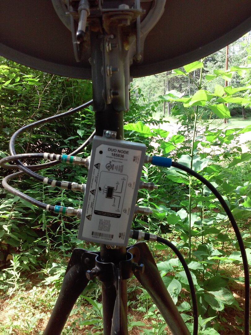

And here's the Duo Node on the permanent 1K4 at our family cottage. When we're there with the motorhome, the top right coax feeds the motorhome's H2, and the bottom right coax feeds the cottage H2.
Before anyone mentions it, the cables from the LNBF have been re-oriented to add drip loops since the photo was taken. ;)
