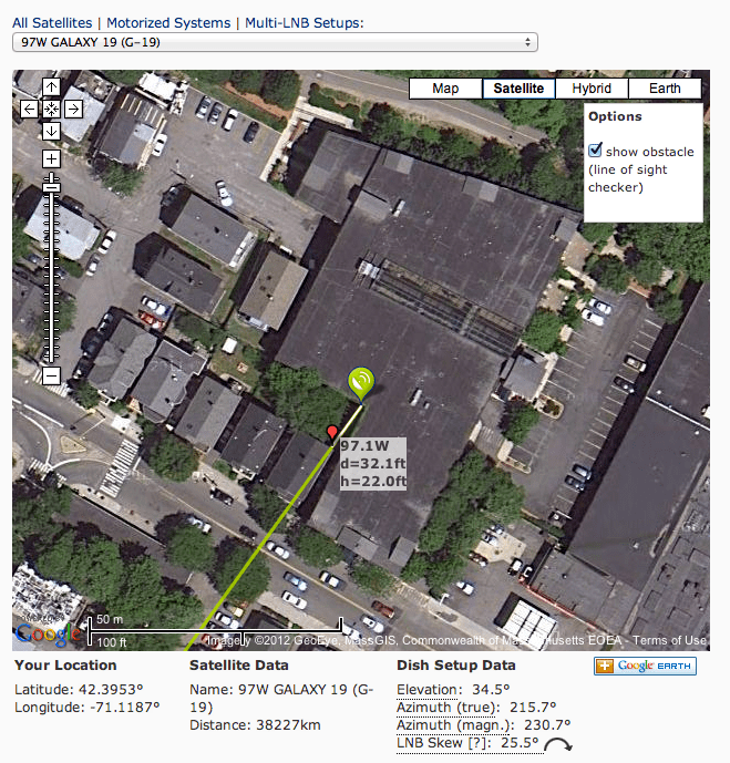

I think I have bigger problem. Having zero luck with finding any signal on any satellite. That house that is 31 feet away from the antenna might be killing my LOS.
Where are you located? A house that is 31 feet away might be an issue, but it depends how far North/South/East/West you are for aiming to the desired satellite.

Here is where I am at:
And here is what it looks like from my top floor balcony:

Based on what you are showing, the house should not block the signal. Dishpointer indicates a 22-foot obstacle would block you. But that is measured while you are at ground level. It looks like you are at least one storey (10 feet?) high. So from your balcony, you should be able to see the sat.
Do you have an inclinometer? If that picture is from the dish's location, sight the top-center of that hip roof, looks to be below the satellites elevation in picture(but ??) If it's in the LOS, non-pen on the roof??

I got absolute nothing. Not at any point did I get even a blip. Hours and hours of tweaking. Landlord is a lawyer, so he absolutely does no want anyone on the roof (even though it is flat and all), and I got no way of testing if the house is an obstruction or not.

Elevation supposed to be 34.5 degrees. Does look damn low and I guess angle finder won't help me there.
His dish pointer data posted above calls for 34 deg elevation. Looks to low to me too.
Also says 25 deg right hand skew, looks left in the picture.
I think that dish has about a 23 degree offset, so if you placed a straightedge vertically on the dish you would want to read about 15 (14.5) degrees of tilt. That should get you close for elevation, and dishpointer.com should get you real close on your azimuth.
