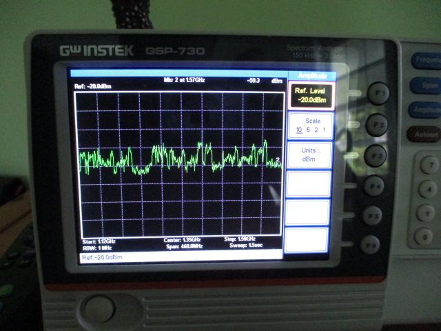

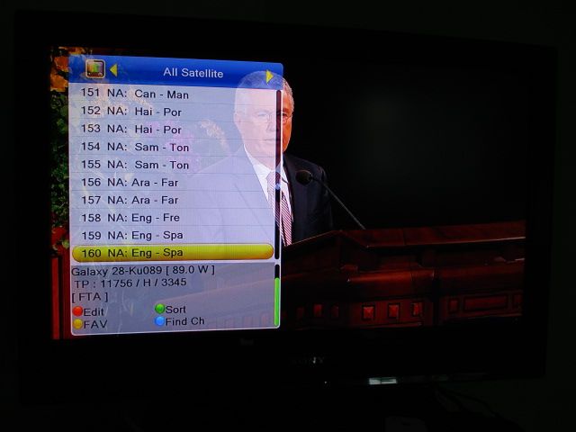

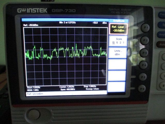

I use a 39 inch motorized dish and did a blind scan, got about a dozen TP's but no FTA. However I did a TP scan individually and found attached. I've seen these channels before though. Lyngsat has them as LSD Church. Also attached are scans of V and H TP's so there is activity.
Maybe more feeds will turn up.:bounce
