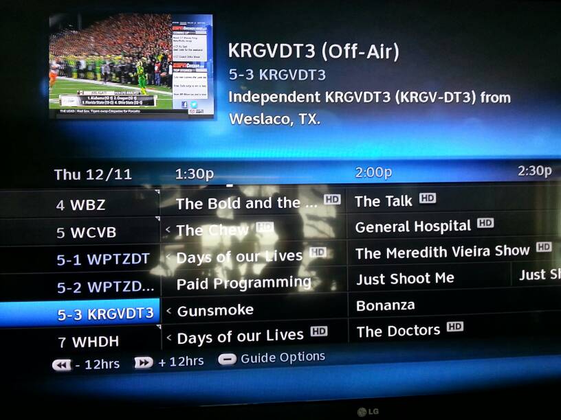

Yes, and you can usually fill in missing channels with subchannels from different zip codes. I am missing 5-3 MeTV from Burlington/Plattsburgh. I put a zip in Texas and it added 5-3 to my guide, and it's another MeTV.
That would get MOST of them, not all of them. I did that and am still missing channels 18.99, 58.6, & 58.7 in my area. 58.5 showed up but doesn't work being that audio-only OTA channels don't work with DirecTV.
