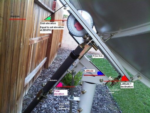

Pictures plz. Might just need a longer bolt, or you're measuring incorrectly. Reference attached picture. (angles at your Zenith satellite)

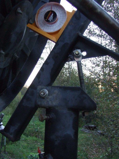

This is how I am measuring the elevation. The dish was set up a couple hours north of me so I am not sure why the bolt would not be long enough. My actuator has not moved the mount to the top of its arc yet. Could this be the problem?

That angle should be your latitude, (as shown in the picture I attached)
If the face of the angle finder that's attached to the polar axis, were horizontal it would read "0" and increase 10-20-30 etc.
If when horizontal it reads 90, you'd subtract 90 from the reading.
Your modified declination at latitude 55.71N should be about 7.4°
Dish 'look angle' at zenith is 90 - lat - declination.
90 -55.7 - 7.4 -26.9
Pretty close to your desired 26.4. Minor adjustment of the latitude angle is all that is necessary.
