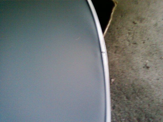

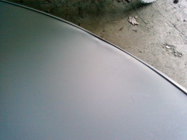

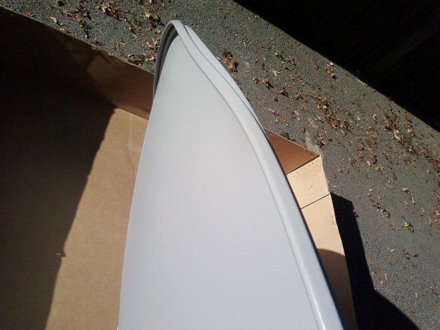

After months of procrastination, I finally decided to setup my motorized GeosatPro 1.2m Dish with a DG380 motor yesterday, and to my disappointment and anger my Dish had damage at the rim (edge) during shipping. See photos. I know, I should have opened and checked the package when it arrived months ago, but I didn't. And it's now too late for me to ask for a replacement, since the shipper's 30days insurance claim of goods damaged during delivery is now long gone.

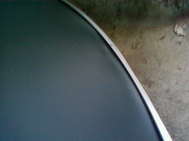

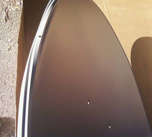

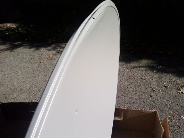

Now, I have tried to fix this damage to the best of my ability (see photos), but I'm worried that I may have problem with this dish as it regards signal quality due to the damage. Am I right about that? What would you suggest I do to effectively correct this rather unfortunate problem short of buying a new dish?
I will update this thread as the setup progresses.

Babadem,
That does look pretty bad, but it seems to be limited to the rim of the dish. Lay the dish flat on a good table (a nice glass table if you have one) or a good solid work bench that is large enough. If it isn't warped and the damage is just to the rim, you can still use it.
If otherwise, contact the seller and the shipper (even though it has been a long time) and see if they may still honor you with some warranty or maybe a prorated replacement. It never hurts to ask them, they might work with you towards some reasonable assistance.
The damage looks odd to me, though. One of your pictures makes it appear that it was formed that way. The others make it look like it was dropped very hard on the edge. Ouch!

After trying to fix it, I did the string test and it appear to pass, but I'm yet to find a flat surface to test it further.

I hate that happened to you. If the dish is not warped it will work fine! Maybe you know someone at a machine shop that wouldn't mind straightening the edge out for a small fee or just to help you out.
If you can mount the dish level horizontally, temporarily plug holes and slowly fill with food dye lightly coloured water at the centre you can see the distortion as it fills and plot it with a pencil. I think you might be surprised how little it is. I've found dishes up to 1.2 don't distort too easily.
I don't like the idea of pounding it out if you don't need to.
So I guess a String Test is in order.
Try to get a 90 degree/Plus mark test away from the damaged part.
If they touch, you may still recover part of the reflector.
I'd try to set it up as a fixed dish and see how it performs against a known satellite another dish, if you have another.
It's big enough that you may be reduced, but still have the adjacent signal rejection.
Lemonade, if you will.
RADAR........see my responses in blue above.
Babadem,
Have you spoken with UPS yet, just to see what they might say? I know it sounds like a long-shot, but it is worth a try. Otherwise, you will just have to make do and straighten it the best you can.
I had a 76 CM Winegard dish that had a bent rim a while back. It wasn't as pronounced as yours, but I was able to bend that area of the dish by hand and make it work reasonably well. I think it suffered the damage when I had it on a portable tripod and the wind blew it over one evening. I couldn't tell the difference between the operation of the damaged dish that I repaired and a brand new one that was in good shape.
The damage to yours may be a little extreme. The structural area of the rim is really messed up. That may prove difficult to remedy (sorry). You would really need some sort of a jig fabricated to mold it back into shape. Or at least nearly so.
I would do the best you can to straighten it and then simply try it out. It may not operate as bad as you think. Only way to know is to give it a try.
I would set it up as a fixed point dish to test it out. Dial in some of the really strong birds at first and see how they all respond.
Sometimes this stuff just happens, hopefully you can salvage it and make it work acceptably. I will wish you a good portion of luck for that!
