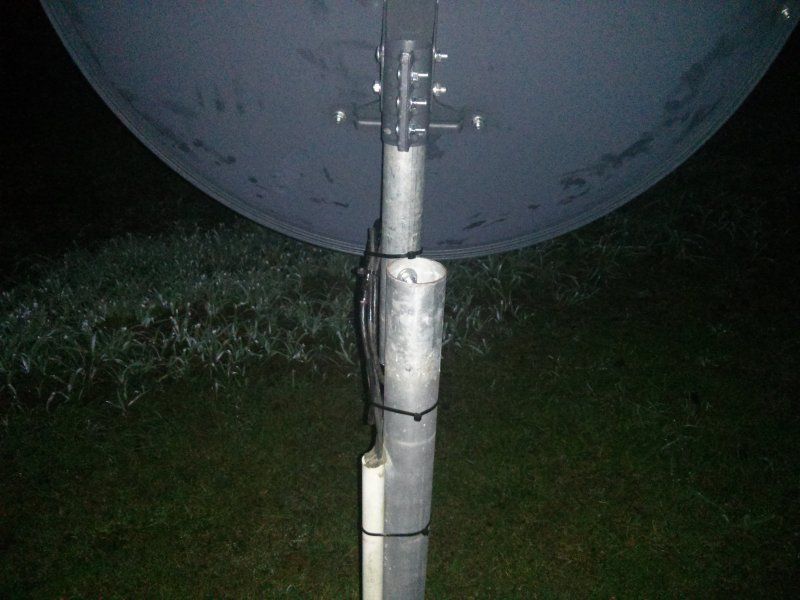

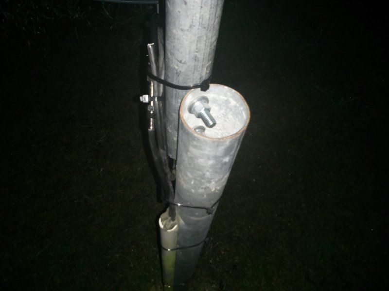

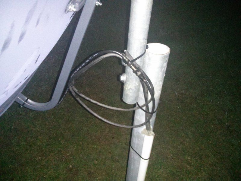

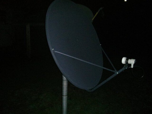

I managed to bust up and remove enough of the cement from the top end of the pole. Then I bolted a 1 5/8" pipe on the side, which turned out sturdy and worked out well. Anyway it's all installed and working now. I still have the 2" adapter for the pole if I ever want to put a larger dish on back on there, and move the 36" onto a 1 5/8" pole. Thanks for the suggestions everyone.

You know I actually started to snap some with the phone, but I didn't. But anyway, it works and it's stable, that's what is important.

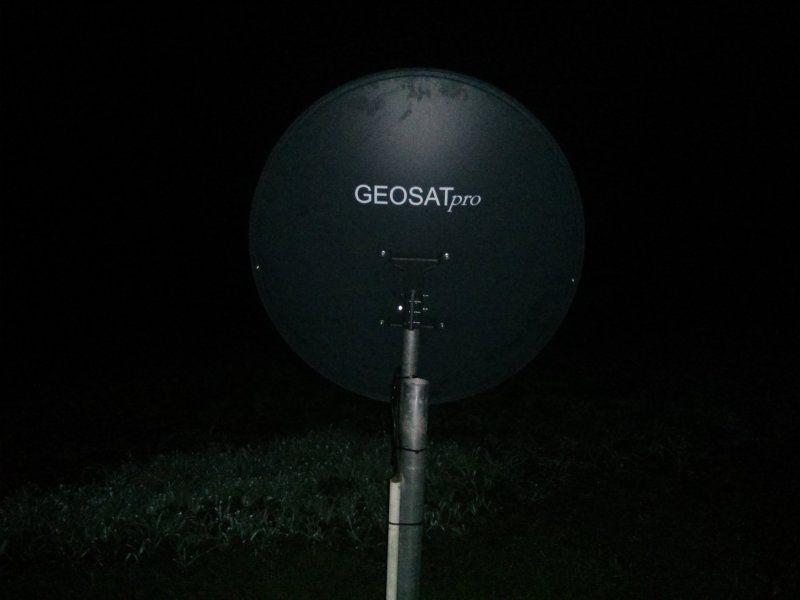

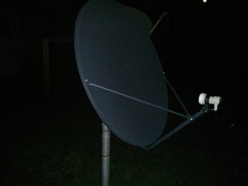

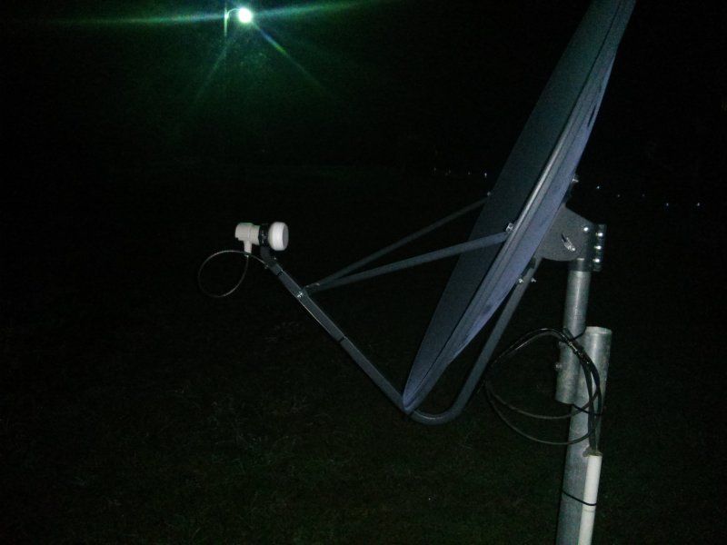

OK, here are some pictures, at night though....
