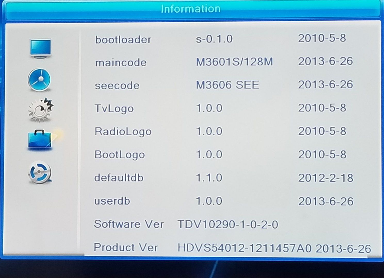

Added: For reference, attached is an image showing the versions of what I'm using.

I just dug the MicroHD out of mothballs and wanted to see if there was any updated firmware.
Like others, I had a boot loop issue from having deleted transponders but not deleting the satellite. I ordered the serial cable and discovered that some of the pins needed to be moved to the right sockets. I had a cumbersome MS Vista computer at the time. It was a great learning experience and I'm glad I don't have to relearn it.
Mine seems to be working well and has the exact same information screen as posted by Cyberham, so I think I'll not try to upgrade firmware.
