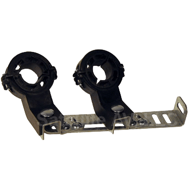

The GEOSATpro 4 degree dual LNBF rotating clamp is a unique and exclusive design developed by Satellite AV to be specifically matched with 2 - GEOSATpro SL2 Bullet LNBFs and the GEOSATpro 90cm Satellite Dish or equivalent OEM dish manufactured by Azure Shine. This special bracket allows for precise placement of two LNBFs to optimize reception from two satellites. Perfect for receiving the international Lao / Thai channels from both satellites SES1 and Galaxy19 or any other two satellites separated by 4 degrees using a single dish!

Edit: Is this the one you are talking about? If so I have used this one.

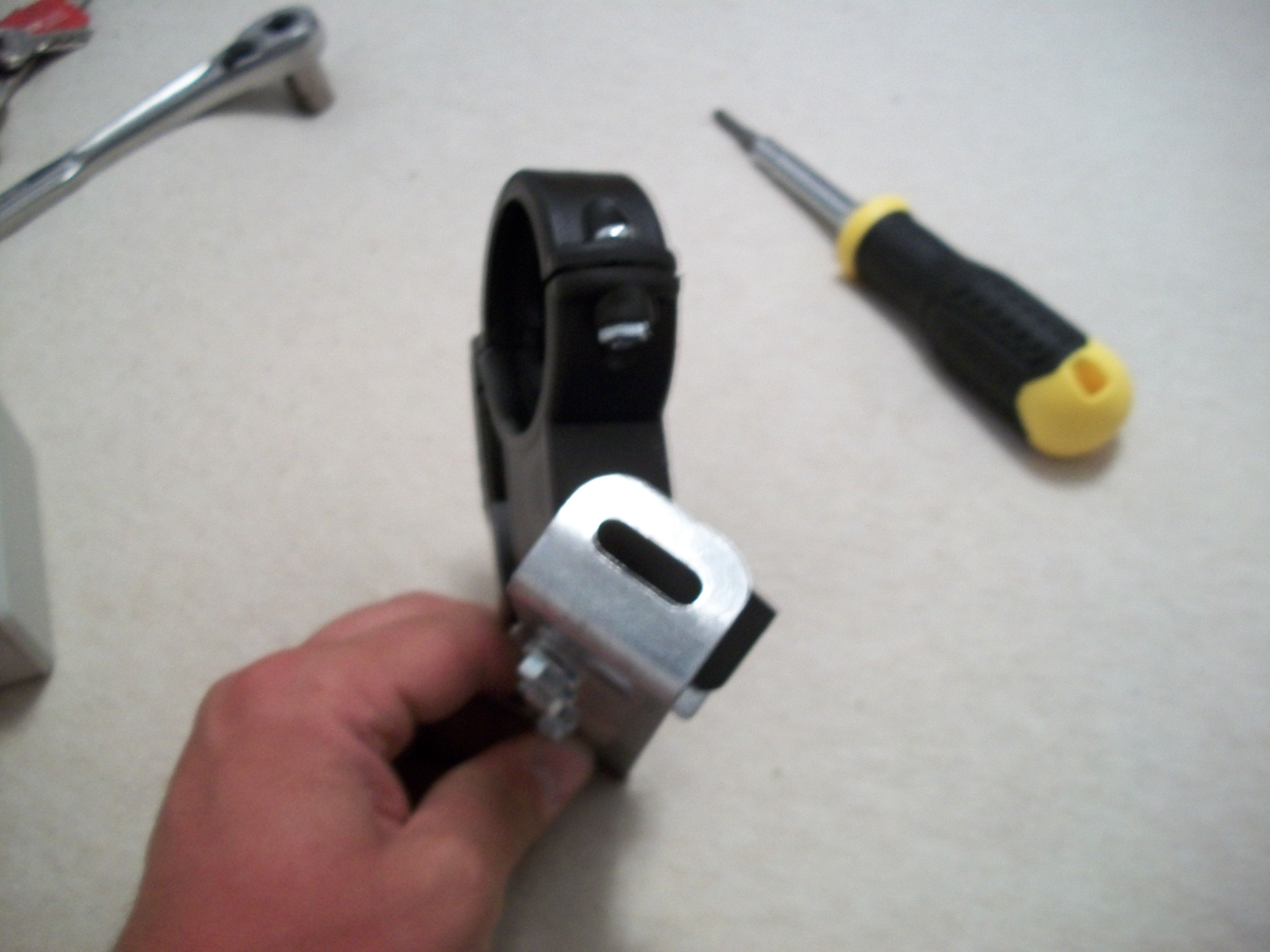

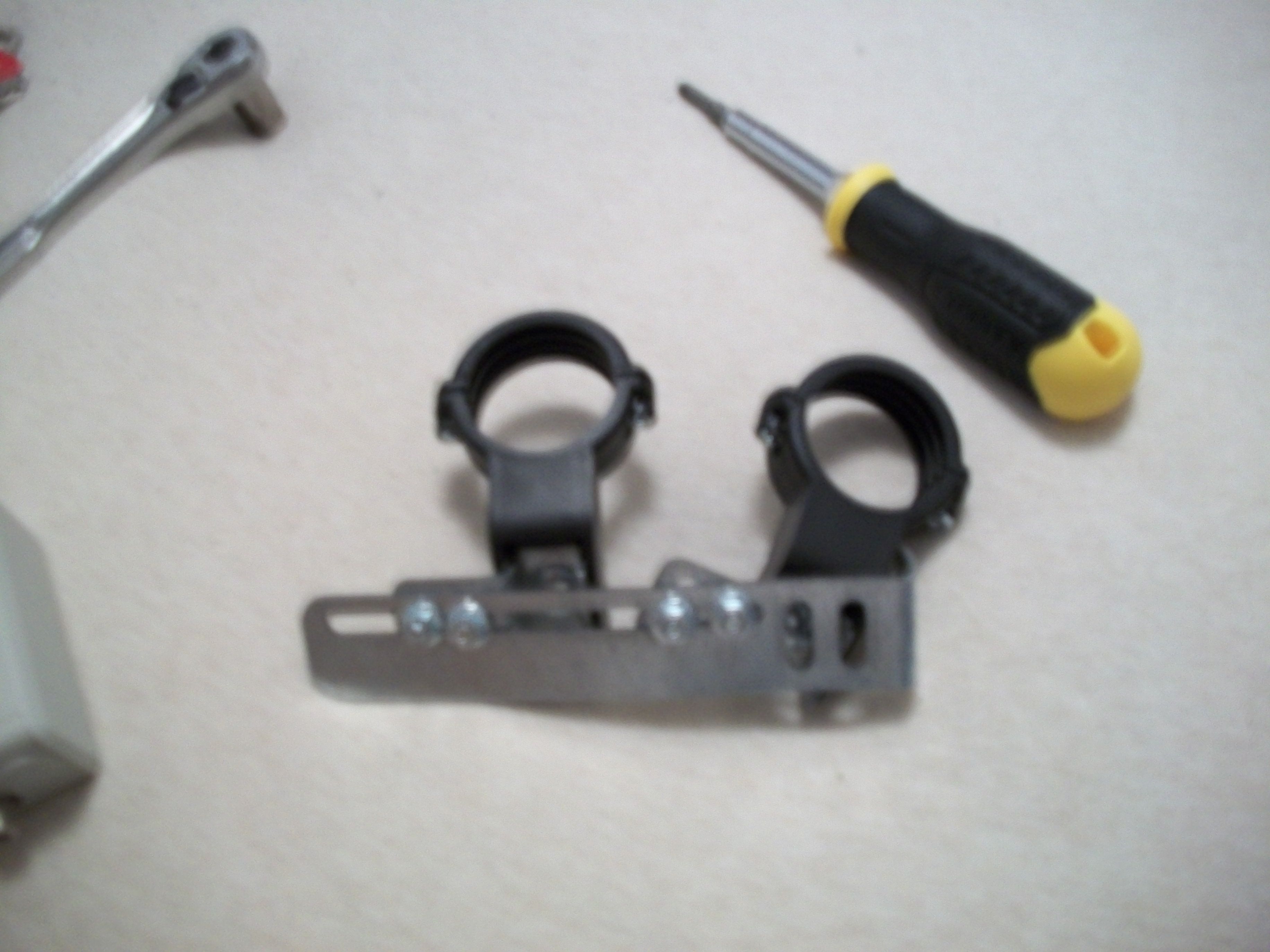

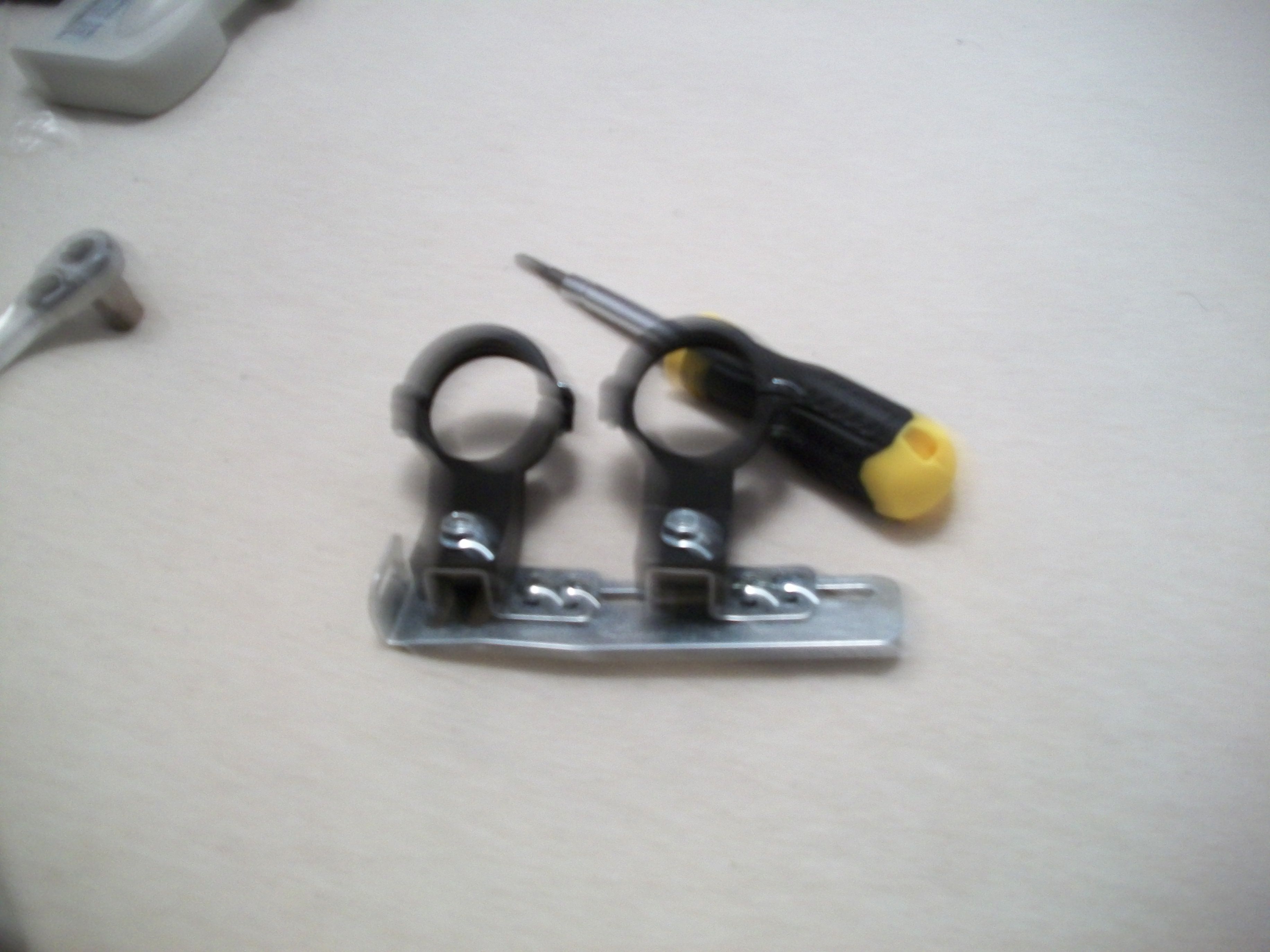

If anyone is wondering what it looks like i have some pictures to go with this thread and i you can get it for for less than $25.00 and most FTA Satellite online retailers.

See above, That is the one I used on a GeosatPro 90cm without drilling. it was not that easy to setup. It looks like some of the homemade brackets on this site with full independent adjustability in all directions would be easier to setup, but yes you would have to build it first.
