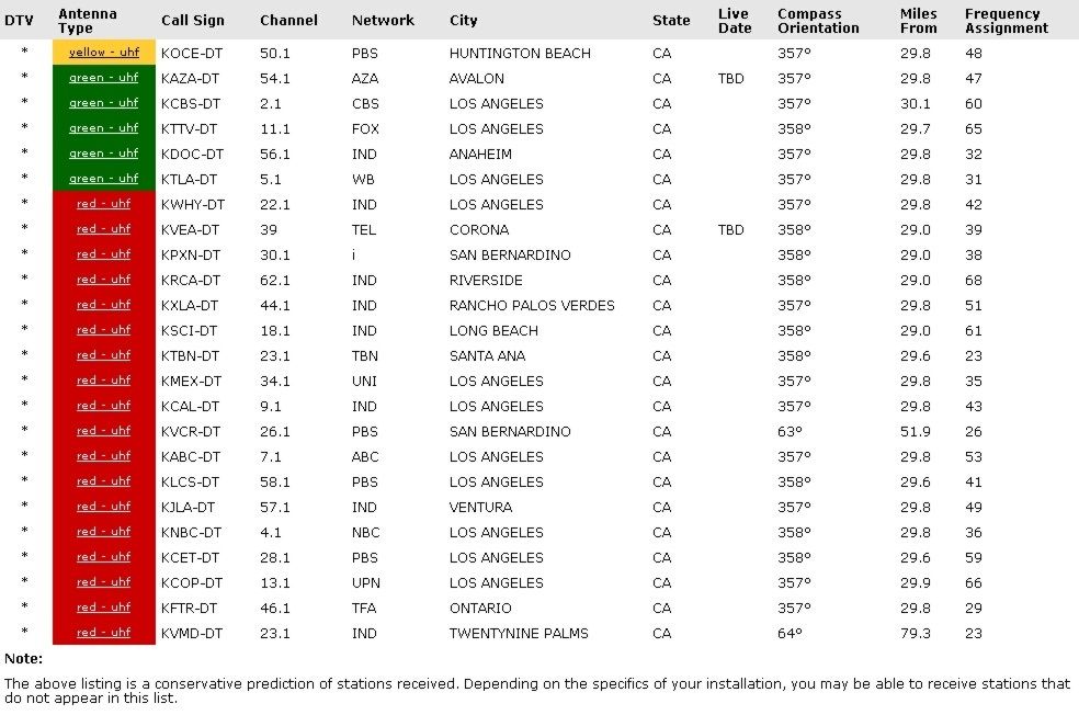

It does get confusing with the duplicate cross posts of the same exact request, but I did go ahead and copy my same reply from the other thread.
Do you have a ATSC HD tuner at all? In the TV or set-top box?
If you do, I am willing to bet good money that 1) the antenna you have is not worth its weight and 2) that you may not be aiming at the correct heading 3) both.
Attached is you area's DT info (I had to make up an actual zip as yours was missing a digit) I would look into one of these antennas as a replacement and make sure to aim toward the correct heading.
Channel Master CM 4228
Antennas Direct DB8
Winegard PR 8800

In LA that is really not an unreasonable expectation. In Moreno Valley, about 50 miles or so out from Mt. Wilson, a small antenna is usually all that is needed. Many people use a single element corner reflector for UHF and do just fine with all of the digital channels, except maybe KCOP-DT which is not at full power yet. I can pick up most of them myself with a small indoor antenna placed on a high shelf (tried it just to see if it was possible). Most of the valleys and just about all of the LA basin have an excellent line of sight to Mt. Wilson. Many people in Santa Barbara and San Diego can also pick up LA stations OTA, and they are over 100 miles away.

I am not familiar with DirecTV's channel numbers, but that may be what KABC was referring to. They broadcast their digital channel on UHF channel 53 but when an ATSC tuner finds it it should display as 7.1. From the information you provide it sounds like your DirecTV tuners will not tune in the satellite HD channels as they are SD only. They do not have built-in over the air ATSC tuners so you would need to rely on a tuner built in to your TV or a separate external one. If you can tune in anything with a half-way decent picture on channels 22, 28, 34, 44, 52, 54, or 56 you should be able to get the HD channels as well, as long as your tuner can receive them. Yes, the Terk clip on antenna is usually not a good choice. In close-in areas such as yours with high signal strength you could easily use something like the Channel Master CM3677 or Radio Shack VU-75XR. The CM should be available at Fry's or some Home Depot stores. You may also find it at ITC Electronics if you have one near you.
