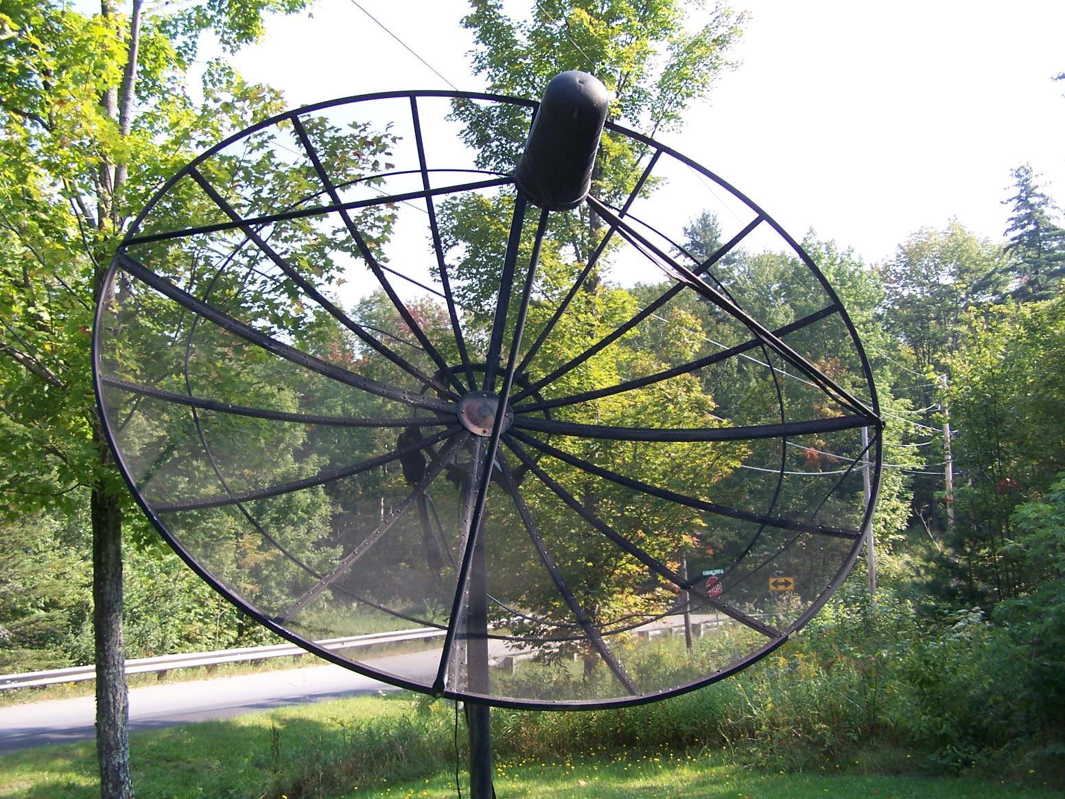

Hi ,I'm very new to this having just found out anythind about FTA on Saturday!My husband and I live off grid in Vermont and this seemed a good alternative to spending lot on Channels we won't watch.I'm picking up my dish on Saturday and bidding on a coolsat 6000 so I may have both on sunday!(not counting time for shipping).The Dish is a channel master mesh so let me know what you think.I'm adding pics.Thanks :o

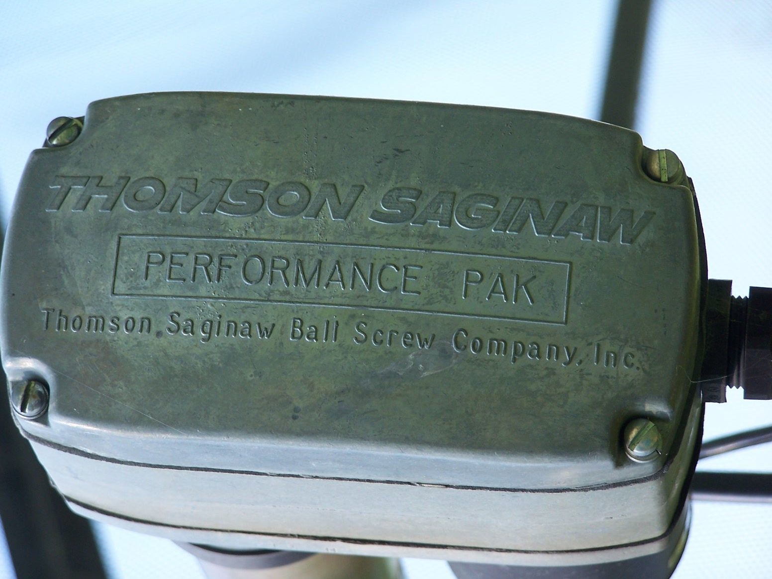

Great actuator, my Thompson Saginaw 24" is still going strong after 19 years. The Channel Master looks good :)

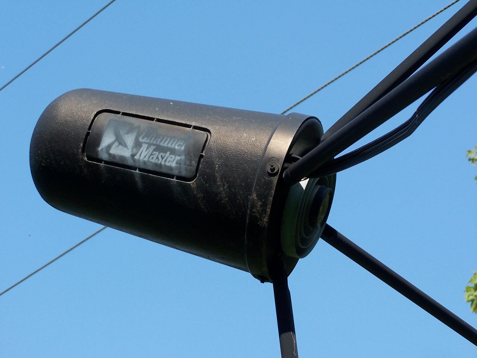

You might take off the LNB cover ( the small trash can in your last picture above) and give us some pictures inside.
Be careful of any wasps, or other resident bugs.
Look also directly into the open end of the feed horn (as viewed from the dish), and let us see which model/brand you have (and any more critters).
There may be a two or three inch removable cover.
Let's see inside.
We'll be able to tell you if it'll do Ku, too. ;)

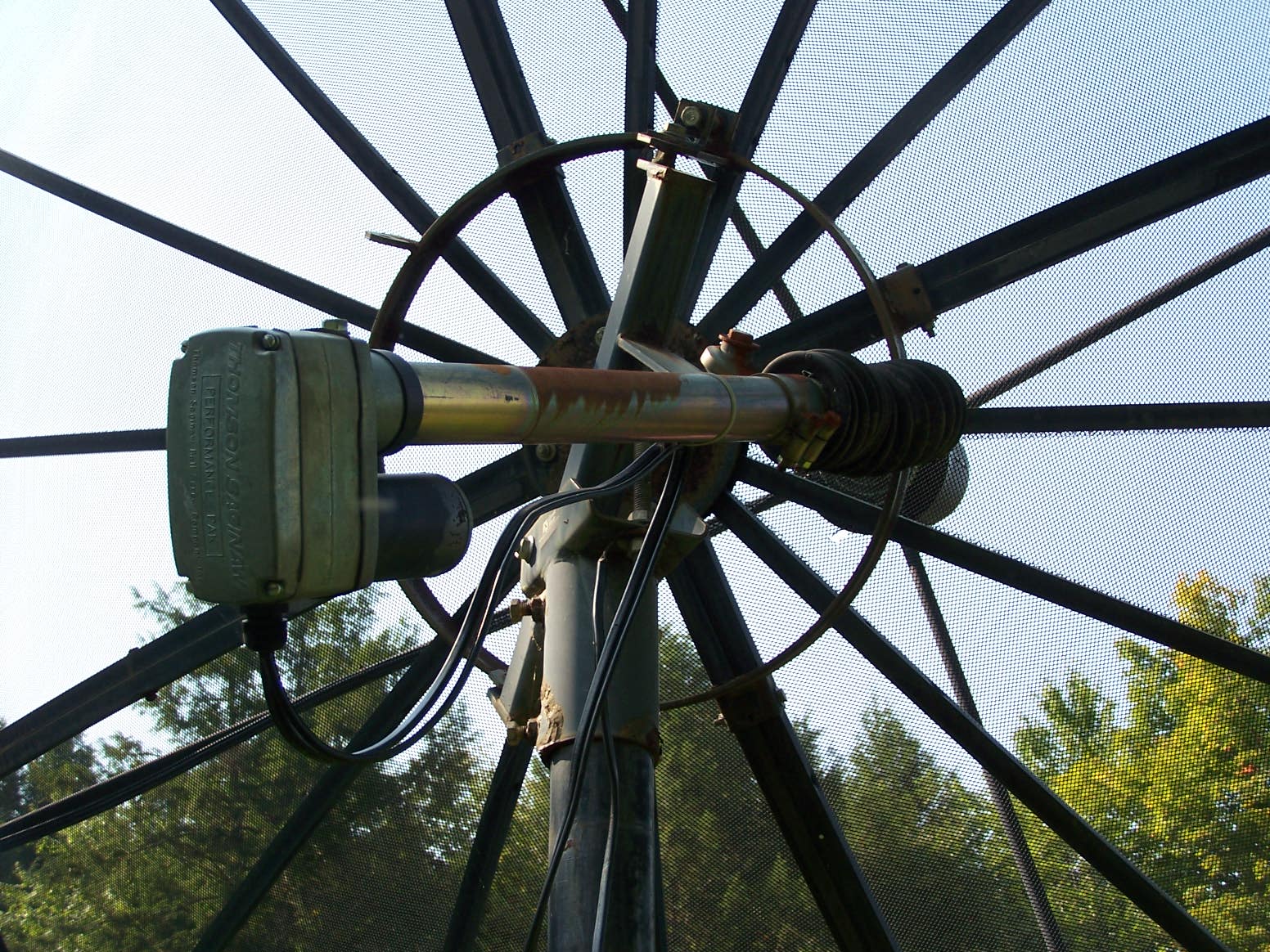

Are you getting any old Analog or 4DTV receiver with the dish?
Perhaps a 920 or 922 4DTV receiver?
Reason I ask, is any of the above will move the motor to swing the dish.
Lacking one of those, we might recommend a thing called a Vbox or a Gbox to do the job.
Also, the feedhorn most likely has a little blue servo to change skew and switch between horizontal and vertical transponders.
An analog or 4DTV receiver would be able to control that servo, too.
There is a new product coming from Sadoun in about a month which combines the Gbox and Servo control, but we haven't seen the first unit yet.
Another solution would be to replace the feedhorn (all the hardware in that LNB cover above) with one that's voltage controlled for Vertical/Horizontal switching.
Your Coolsat will handle that task just fine.
However, it's way too early to be making any such suggestions into recommendations.
Let's see what you've got. What you want. And what you can get, hardware wise. ;)
The person said he installed the dish in 92 and stopped using it in 98,it was installed for him and all the connections look to still be good. the boot on the motor is still intact.Should I try the old feed horn or just get a new one? Thanks

Welcome to the world of FTA and the C-Band Discussion section kzinbastet. That feedhorn should do, so try it to start with. Once you get the cover off and some pictures, we'll know what kind it is. Without an analog receiver, you'll need some kind of dish mover to operate the Saginaw. Now-A-Days, we FTA'ers find a cheap analog receiver or get something like a V-Box to use with a DVB receiver. Good Luck on your dismantlement and moving of the dish...!
first let me :welcome you to the group
great bunch of folks here , we all love c-band and try a lot of different things :) to save our dishes. some have only one dish others have several dishes.
most likely the feedhorn will work :)
take a compass and write down the degree the dish is pointing at.
if you need the pole, get it. dig slightly on one side and you can probably push it over with a truck bumper. knock the concrete loose. ( if your in a northern state a little more work might be involved)
if you can back your truck under the dish , you should be able to set it in the truck
the dish probably isn't too heavy usually they are just big and bulky ( but you have to remember that most of it is made out of lightweight aluminum.
good luck and post back if you have questions

You disconnect the motor from the back of the dish,
... take the dish off the mount,
... then you probably take the mount off the pole, (need side view pictures to advise)
... then you dig the pole out of the ground,
... and bring home the three pieces.

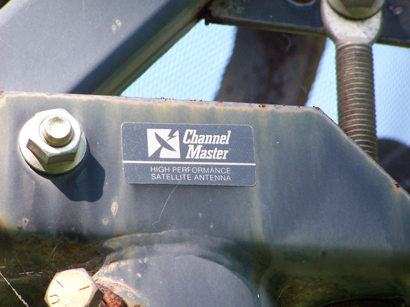

Hi Kzin, Thats a great find an that CM is their last model before they shut their plant down where all mess dishes where made. you can tell by the reflector is drilled to take a 32 inch back fram, bolts are missing where the larger back fram bolts just about 5 inches out from from the back fram mounts are now. an it has the larger diamter legs. now if it has a Channel Master feed you need to keep the scaller ring an use it for any type of feed that you will put in it, the reason why is the dishes legs (that bolt to the scaler ring) will have 8 bolts that holds the scaler to them, not like a chapperal scaler ring it will only have 4-bolts, that was 1 of CM ways to make that dish more riged. but all in all thats dish is in good shape, an I can go on an on about CM an their dishes, cause have worked with just about every model they have made since 1981, an have nothing bad to say about them at all, they have built a very fine product.
Now when you start to set that dish up you will find that the gain on that CM is far better than any other mess dish out their, the only dish that is equal to their gain was a Sami, now the Orbitron was close to it but the CM perform better on signal, now years ago when I worked with these dishes I used a IF sniffer to peak them in, an with that you could always tell what dish manufactor was better for signal. also that dish will play Ku-band great, I got 2 CM-10 footers here an both have Ku on them.

That dish is virtually identical in design to my 7.5' KTI, even to the scalar mount, the way the LNB cover fastens, and the molding of the LNB cover itself. The big difference is the polar mount design. My dish has been performing great for more than 15 years. When I moved to a new house 5 years ago I brought the dish along, sitting up on edge, in the bed of a box trailer but a pickup bed would work just as well. Keep in mind that it acts as a large sail when being transported so strap it in good and take your time. Put on the 4 way flashers and try to keep your speed under 25-30mph.
