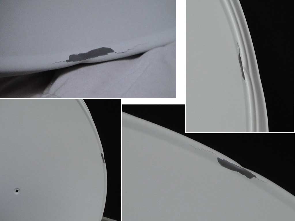

Actually, I got it yesterday.:D I was just too busy looking through everything to make a post. The only bad thing that has come up so far is that there was a big gash in the box and sure enough there is a dint in the rim of the dish and the paint is chipped off there. So thanks for that UPS. :mad:
But luckily it does not appear to alter the over all shape of the dish or the inside so I think it will still work fine. I'll try and post a pic of it tomorrow. I think I should cover the area where the paint came off with something to keep the metal from being exposed right?

Here are the shots of the dent.:( I am thinking I should feather sand it and cover it with either a silicone or an acrylic clear sealer to protect the metal. What do you guys think?

Sand it , prime it with good primer for metal and paint over it. Lucky they didn't do more damage than that I guess.
Will do...

That ding should not affect your signal, since it is past the reflective area of the dish. Just make sure the dish is not clamshelled (warped) by laying it on a flat surface. Do paint the affected area, as corrosion will begin if you don't. Use a flat paint, not glossy.
