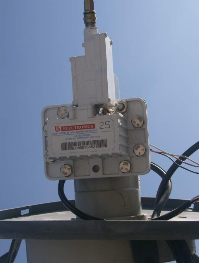

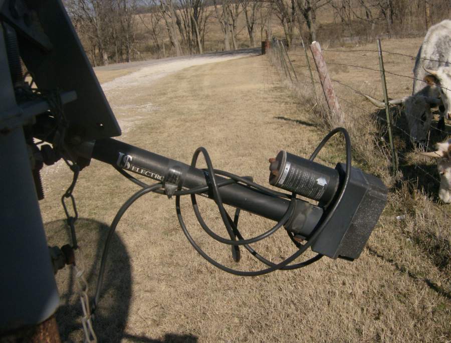

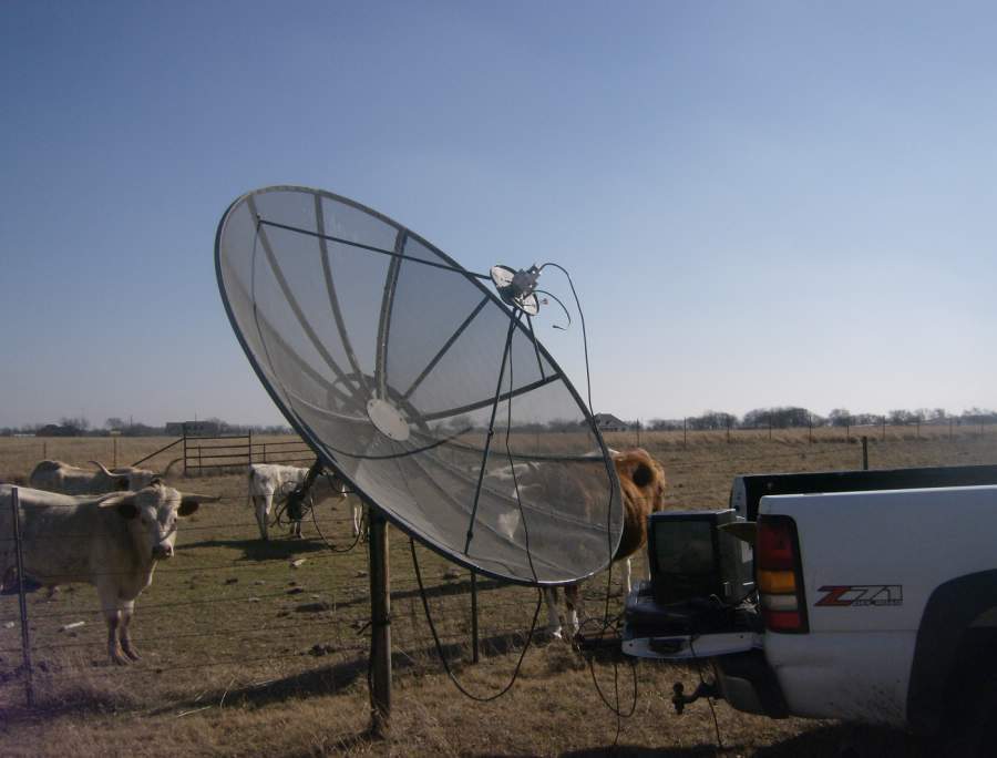

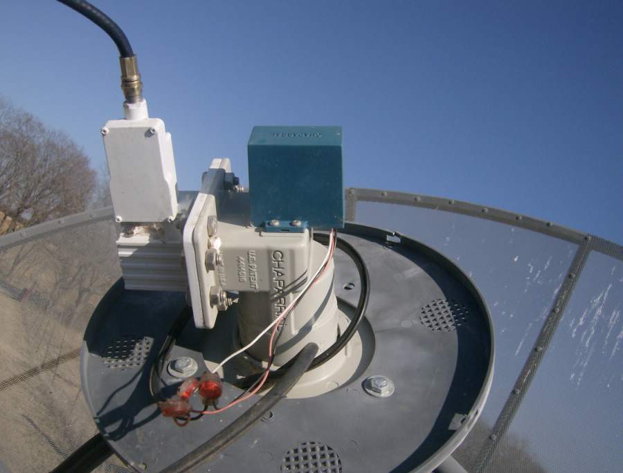

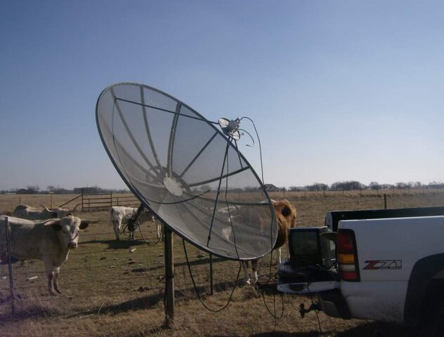

Okay. I finally got some pictures of the big ole dish. However, I'm not sure what I am looking at. I couldn't find the receiver that came with the dish, so I used an old dish network receiver to see if I could get anything. Well, I got nothing. Nada.
Is there a way to test this thing out w/o a receiver? A signal strength meter; maybe?
I'm currently looking at HD receivers and possibly a T90 dish to get going now and then figure out what to do about the bud latter. I'm still trying to figure out which channels I want, but it seems like there are 1000 satellites out there and each one has at least one good channel on it that I want.:D
Also, the HD receivers that I've looked at don't have connections for the motorized arm on the dish. Will I need to purchase something else to drive the dish?
TIA
looks like a C-Band only dish
Dish Network receivers use different type of LNB's so it wouldnt work on that dish
unless you have a signal meter (or a spectrum analyzer) you would need a FTA receiver to see if the LNB works
TIA
Almost all the receivers out there that do FTA wont move a big dish. You would need something like a V-Box to move the dish. Or if you can get your hands on an analog receiver that would move it too (the V-Box might be easier)
that is the polorotor. The older LNB's had 3 wired to control polarity. There is only one notch in there for polarity and when you switch polarities (from V to H) the receiver moves the notch 90 degrees
The newer LNB's dont need those and the receiver changes the polarity
The Geo Orbit site has pictures of all the pieces, with descriptions.
It might help you identify what you've got, there.
I'm no expert on mesh BUDs, but is that a Weingard Pinnacle?
Don't see anything in your pictures that'd discourage me from harvesting it if it were near me! - :up
The nameplate says SAMS; and no, you can't have it.:)
