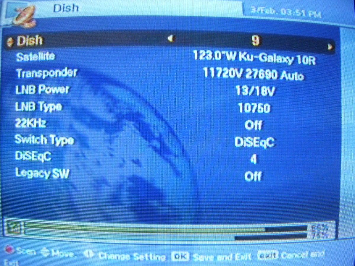

The 8000 has a different menu structure
setup would be
dish 1 (2,3,4 whatever you want the satellite to be)
satellite IA5 (T5)
transponder (make sure its an active one)
LNB power-13/18v
LNB type 10750 for KU side, 5150 for C-Band
22k off
switch type Diseqc (if you use one)
diseqc 1,2,3,4 (whatever port its on)
