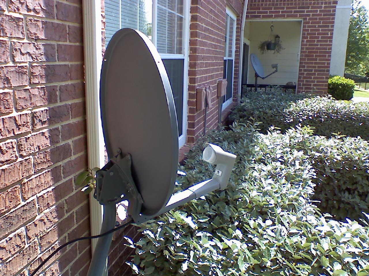

Since I had an extra Dish 500(DP) I decided to set it up to point at the 61.5 which was done successfully. I then ran a feed from the 500's 119 output to the "lnb in" on the 1000.2 antenna.
Now how do I get the 1000.2 to recognize that 61.5 is now wired in?:confused:

you have to use a DP dual or single lnb not a DP twin or DPP twin. The direct lnb's would work on a legacy system (old) just not on a DP - DPP system

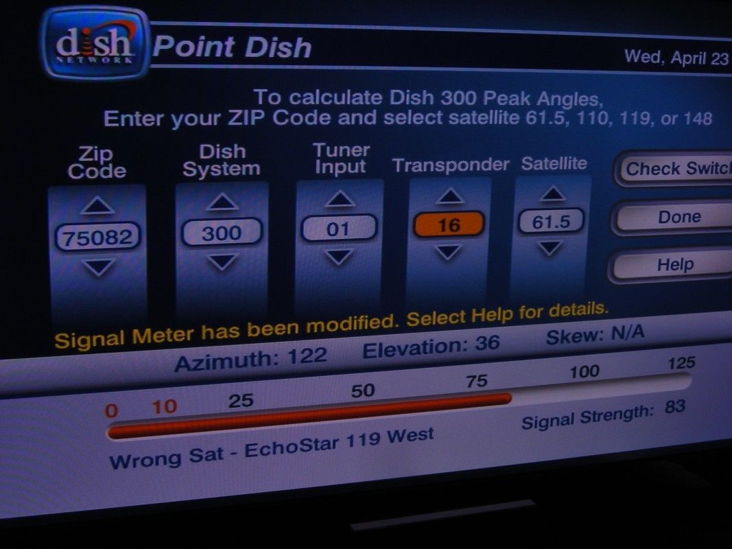

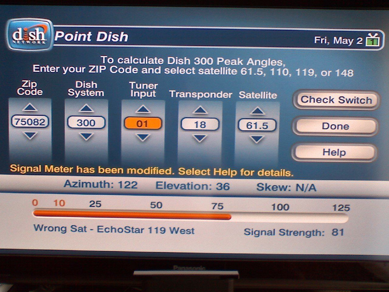

Alrighty,I got the I adapter and DP Dual assembled with the D500. I'm dead on 61.5 but get the "wrong sat-echostar 119 west" message. I ran the test switch and the 61.5 is still not recognized. I tested with the 129 lnb covered and uncovered,same result with wrong sat?:confused: help?

Note that transponder 18 is on 119. Run check switch... it should see the 61.5 dp lnb and list it...even if it can't find the sat. If it can't find the sat, try re-aiming the dish.
The Dual got listed but not getting any transponders by the x noted in the summary.

I don't think you have found 61.5 yet.
The first thing I'd do is disconnect the coax from the receiver and run a check switch to clear the switch matrix in the receiver.
Then I'd run a long piece of coax from the DP LNB on your 61.5 to your reciever and run a check switch. If using a dual tuner receiver, run to input 1.
Go into the point dish screen and select 61.5, then aim your dish for max signal. The wording at the bottom of the screen should then indicate 'signal locked, 61.5.'
Disconnect the coax from the receiver and lnb, connect the 61.5 lnb to the input of your 1000.2.
Run a check switch and all should be good.

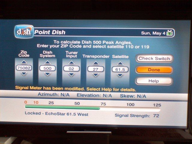

Azimuth setting dead-on,then he thought for a minute or two maybe I'll try this,I'm sitting at the tv while he's out at the dish 500 messing with it then suddenly we have a low signal but in the 20's but had a lock on 61.5!:up
I shout to him hey! we have a lock on 61.5! He's like okay let me mess with the dish some more,next thing I see is the signal increasing quickly into the green leveling off at in the 70's :D:clap
What he did was he adjusted the elevation away from the spec'd 36 degrees to just above 40 degrees that really peaked the signal beautifully,my azi and elevation was right on the whole time but for some weird reason it takes over 40 degrees for our area here in 75082.
