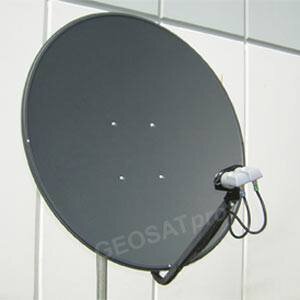

Here are a few photos of the 4 degree rotating skew dual LNBF clamp with two Bullet LNBFs.
I have one setup as a demo on a Fortec Classic NA. Works great at my 45° latitude. Use this satellite finder: http://www.geosatfinder.com - It is all set up for the dual LNB setup.
Bob
So it looks like you actually aim the primary LNB (to the left) at 99 (instead of 97 where the sat is) and then the second LNB (to the right) takes care of itself or set it up as 101 Adventist Sat settings?
both LNB's are off by 2 degrees so you actually aim at 99 and both LNB's will work. You just need to skew the holder first
