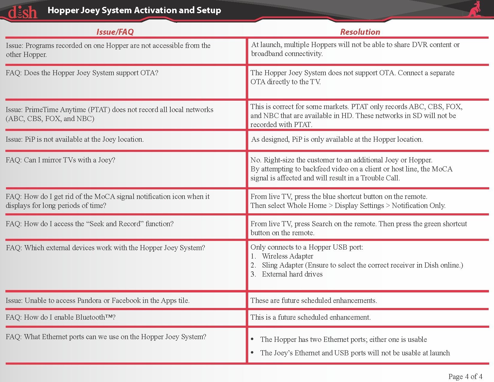

According to the install rules the 2nd Hopper cannot use the 1st Hopper's broadband connection until full integration is enabled.
If you look at the same install tips page 3, item 4 , It say once a hopper is connected to broadband the whole stystem is connected. Wow even the installation tips are inconsistant.
