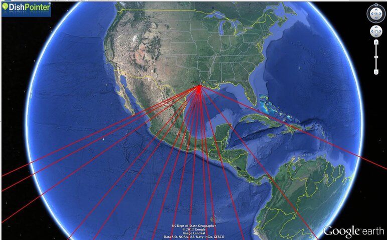

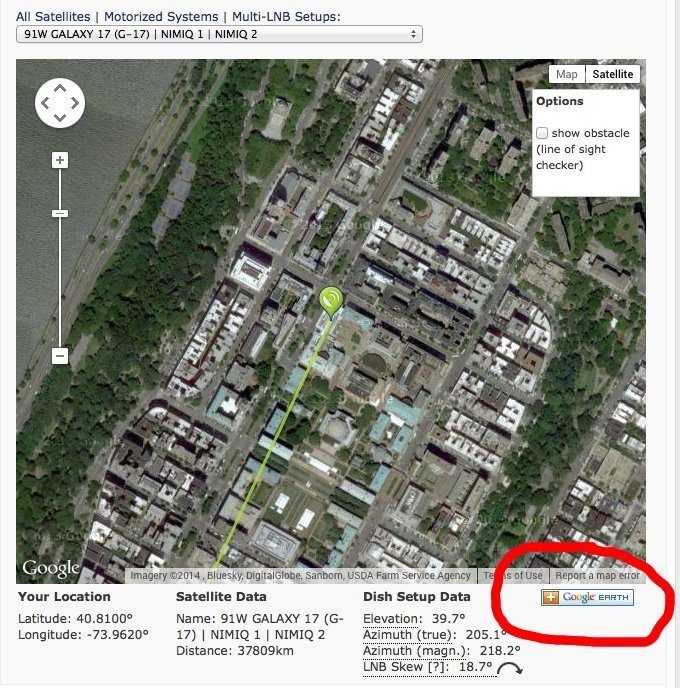

While I was messing with dishpointer.com I noticed there was a little "button" I guess you could call it under the window that says "+Google Earth" :D
So I gave it the spot that I THINK I would want to plant my dishes then I select the satellite I'm aiming for and click the afore mentioned google earth button and a little file downloads with a .kml extension.
I have no idea what the difference is between than and a kmz but it's a google earth file for sure.

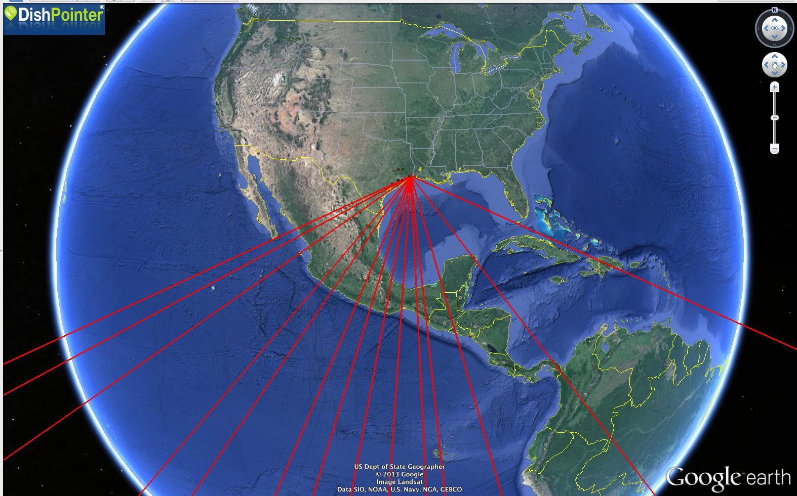

So I went through and did that same procedure over and over for each satellite I'm interested in.
I opened google earth and went to my target location and put a maker on the property so it's easy to home in on.
I went to the menu and selected File, Load then highlighted all the little .kml files I downloaded from dishpointer..
Bingo !!
It looks grim for everything east of 110w.. :cry:

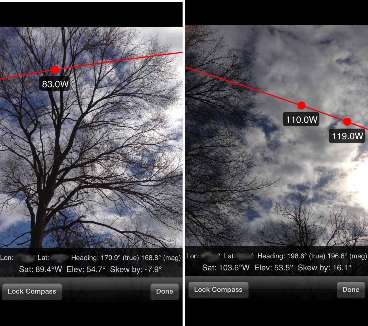

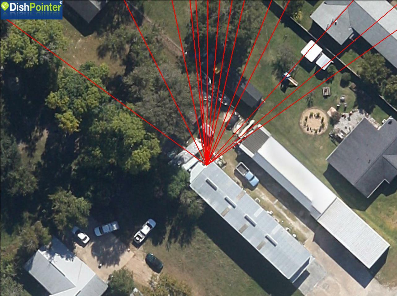

I also went out there and finally remembered to use my iPhone and run the dishpointer app and get a few screenshots of it. Also not looking good.
I need to go back again and enable all the important satellites and run it again for another screenshot. When I took these I just had the subscription satellites selected since I'm paying out the wazzoo for Dish.
I wanted to be sure I could get my $ubscription stuff. It appears I'm in the green zone for that at least.. But I would have a problem with a lot of the FTA satellites and I especially want 83.
I'm still recording Harveytoons twice a day and the silly Saturday night B movies as well. And I've also begun recording H.R. Pufnstuf and Land of the Lost on C-band 101. 101 appears to be right on the edge of the tree and I can see that being a problem too.
So that tree has to come down. It's a HUGE tree, probably 80 feet tall, if not more. And it's very, very much in the way..
