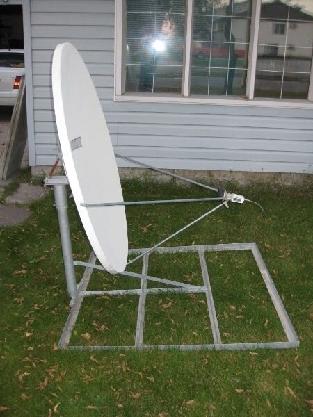

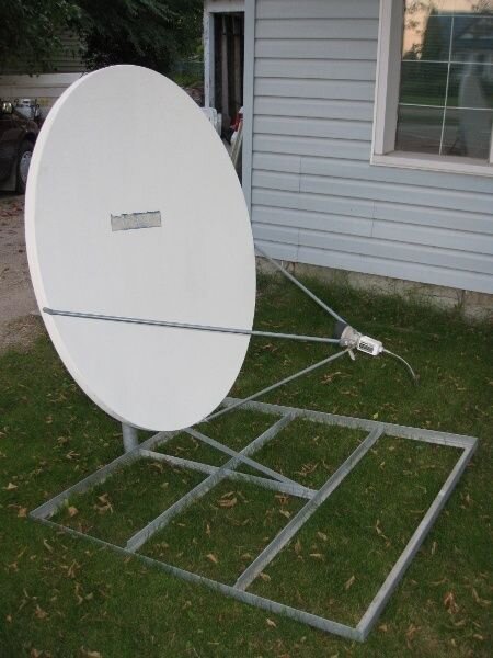

I bought a 1.2M dish for $20 cdn from a business in town which used it to receive music from Muzak, for the music on hold on the phone system. The business has since switched to a different service provider.
Now I have some questions:
Would this dish be considered a 1.2m? The actual measurement of the dish is 48 inch 52 inch. It currently has a single polarity Ku lnb, which I wont use.

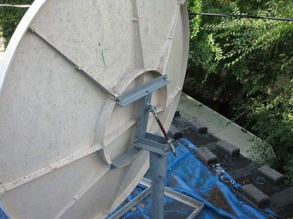

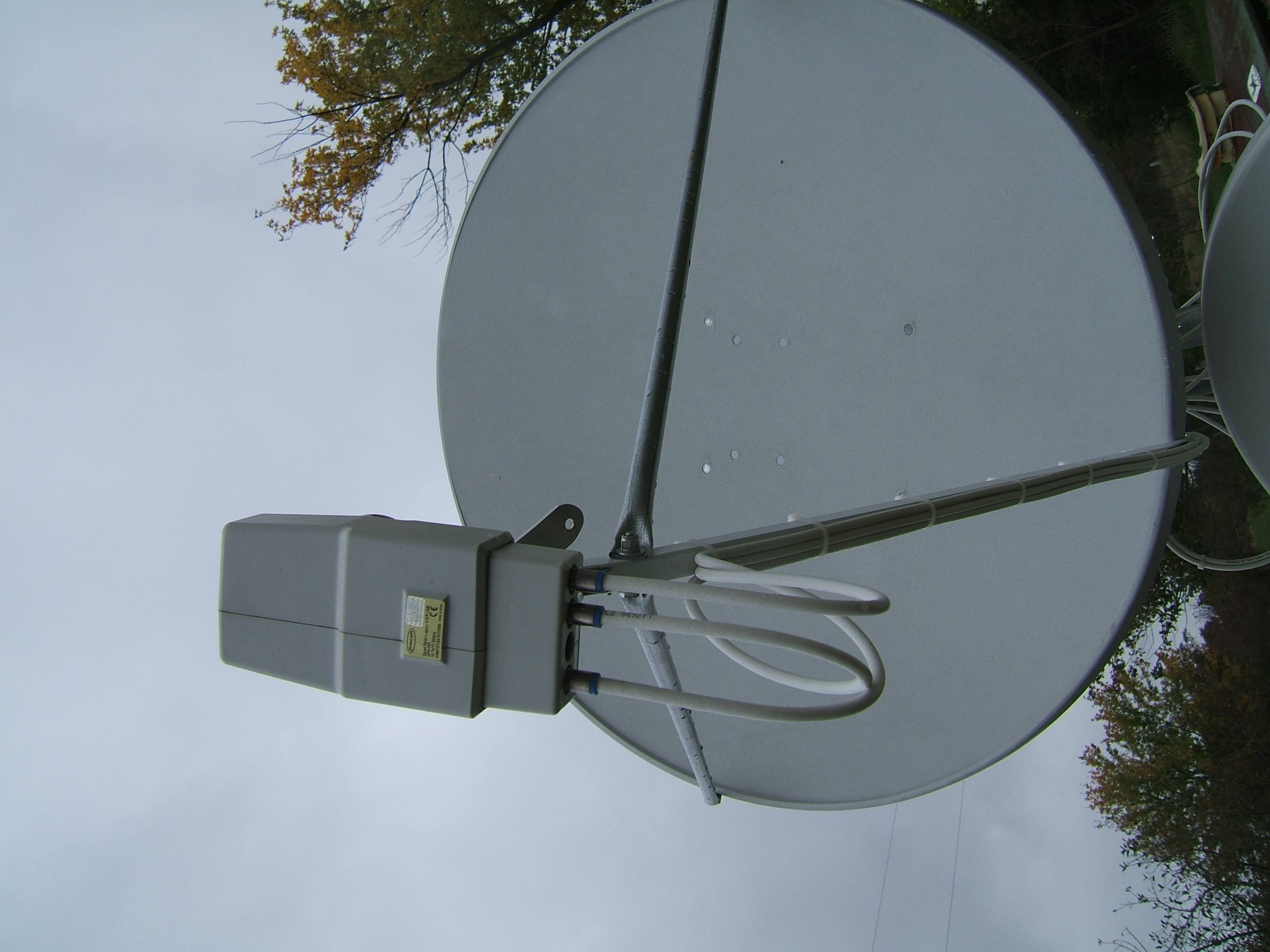

While you are posting pix, can you get a shot of the back of the dish, too?
The mount looks like Prodelin, but the feedhorn and eyebrow, looks a lot like what old Primestars had (channel master).
'Course, I could be entirely wrong. :)
Looks like the LNB supports are outside the dish (like Prodelin). Channelmaster has them through holes molded in the reflector.

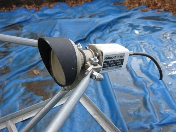

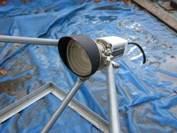

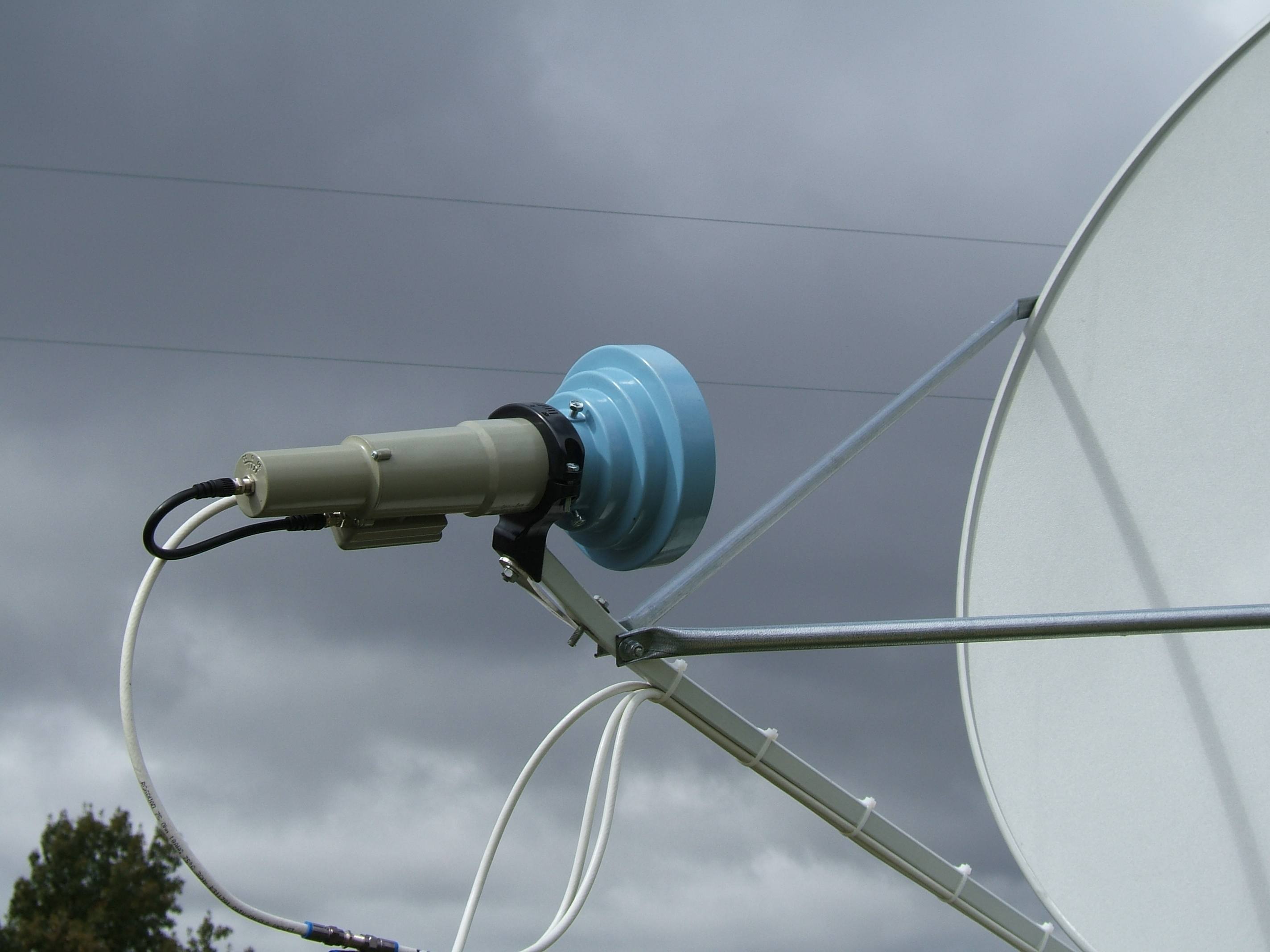

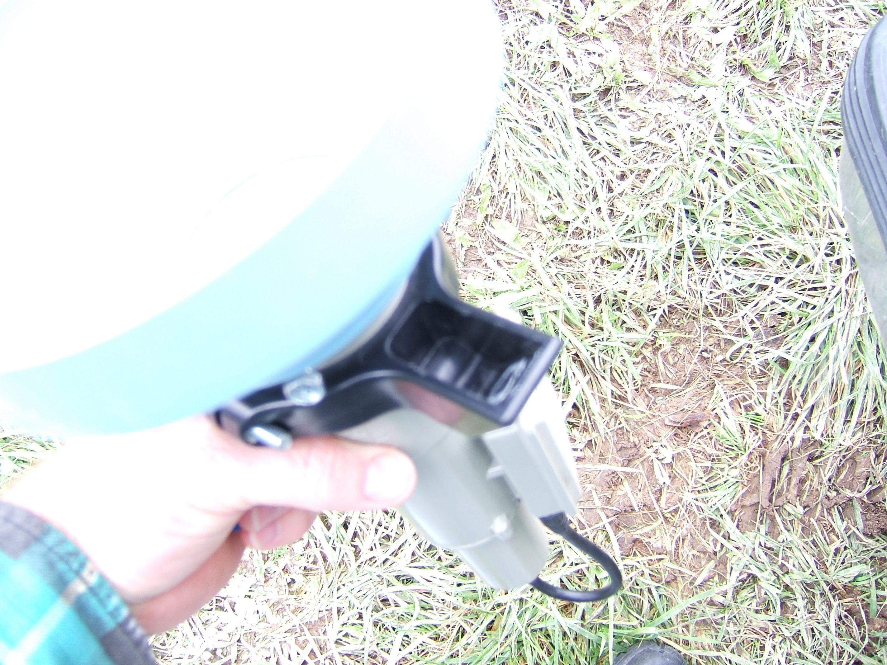

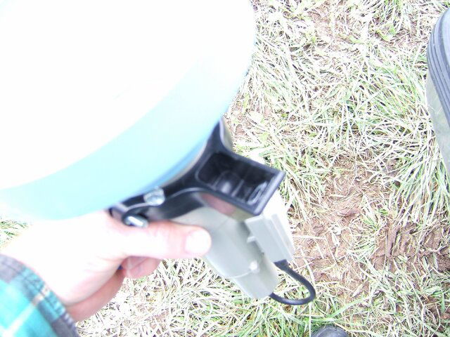

Here are some more pictures. The lnb is a Norsat 7000A series. It had a nice cover, but it was old and fragile and as I squeezed a bit, it broke.
That appears to be a C-120 flange mount on the feedhorn, although it could possibly be one of those weird mounts that is similar but has a different hole pattern. If it is a C-120 (probable), you would just unscrew the Norsat LNB from the mount and replace it. That is a Prodelin 1.2 meter dish...

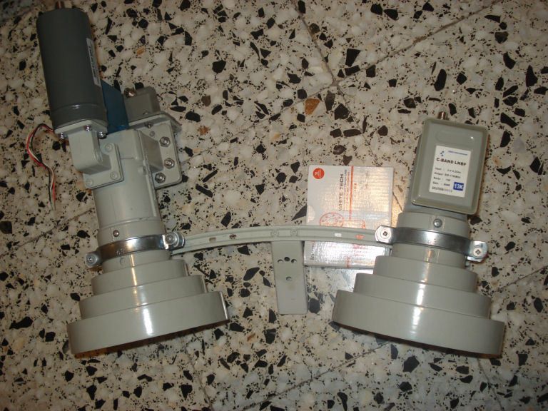

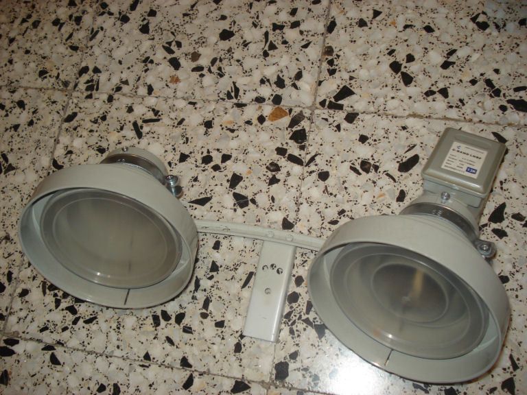

Can you provide the web site where you got the dual cband lnbf holder? I am looking for something like this both for offset and prime focus cband dishes.

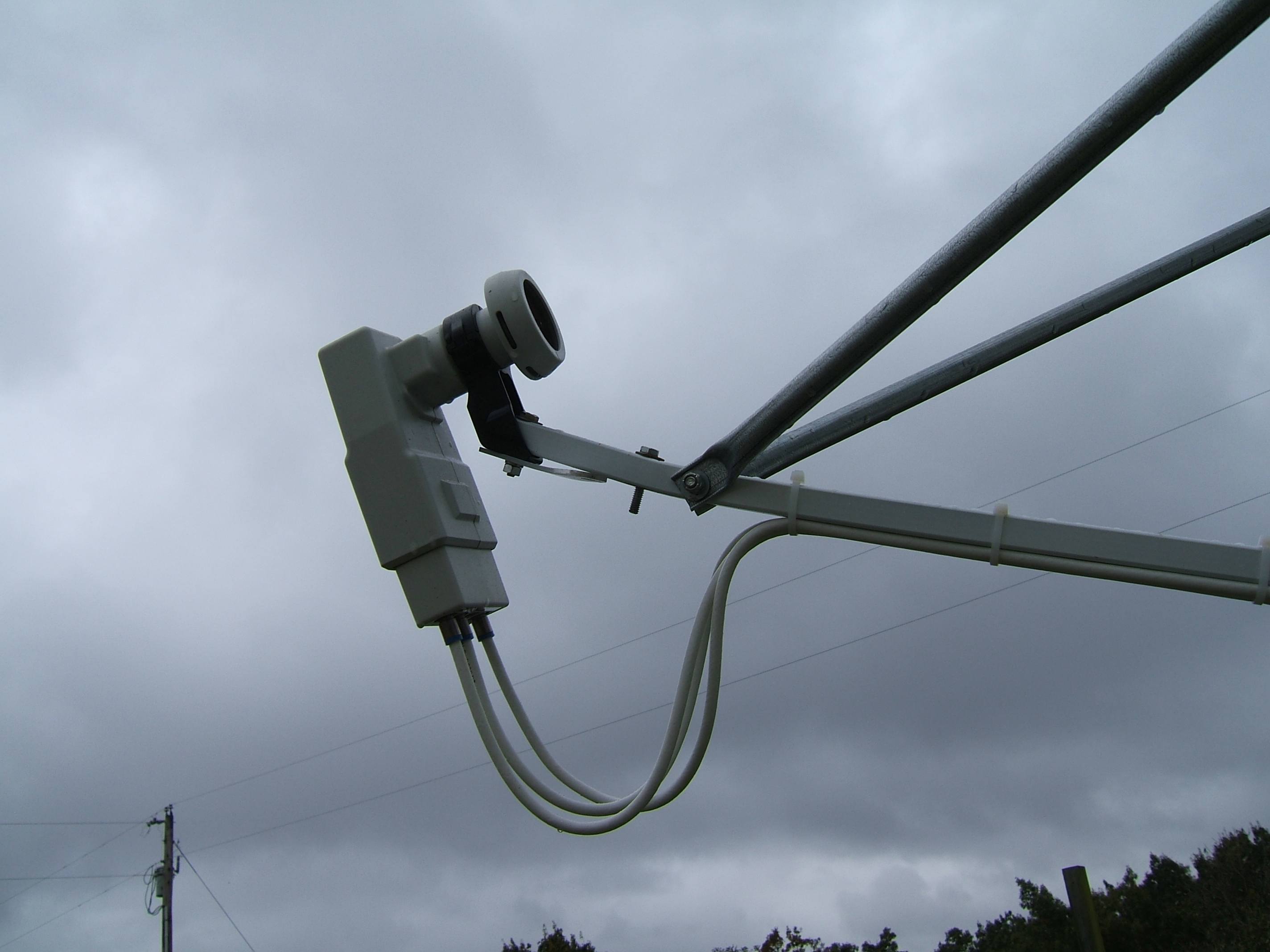

The LNBF holders for these are for 1/2 square tubing. Looking at yours you will have to modify it like I did. It was simple & cost me $10. I'll take a pic & post it.

This works out pretty good for me. Sorry about the one picture. The sun popped it's head out for the first time in over a week just as I snapped it, but you can see how that holder takes the square tubing.
If you go that route, I used a Mill Vice to bend mine.
I can send many for photos of how I got it just the way I wanted it. Let me know.
To swap out I remove the RG6 & one bolt at the LNB holder. The C Band is 65mm the Ku is 40mm
