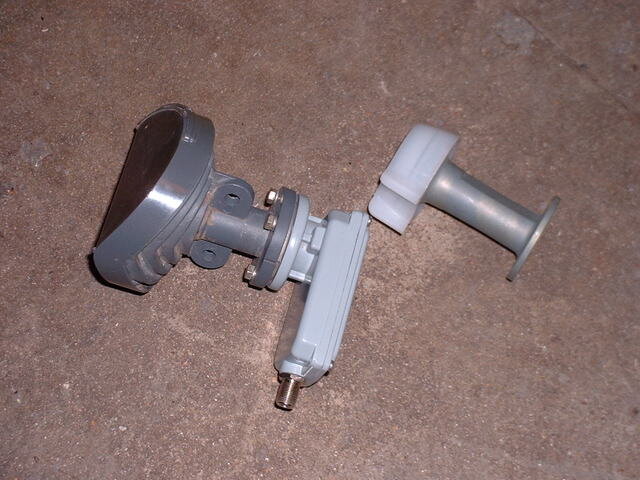

Got another Linear LNB Eagle P170Ku any experience with this?
tort
On Vacation
May 1, 2008
11
Well, I love going through the D*** dumpster....
In addition to the FSS Stacked LNB, I now have this Oval Eagle P170Ku LNB....
I'm going to be using a Wineguard 76cm Dish, or maybe use one of the SuperDish 105/121, Slimline AT9 or AU9..
Any experience with which one would be better suited for Linear FTA use on any of these?
According to this Eagle Aspen data sheet, the 170's are voltage switched for H & V polarity.
A Dish Network LNB off a SuperDish 105 or 121 antenna looks like the picture on the right, above, but is bandstacked.
... and has a sticker on it labeled: FSS
You should use a feedhorn that matches the shape of the dish you use.
The bigger the dish, and the better the feedhorn matches it, the better performance you'll get.
Below is a picture of a DishNet FSS LNB mated to a feedhorn off a ChannelMaster (Primestar) elliptical dish.
