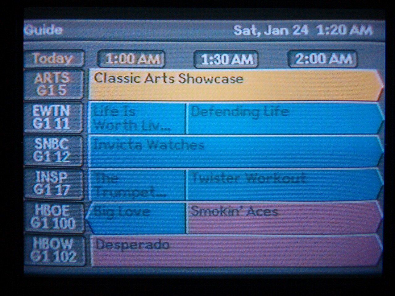

Pic of the guide working on my non subscribed 920 useing the unplug replug method.
