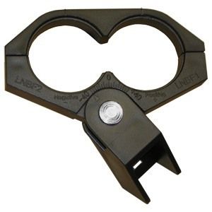

Do you have any news on the 4 degree monoblock mentioned in the Sky Angel thread?
Iceberg said:
look above at 1st post. Its now available
That's the discrete LNB's and switches. The monoblock has the LNB's and switches in a single housing and would look neater and probably more reliable being sealed from the weather.
my bad. I went through and found the old thread that we had in the Sky Angel forum and bumped it up. It had some good stuff on different ways of getting some Sky Angel channels with a FTA setup (especially after 3ABN got booted off)
The 4 degree Monoblock has completed testing and is in production. Should be available within 6 to 8 weeks. We added a little suprise that will be another first for fta! The few peope who have tested and seen the prototypes were first sworn to secrecy then gave the gave two thumbs up sign and asked why the idea hadn't been done before.
Satellite Guys will know about the suprise first!
