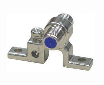

I plan to buy an AM21 and hook this antenna to it, but not sure how to ground it correctly.
Do I run coax from the antenna to a grounding block like this-
then run the other length of coax from the grounding block to the AM21? Then attach a piece of grounding wire from the grounding block to a grounding rod?

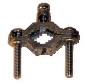

The antenna tower is cemented in the ground, does the tower need to be grounded additionally too? If so, can I just use a grounding clamp like this-
on the tower, with a ground wire running form the clamp to the grounding rod?

so what if i installed a new ground rod near the antenna tower, and then ran a bare copper wire from my main panel, through the basement, through the outer wall and connected that to my new ground rod?
then connect my antenna tower to the rod using clamps and #6 copper wire. then connect my coax grounding block to that same ground rod using clamp and #12 copper wire?
That's the way you're suppose to do it.

So reading through that link I see that just installing a ground rod and connecting the mast and coax grounding block to that rod satisfies [FONT=&amp]Channel Master's grounding recommendations[/FONT], but not NEC. I'm just not crazy about a wire running through my basement that could carry a lighting strike. I've checked a few neighbors set ups and several of them have a separate ground rod installed for cable or OTA and none of those rods are connected to the main system ground at all.
In fact, on the other side of my house is a 4 foot ground rod that my cable internet is connected too, it is also in the ground without being tied to the main system ground.
And that cable guy doesn't care and he had NO ideal what he's doing when it comes to grounding. The minimum most likely should have been an 8 footer rod and the only way to know for should would be to measure it. AS far as the cable in the basement that's what I do as the my tower is on the oppose side of the house and I tie into my panel box ground along with all my cables grounds and equipment. I'm guessing that all it's going to take is a lighting ground strike somewhere near you to cause damage .
