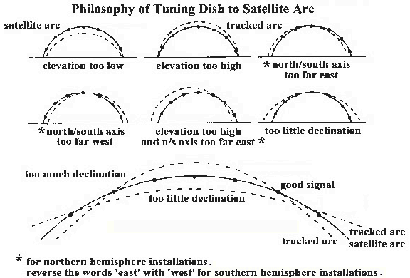

I know that lots of people have commented on the elevation scale on some dish's being off by quite a bit. Has anyone noticed this problem on the motor bracket's latitude scale? I might have a declination problem on a new setup I'm working on. The signals get worse the farther I get from true south (plus or minus). The pole is solid and plumb.
Yes, they can be off. You can try Adding 1deg to Dish and Minus 1deg from Motor(or vice versa), at True South there would be no difference.
This Pic may help....
That helped, thanks. I also gave a little turn to the west.
