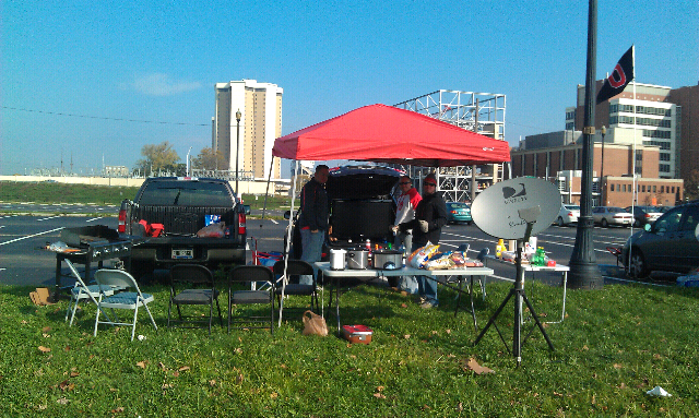

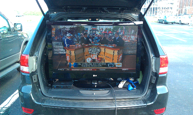

Thanks so much to everyone that helped out. I was a little worried when I couldnt get any sort of signal at first but after adjusting the dish a bit I was able to get it pointed correctly enough and everything worked perfectly. I cannot tell you how many people were coming up asking me how I got it to work and wanted me to help them with theirs. I really want to thank everyone again, we received a lot of positive comments on our setup and drew a nice crowd before we headed into the stadium and witnessed one if the better games of the season! I attached a picture of the setup.
Turned out great!
