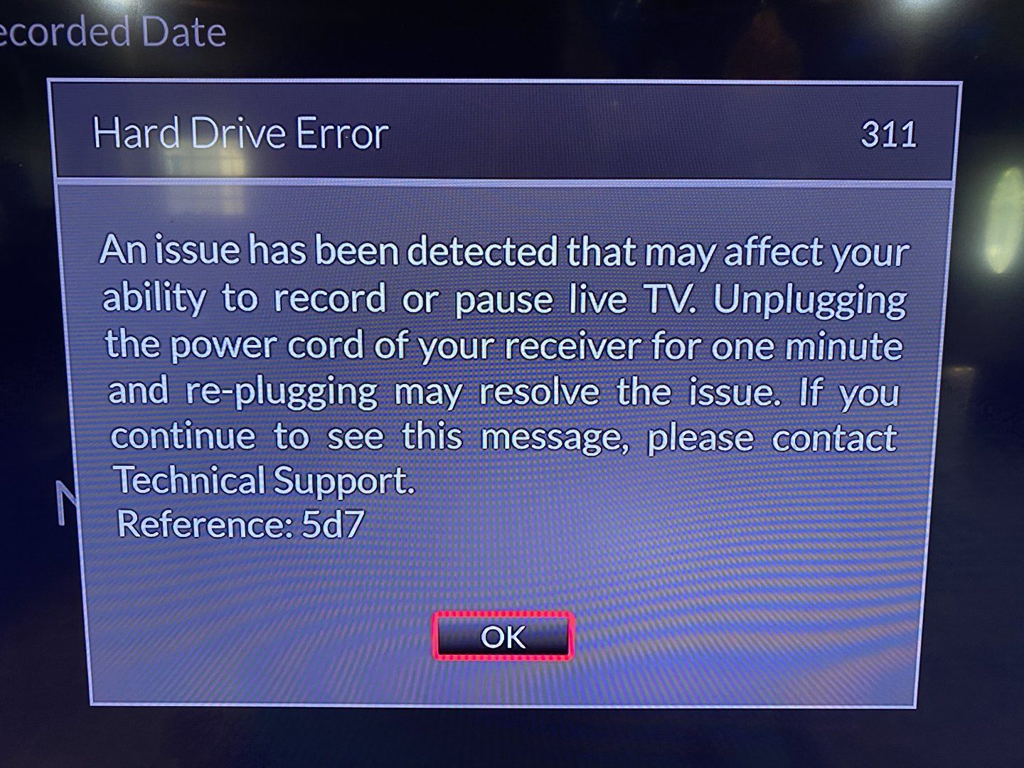

Hard drive failure on hopper 3
No 5D7 on the list but I looked at all the 5s and came up with 527:
DISH Receiver Error 527
DISH Problem/Solution: ATTENTION Your hard drive is being repaired.
This will take a few minutes.
Do NOT disturb your receiver until the repair has been completed.
When the repair has completed, your receiver will be restarted.
Maybe that's it. It seems to fit.
If it's stuck on 527 then your HD is probably shot.
There is a good chance of that but if you just leave the receiver turned on and walk away for a while it might fix itself. As the remarks say:
It's actually 311 with reference being the 5d7

This happened to me before (I don't remember the error code) what was neat was that while the DVR and most features didn't work, the Hopper still worked like a regular satellite receiver and I could still watch TV on the Hopper until my replacement arrived. I hope this is still the case for you. :)

Yes receiver still works , I just hate it that I lost all my recordings.
I hear you there.... that is why I copy all my important stuff to an external hard drive. I was bit once as well.
But they are mechanical devices and they do die over time. I think for the most part the life on the drives on Hopper 3's has been really good for something thats running 24/7.
That makes the error code (311) seem really appropriate, since the failure basically turns the Hopper into a 311 (non-DVR receiver).
