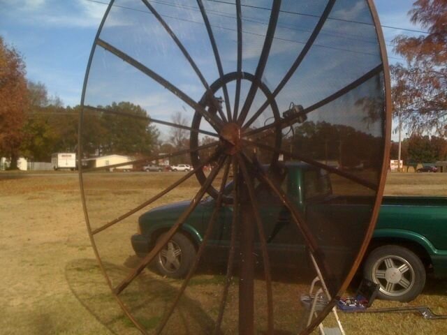

So far I have found maybe 15 dishes out driving in the last few weeks. It's funny how dishes you never noticed before you catch out of the corner of your eye when you have dish fever.
So the other day I am driving home from work and it is almost dark. Out of the corner of my eye I spot a dish behind a tire shop. Just the outline b/c its dusk. I went by today to ask about it and he say's he is tired of mowing around it get it out of there.

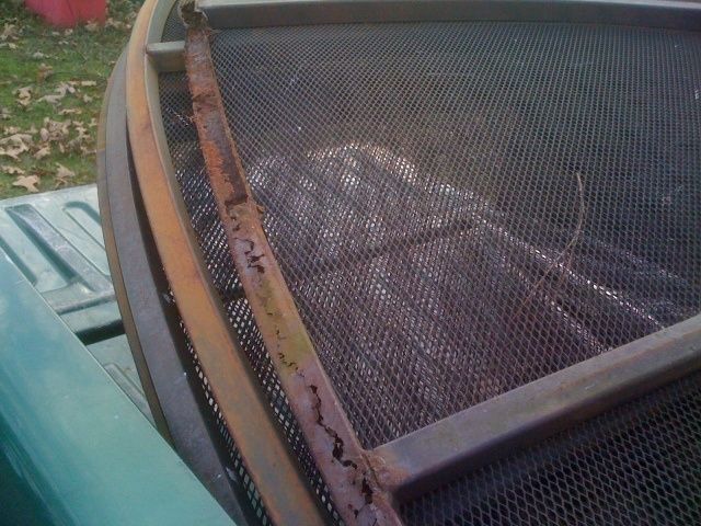

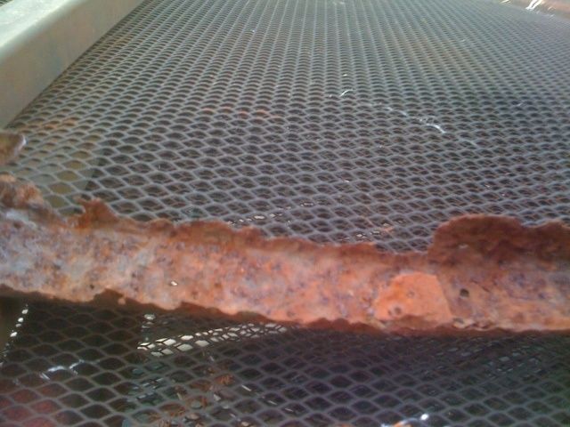

I don't think I am going to use this one it is in bad shape. I have never seen rust like this on a dish before. This must have been installed in the early days b/c man look at this!
10 ft rusty button hook.
You can tell which panel was on the bottom! I probly should have left it but I figured I remove it anyway since all it cost was 2 hours and a bloody knuckle.

I really don't mind surface rust. But structural damage is too much. It is almost all the way through it. I need this lady up the street here to come to her senses and let me have the 10 foot SAMI thats in here yard. She told me $150 remove the pole, buy a square of sod to fix the spot and I could take it. No thanks!
OUCH! My steel BUD (very similar looking) has a patina of surface rust here and there. But nothing like that. Have 'scotch brite'ed here and there with a bit 'o spray can paint now and then. If you don't move it, to poor the water out of the lower outer ring I can imagine it wouldn't take too long to rust through. Or split it when it freezes.
The mount itself may be worth keeping. Mate a 6ft Ku offset to it ??
If it's only rotted through along the bottom of that bottom panel it might not be all that bad, flat black paint does wonders sometimes. If it's too far gone, then it's a good organ donor! Two hours for a feed, mount and actuator parts isn't bad! :)
Maybe you could beef it up with something , if the ends are ok on that rusty place. Clamp/bolt something to it? I haven't gotten that desperate yet but if I needed a 10' and that's all I could find, I would try something, lol. That 10' sami might be worth that lady's price-considering what the last new ones were going for. IF it's in good shape.
