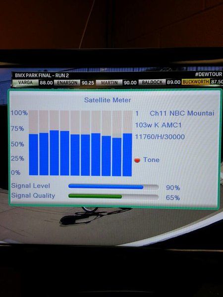

Thanks for the clarification Titanium. I didnt have quick access to my micro. I just snapped a photo of the signal screen showing just the signal and quality.
Well, maybe not exactly, but the bar graph it shows fakes it pretty well.
Pressing the "signal" button just gives you a 5 second history, of the quality reading. This can help in aiming with a visual representation.
But the more stable the bar graph is, the better the BER and CNR.
