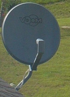

Has anyone modified their Voom reflector/arm for using newer (D-Shaped) DP lnb's? The reflector is much larger than the D500 that we're using now for 61.5. Tried shortening the arm today but I'm not sure I got it to the correct length. If anyone has a modified and working Voom setup using DP equipment, please measure your arm and let me know the correct length. I'll buy you a pizza for your trouble.
If I had a legacy lnb on hand today, I could have compared the two side by side and had better chance to get the cut right. Signal strength is lower than the D500 dish with single lnb so something's not quite right.

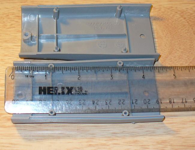

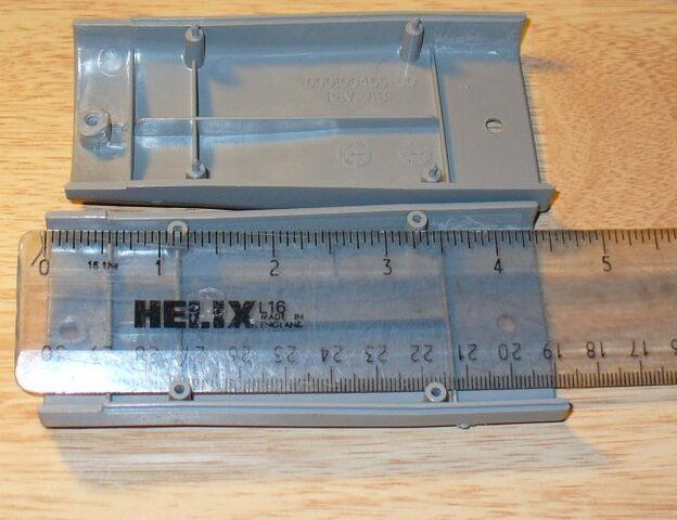

I just did this recently for 61.5 with a voom 24". It worked great and improved the signal by 20 points, was simple took apart the single lnbf D shaped holder/yoke for a dish 500 used on a single sat. You can use the top and bottom to make the lines, lined up the end of the yoke with the end of the arm, took a sharpie and marked the screw whole and then marked the line to saw where the yoke has a molded lip line inside where a 500 arm would end as the new end of arm length to cut on the voom 24". at this point you could try to make the measurement with the piece you cut off.

So maybe it is not to late unless you cut it too short already, I went and measured mine, I had cut off 9cm or 3 1/2" of the arm in order to match the original end of arm length equal to the end of the D shapped yoke.

Is it possible for you to measure the length of the arm? My arm is now 12-9/16 long. Looking at your photo, I made the mistake of making the first cut at the first rib versus all the way to the end. After two cut's, it looks like I may have cut off maybe 1/8-inch too much.
If you can measure yours, I'll weld material back on to the tube and make a third cut at the correct length.
The reflector I am using is 26-inches tall and 24-inches wide. Would this be called a 24-inch reflector or a 26-inch?
This reflector is huge compared to the D500 I'm using now. After a lot of tweaking, best the larger reflector can do is about "10" less than the D500. It seems like I can move the azimuth a great deal and not affect signal strength which has me thinking I'm too short or two long.
With the screw removed, I've pulled the LNB out a little on the throat of the tube but it decreases signal strength. That alone has me thinking the arm is still too long. If someone could measure the length of the arm for this reflector, before or after the mod, I could adjust mine accordingly.

You cut at 12 9/16 or (12.5625). My metal arm length ( including the part of the metal arm underneath the yoke) is 12 5/8" (12.625) or exactly 32cm long, the screw centered at 12 1/8" or 30.8 cm, yoke begins to cover arm at 11 3/4" or 29.9 cm.
If you already cut too short maybe you can still line up the bottom of the yoke with a 11 3/4" line on the arm and then make 2 new screw holes through the plastic yoke over the remaining section of metal arm to secure the yoke at the right length. The best thing to do now is probably enlongate the screw hole and push it forward more toward the edge of the arm.
