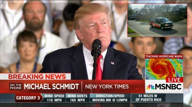

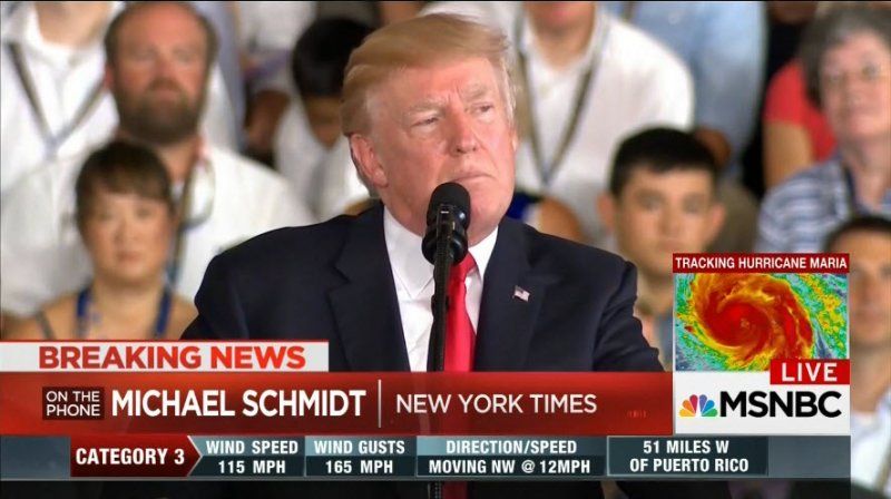

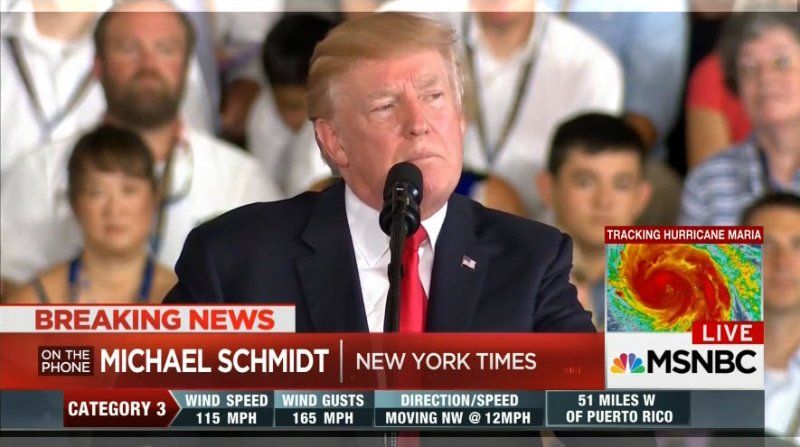

I have a LG 65EF9500 4K/UltraHD OLED TV with a Hopper 3 and it seems like regardless if the source of the content is the built-in YouTube or the Google ChromeCast, Google ChromeCast Ultra or even the DISH Hopper 3 which are HDMI connected, there are horizontal bars on the top and bottom of the content itself even in PIP (Picture-In-Picture) windows which is not related to the physical screen as the bars will always be at the edge of the content whether the screen is the full height of the display or if it is less than the full height of the display. Taking photos doesn't work as the bars are about 11% brighter so the photos will show the same color as the rest of the picture so these are simulated pictures from DISHAnywhere.com and then I added in the problem myself with photo editor.
This is what it's supposed to look like:
This is what it looks like, notice the top and bottom of the picture has a bar that makes the content brighter:

This is what it looks like now, notice the top/bottom bars in the Main screen and also in the PIP (Picture in Picture) Window:
I have seen the same problem on someone's Sony 55" LED before but I don't know what this problem is called as it seems to be the electronics doing the processing that is causing it and not the display itself from what I can tell. Otherwise, it will be at the same physical spot on the physical OLED but it seems to be at the edge of content that is based on the physical size of the content itself. LG would still provide warranty repair but they need me to describe the problem first so they know what parts to ship before the technician arrives. Thanks for any insights!
