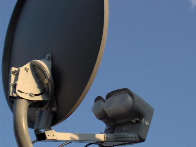

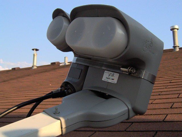

I put a LNB on the 129 side of a Dish500 and got good signal. So you just put it on the opposite side :)
