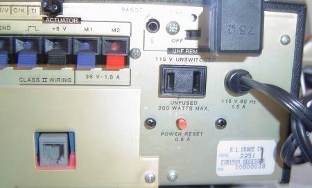

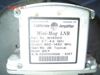

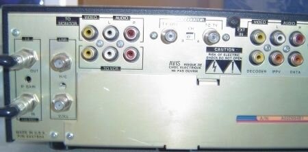

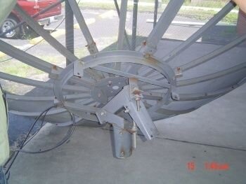

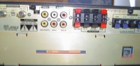

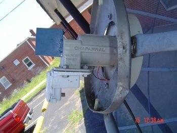

I will inculde pictures so that you can see the specs on some of this.

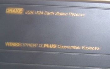

I further received a Drake ESR1524 with Videocipher II Plus equipped from the factory. It came with a UHF remote control. (more on that later)
I didn't get a manual with the Drake, and there is none available online that I can find. I can order one for $15.00 which I don't mind doing, just hate to wait until it arrives, so if anyone has one in digital format, I would love to have it to start reading.

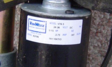

I am going to call Von Weise tomorrow and try to get a wiring diagram for the actuator.

Is the current Feed Horn and LNB adequate?

Here are some pics of the equipment.

Von Weise has already faxed the wiring diagram and specs for the actuator.
Drake is sending me the manual for the ESR1524 by priority mail, and did give me a rundown on some of the receivers capabilities.
This receiver is capable of both C-Band and Ku-Band analog only. It does have video/audio outputs for a local tv, and an RG-6 cable outlet for the same purpose which could be routed to a tv in the second room.

I have been told in another forum that I will need to get a Chaparral Corotor II feedhorn with 17* C-band LNB, & .5Ku LNBF. What I currently have only receives C-Band.

My suggestion is to get it working with the drake...check the C band LNB (should be at least 17deg kelvin (modern ones) and when satisfied...spring for a 4dtv 922.
