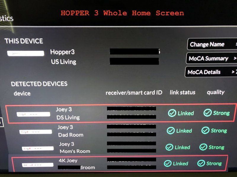

Hit Home 3 times on the remote, then hit 4 for Whole Home and see if the link or the Moca shows as weak
So they all say strong, but there's something weird going on. I have 1 Hopper, 1 4K Joey, and 3 Joey 3s for a total of 5 receivers.
On the main whole home screen I see all 5 devices - Hopper at the top and the 4 devices below all show strong.

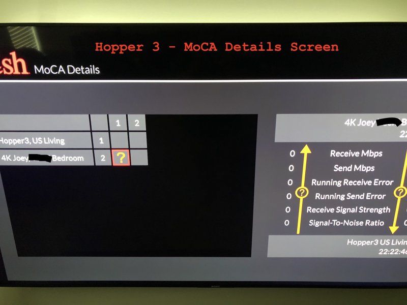

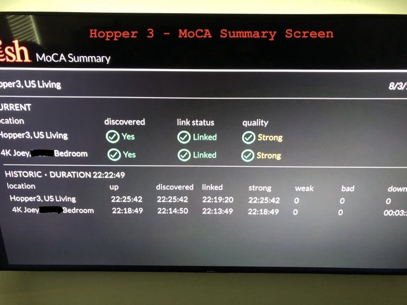

If I click on MoCA Summary I only see the Hopper 3 and 4K Joey under Current and Historic
If I click on MoCA Details, I only see the Hopper and 4K Joey as well with a 1 and 2.
No mention of the Joey 3s on the Summary or Details screen, just the main Whole Home screen.
Could this be an issue? Joey 3s haven't had any other issues than the HD to SD thing.
BTW, I'm checking all of this from my Hopper because that's where I am right now.
Yeah, that's where I'd be looking. Something seems like it's not cabled/connected correctly, which is odd, too, since the old Joeys were fine, right?
Yeah old Joey 2s were perfectly fine and no cabling was changed. New Joey 3s are still fine and work except for the whole random switching from HD to SD.

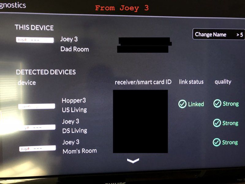

When I go to one of the Joey 3s it shows that it's linked the the Hopper. Is there a way to unlink it and attempt to relink it in order to reset it or something?
