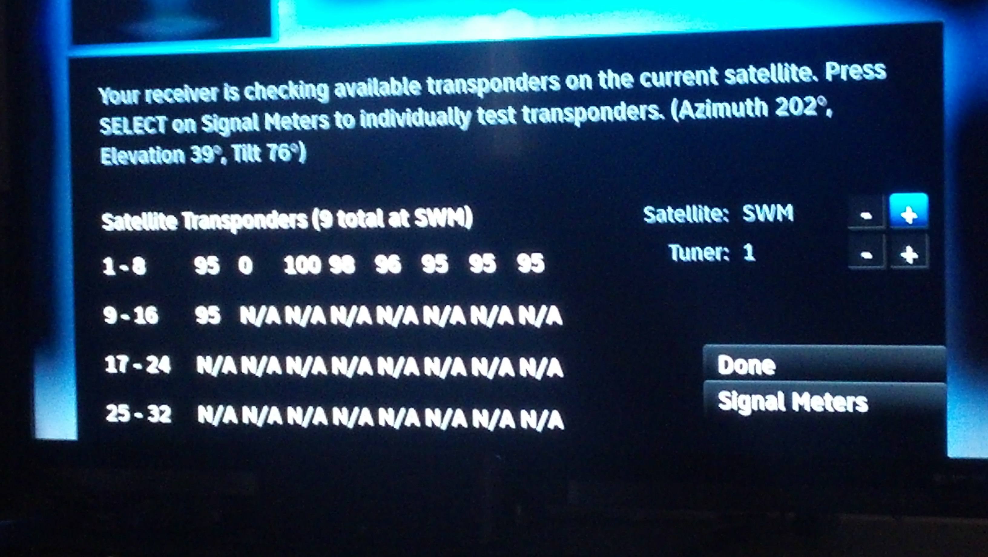

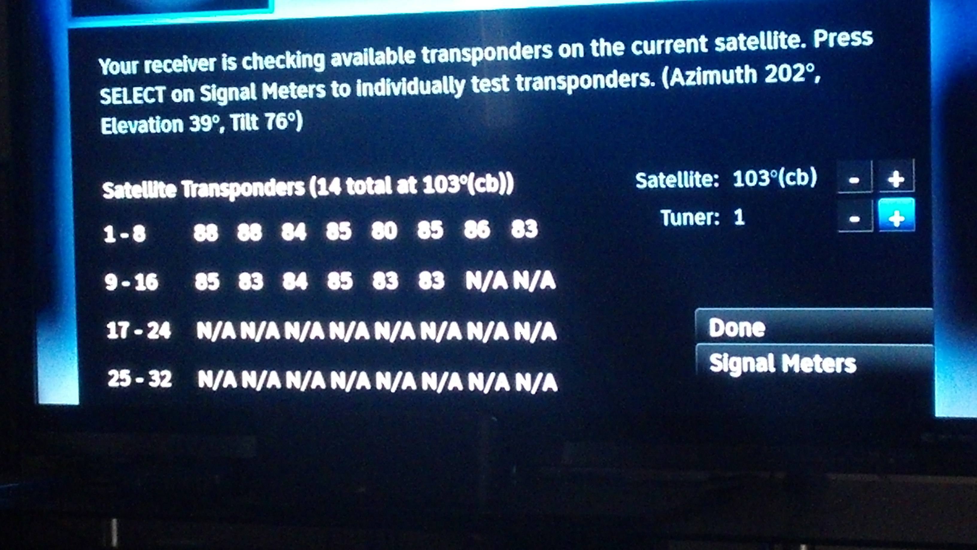

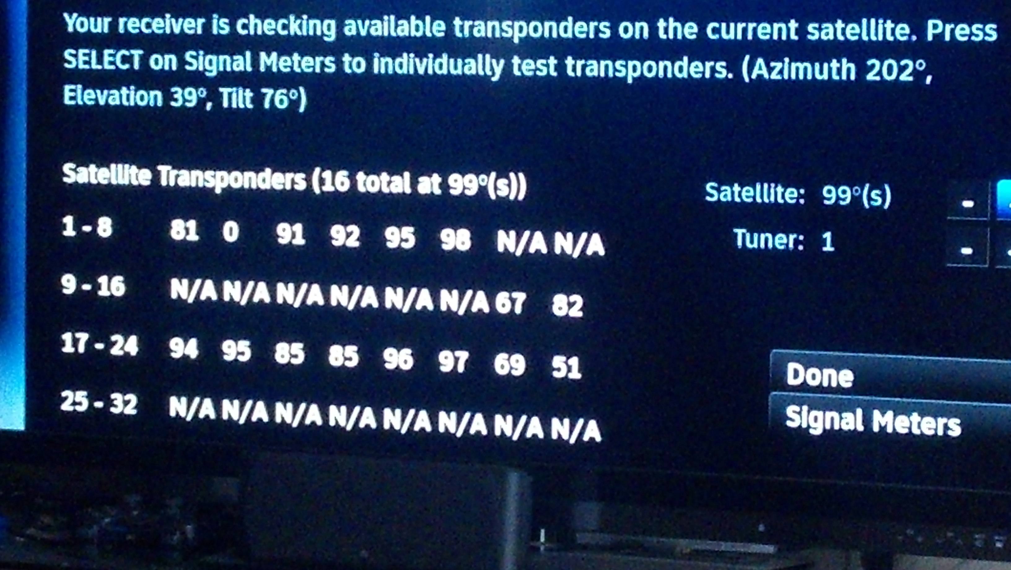

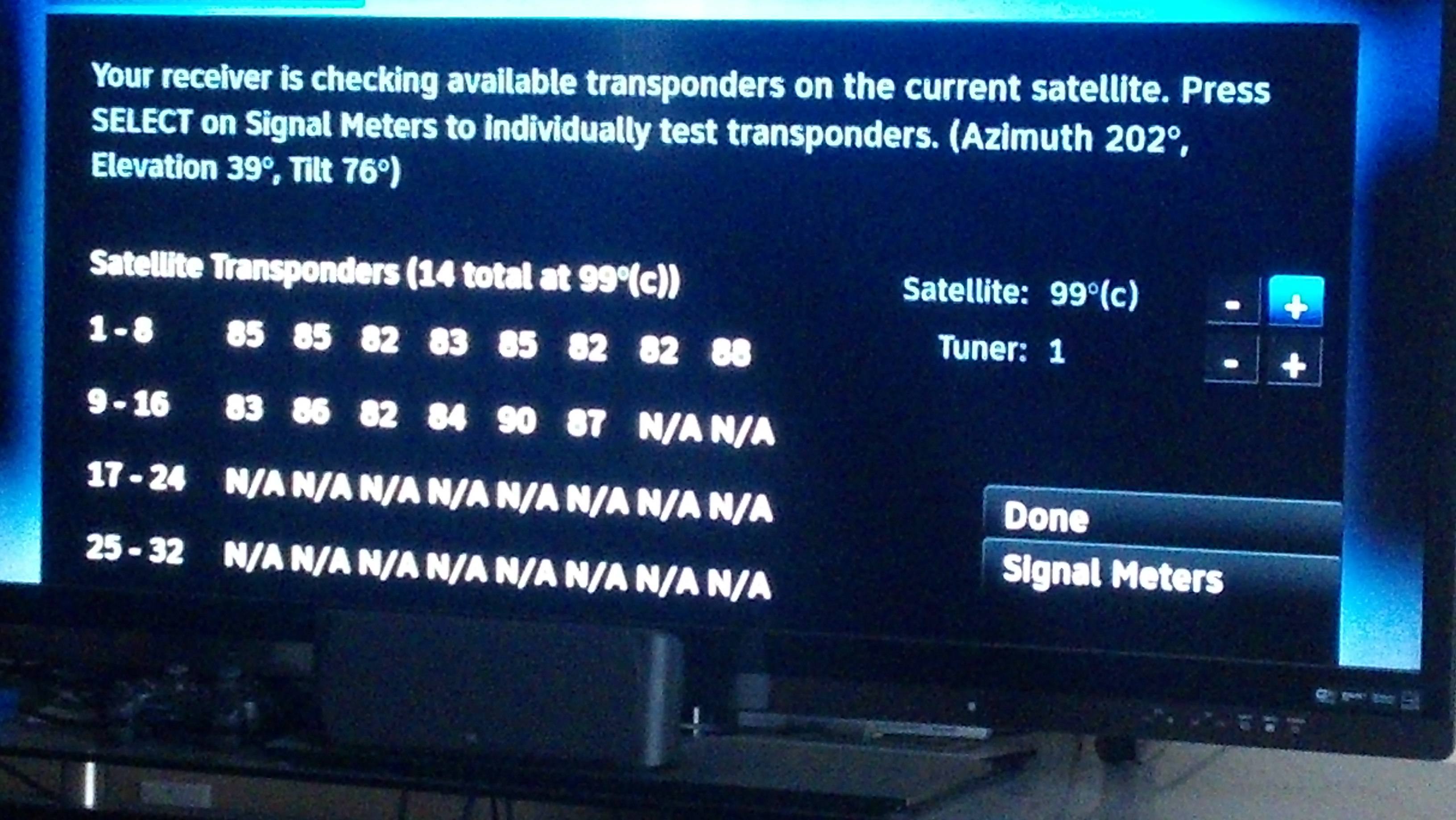

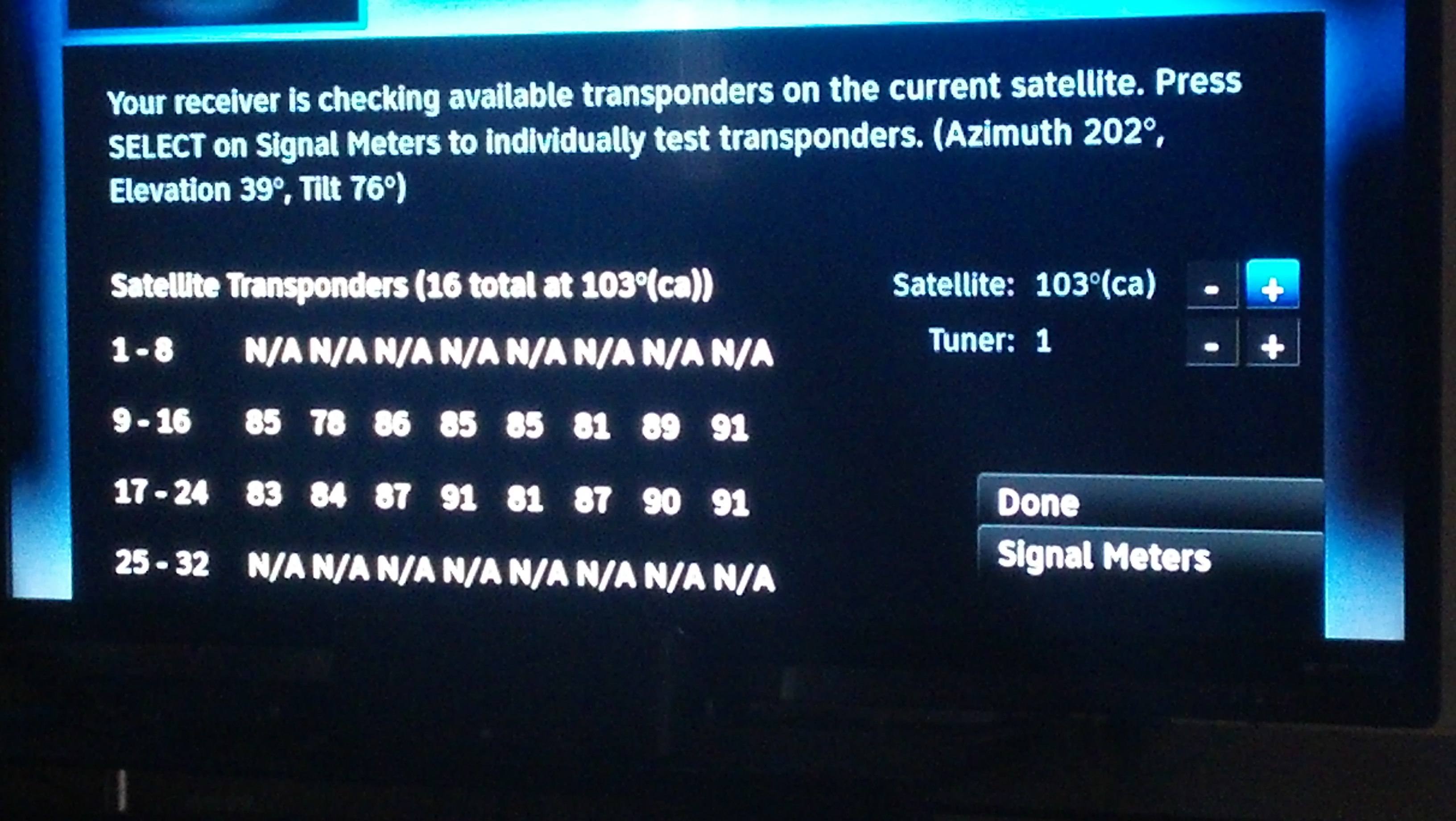

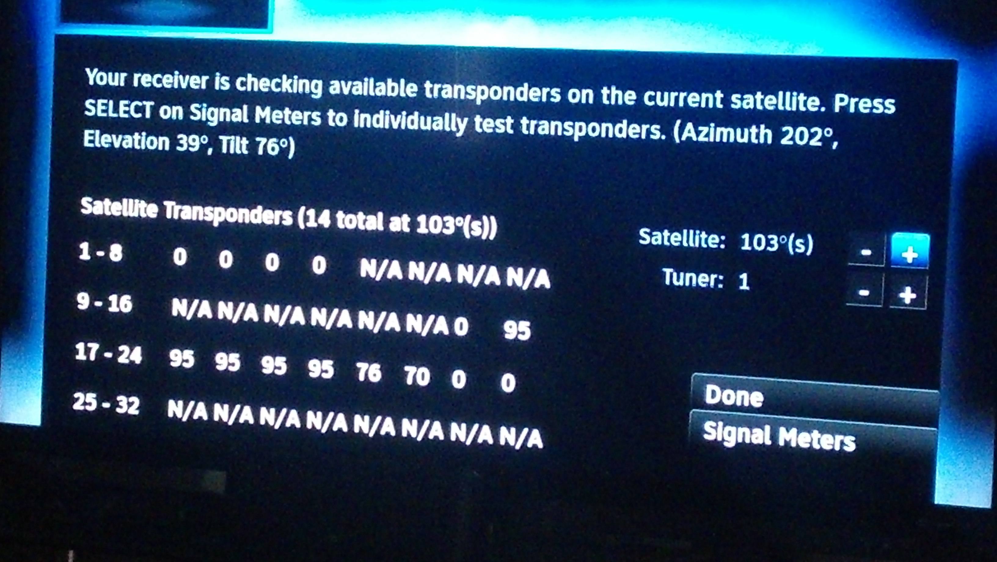

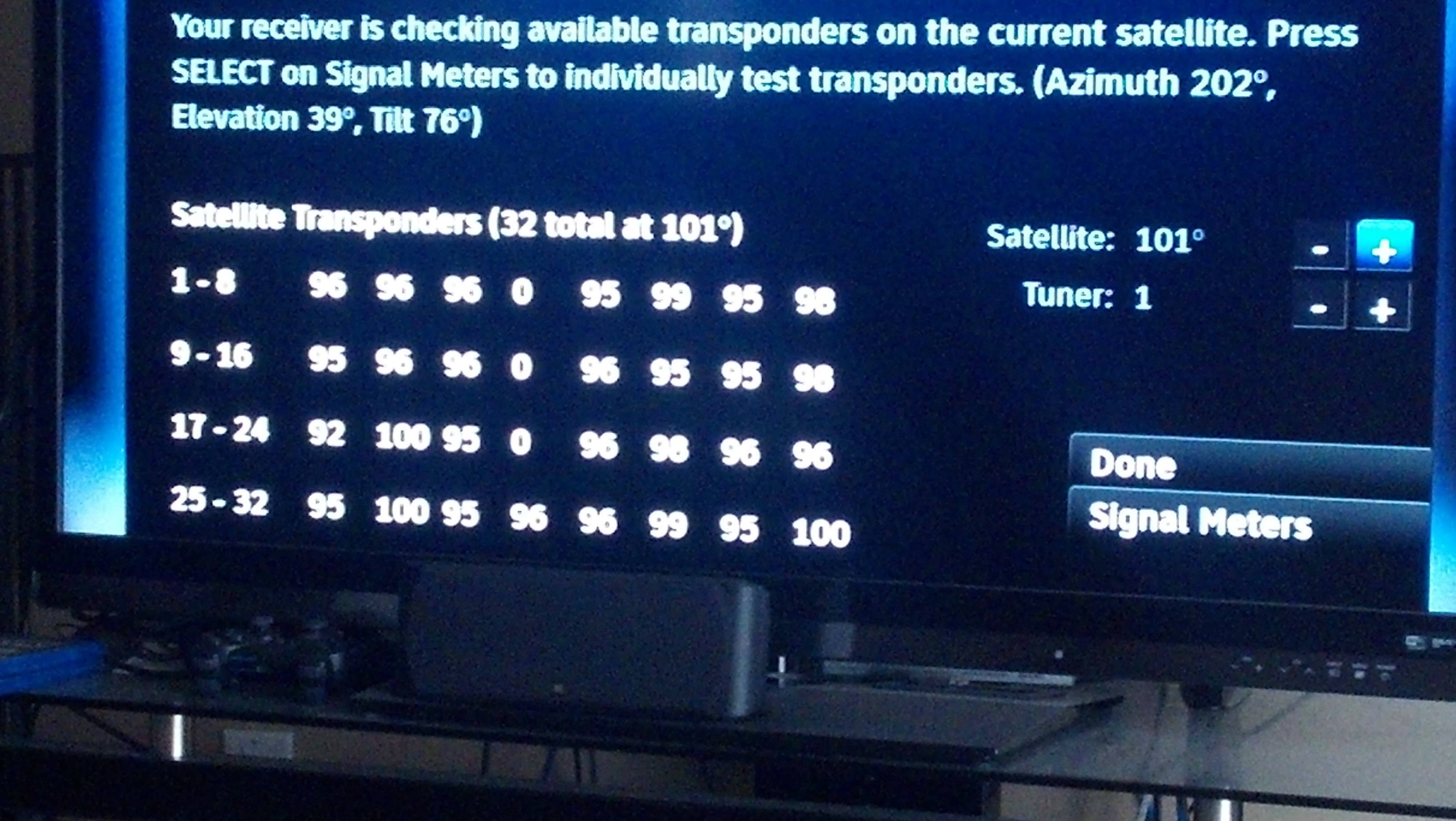

Sorry for the late reply. Virtually the same results on Tuner 2. To summarize, most everything is 75-95, but the following show "0": #4, #12, and #20 on 101; #2 on 99s; #2 on SWM; and #1, #2, #3, #4, #15, #23, and #24 on 103s.
View attachment 91384 View attachment 91385 View attachment 91386 View attachment 91387 View attachment 91388 View attachment 91389 View attachment 91390
Your numbers on the 99 and 103 (non spotbeam ones) are a little low, but I don't think thats the problem, you have a picture so your good in that regard.
As for connections, I think seeing the trouble moved with your recvr, I'm leaning towards a bad recvr.
If the LNB was bad you would think you would see the same thing on both recvrs.
What dish are you using ? Are both recvrs set up seeing the same dish type ? (thinking SL3 vs SL5)

Like Jimbo said, your numbers on 99c and 103ca/cb are low, but probably not the issue. You should get the dish realigned however since you will lose your picture quicker in rain or heavy snow. I still suspect your lnb. I had the same situation and a swap out fixed it.
