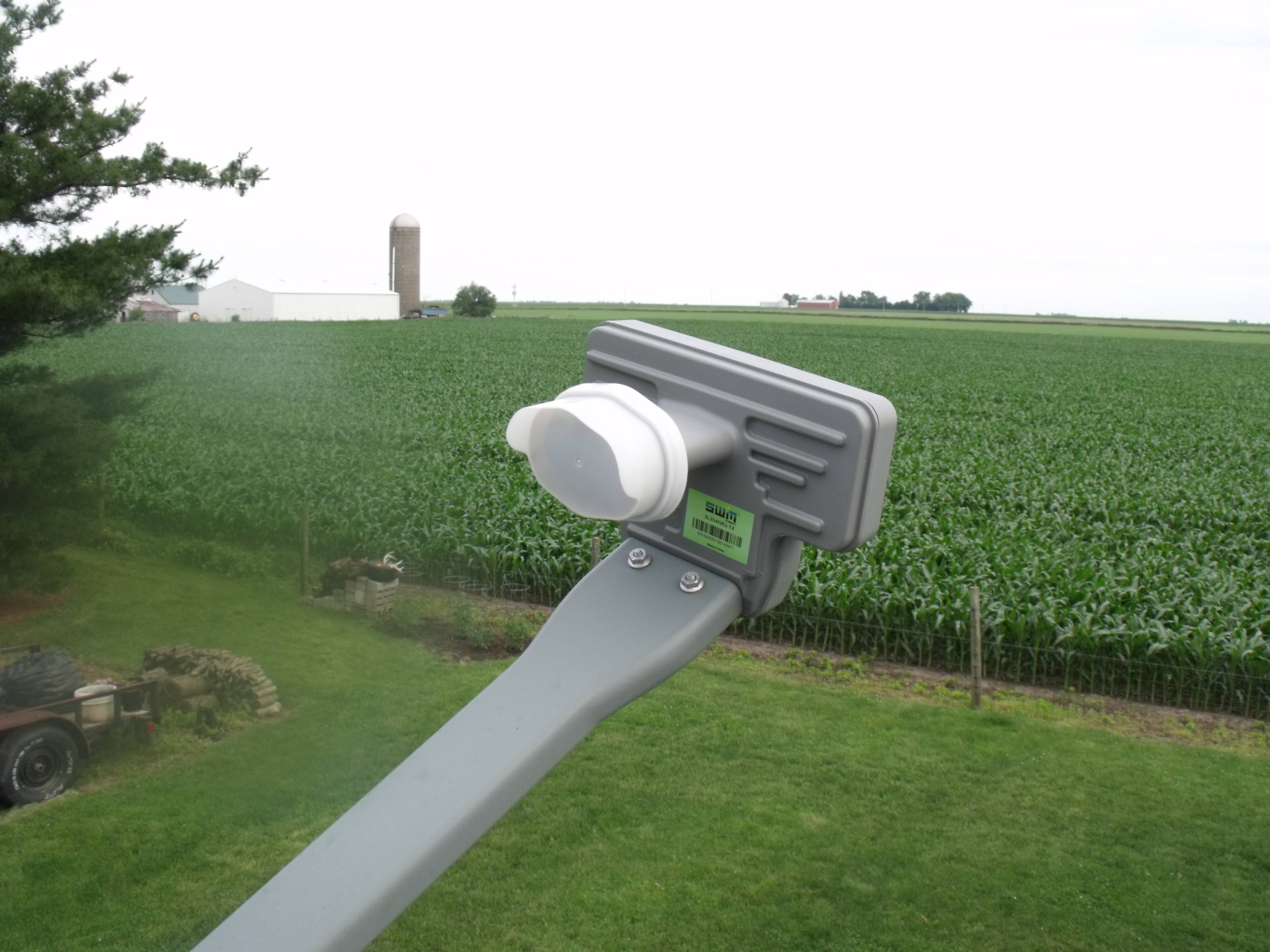

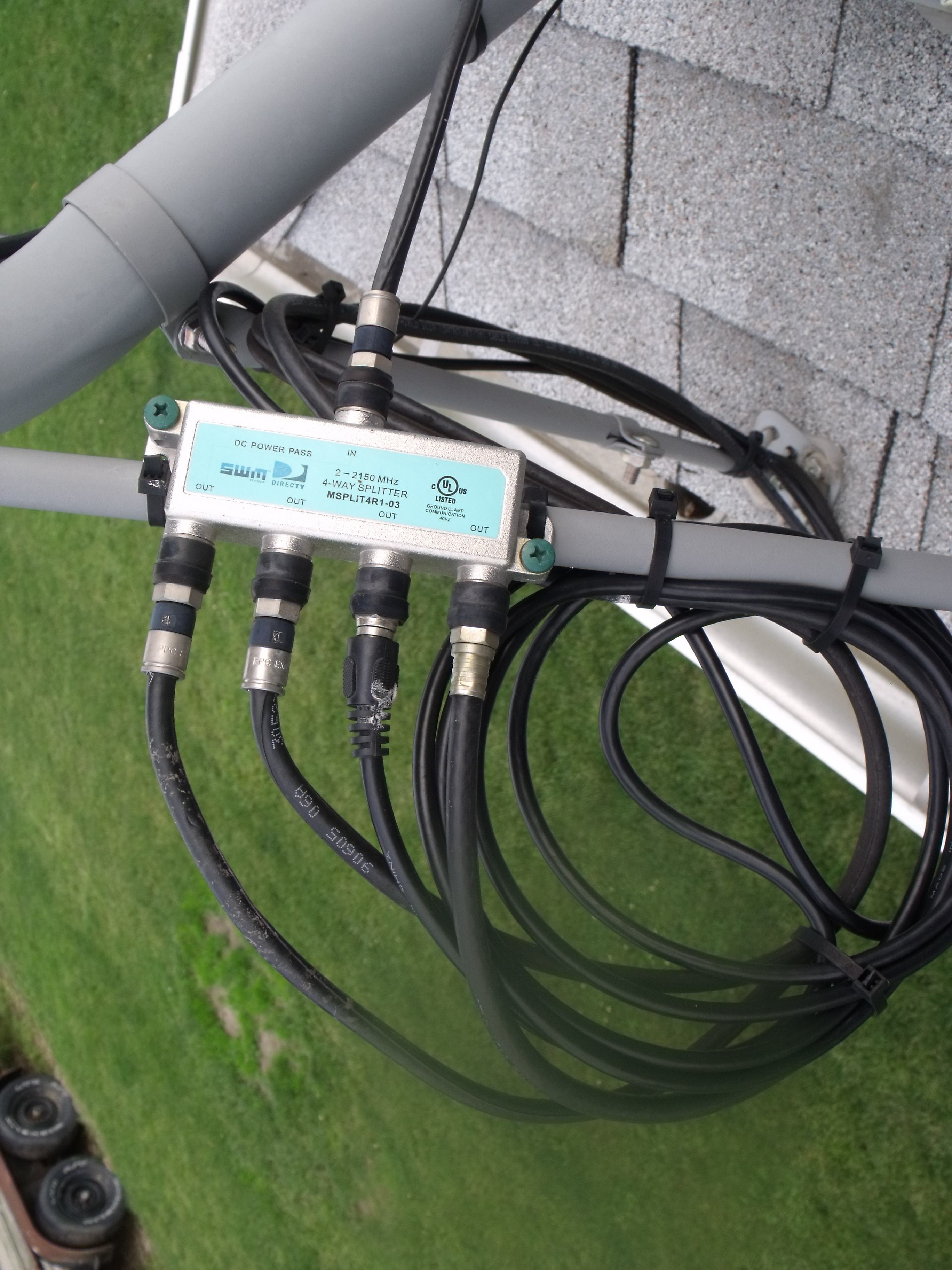

Ok, Here is basically the setup my buddy has @ the campground, But he has only 1 coax coming into the camper which we had hooked up with a b-band last summer to tuner 1 on his dvr and it worked fine. Now no go.
You only need the power inserter & one cable to hook to your HR24 & you'll have access to both tuners. You don't need the B-Band Converter & you really don't need the splitter either. If you have long enough cable you can just run that into the camper through the power inserter to the Hr24.
Reactions: kfxx400
Or you can still use the Splitter & run 2 cables into your camper. The power passing output(red line) of the splitter can be run to your power inserter with a terminator placed on the other end of it(the output to the receiver part). Then you can use another output from the splitter to run to your HR24(without the B-Band Converter),& you can/should terminate the unused other 2 outputs of the splitter.
