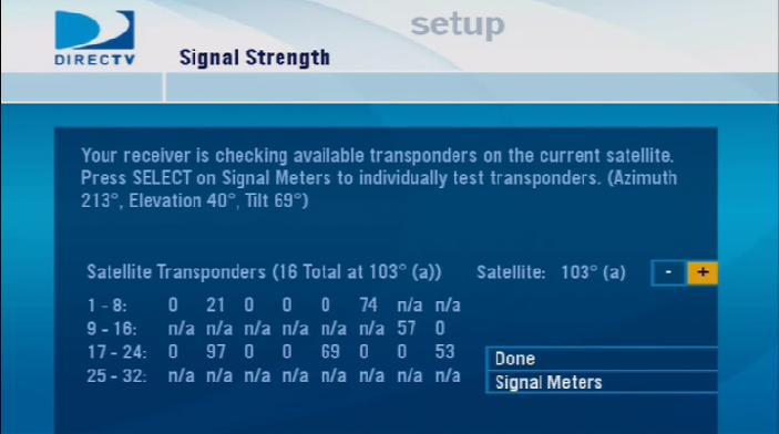

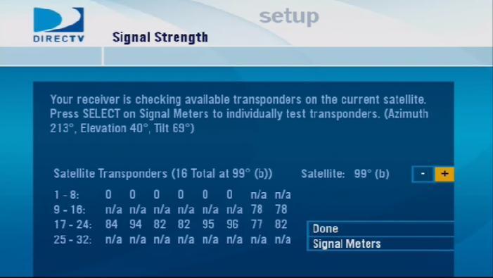

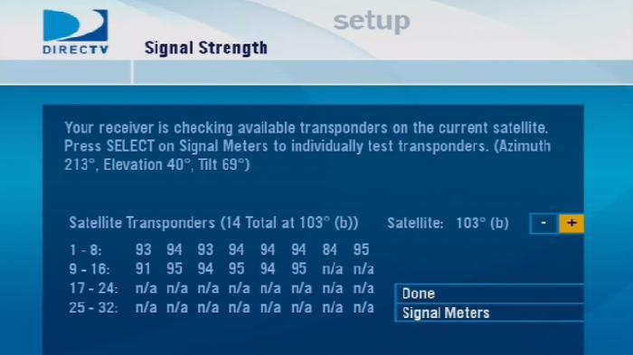

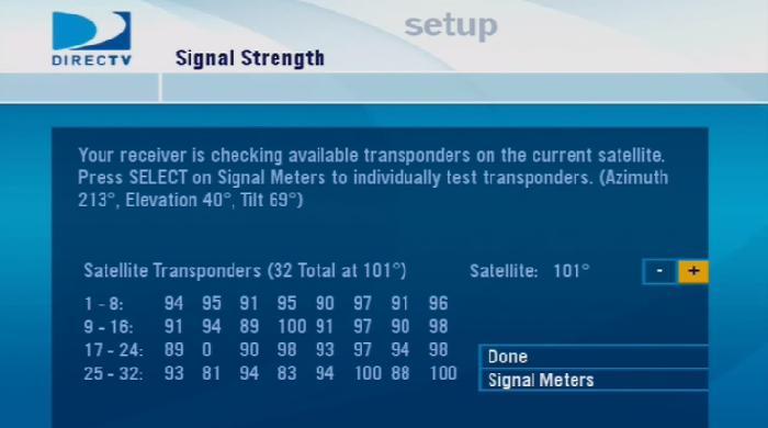

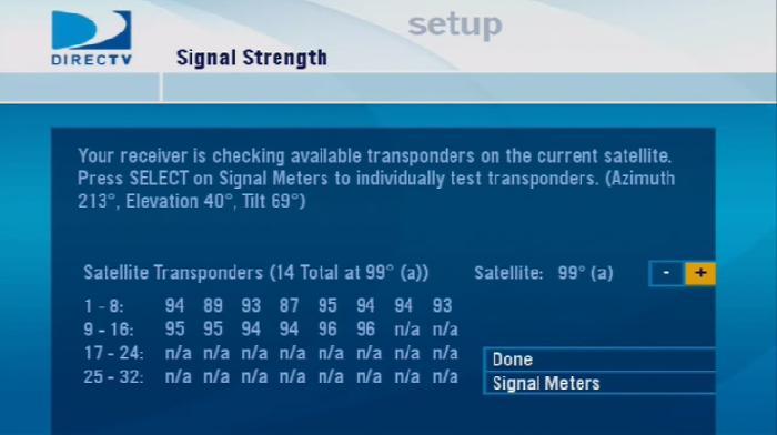

There are many people here that have done their own tuning just using their receivers. The HD dish needs just a little more fine tuning than the older dishes. If you would like to see what type of numbers you should be getting in your area let me know.
Here is a good example of what you should be seeing on your signal strength.

Thanks for the signal strength screen caps my dish definitely needs to be adjusted. I had been looking for what good signal strength should be for several weeks unsuccessfully.
Don't forget that many of them will be dependent on the area. The ones that I posted are what the Central Ohio signal strengths should look like. If you are in a different part of the country you may get signal from transponders that I show a 0 for and vise versa.
If by Central Ohio you mean the area that gets WBNS for CBS my signal strength should be very close to the numbers you posted even though I'm roughly 30 miles below that DMA. That is the DMA I moved to otherwise locals would be from another state and no HD locals.
Maybe. It all depends on how large the spot beam for the local HD channels are. You may have a few that are a little lower than the readings posted.
